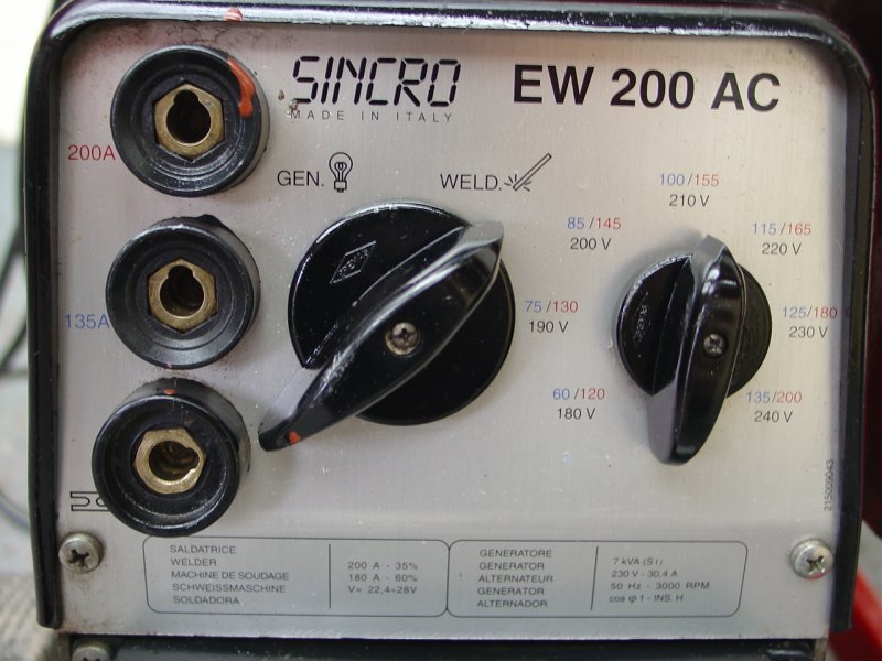

Too high IMO for 1.2mm steel. That would be running hot even for a 16 gauge rod (1.6mm?) and these days with my eyesight I wouldn't like to chance fillet welds with rods that small.So minimum arc setting is 60 amps plugged into the middle dinse socket.
Earth clamp at the bottom.
Don't think 1.2mm steel is an option.
