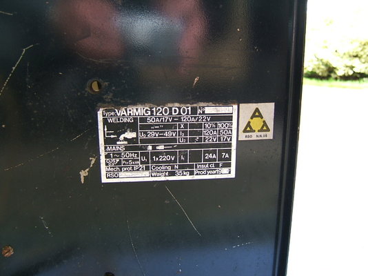

My trusty MIG welder, which is 24 years old has developed a problem (reported on here before). For those who have never heard of the VARMIG range they are still made in Slovenia (although it was Yugoslavia when mine was made!), by Varstroj (http://www.varstroj.si/).

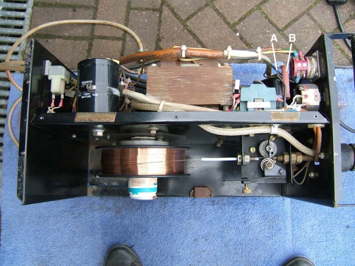

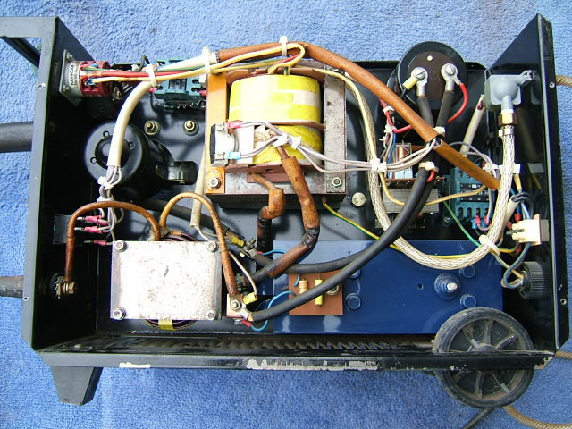

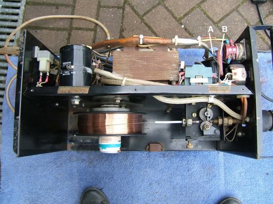

The fault that has occurred is that the feed wire now remains live when the trigger is released. I have been considering whether now was time to invest in a new one, but after reading the comments here on modern day machines and looking at the internals of mine in comparison to the SIP 130 shown on this site, I am having second thoughts. I have attached photos of the internals of the welder and I am interested in your comments.
Also, following some investigation, I think I may have tracked down what is causing the problem. When I removed the cover today, I noticed that the wire marked A in the top view photo had come detached from the resistor type thing, marked B. I have soldered this back on and tried some test welds, all was OK initially, but after a dozen or so short welds the old problem occurred and I discovered that this resistor (if that is what it is) had overheated.
MY questions are:
What is this part and can it sourced today?
Is it likely to be the cause or just a symptom of something else?
Do you think I'm wasting my time trying to get it repaired? (despite it age it is only in the last 3 years that is has had any major use, as I restore my MGA).
