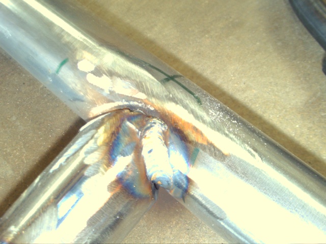

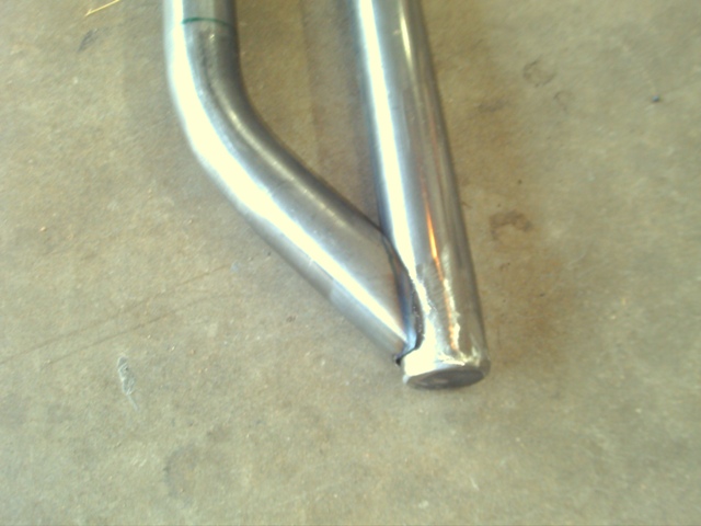

I agree with Alfaman, there can't be any space where the tubes meet. 95% of my welding and fabricating is using .120 x 1.5 mild steel tube. That is what i use for my off road truck projects. It is extremely important to do good prep work where the tube will join, i.e. notch the joint so it will fit perfectly with the other tube. Get the welding area perfectly clean. Here is a sample of my prep work.
Thanks, this is the best pic that i have on my work computer, I currently have a Lincoln 125
