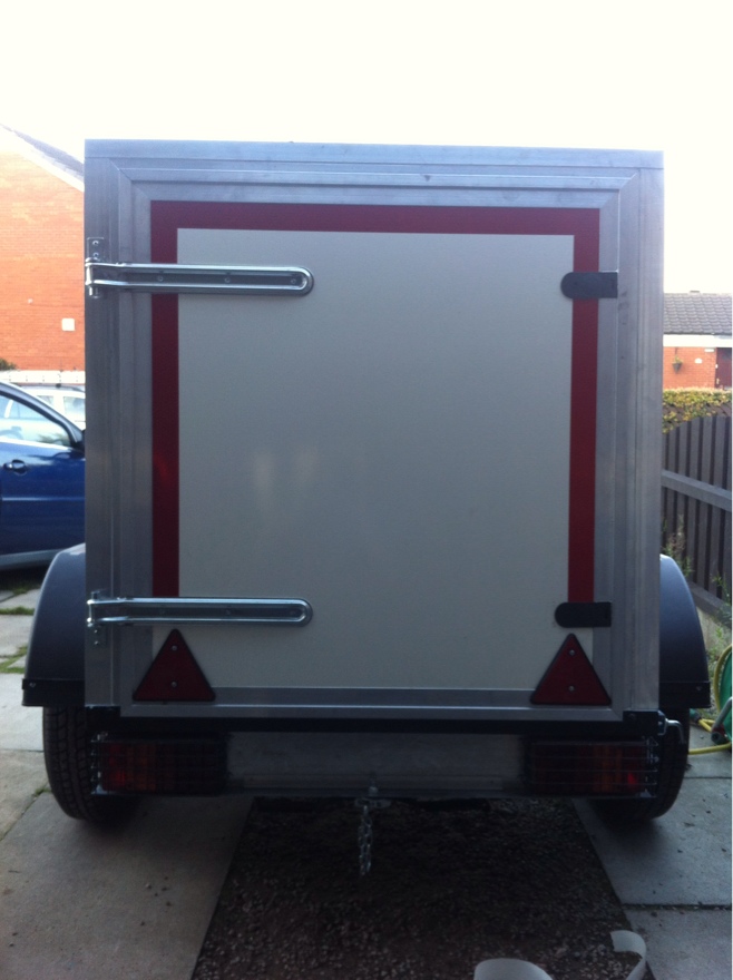

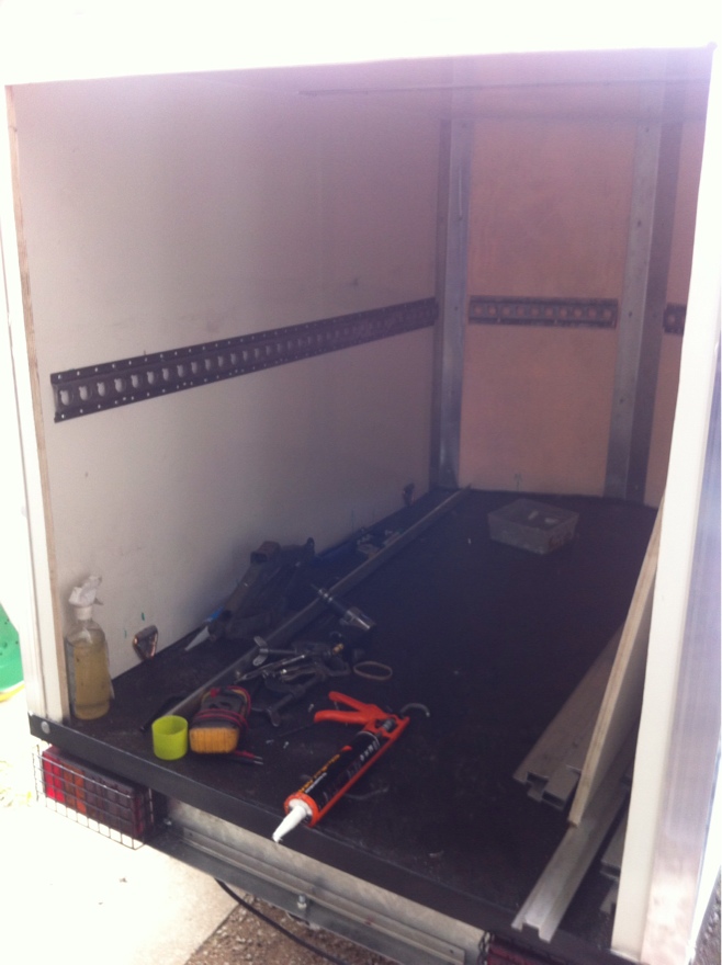

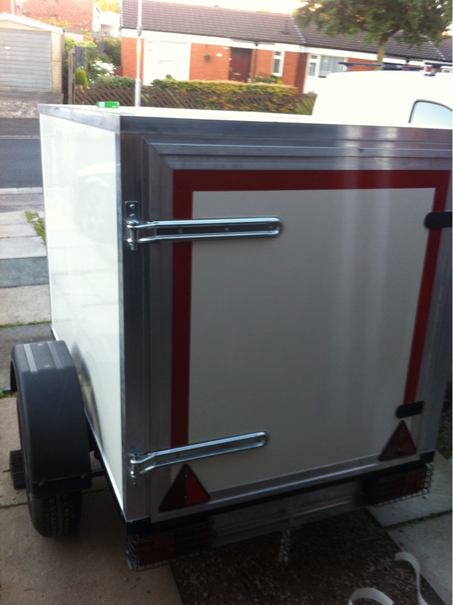

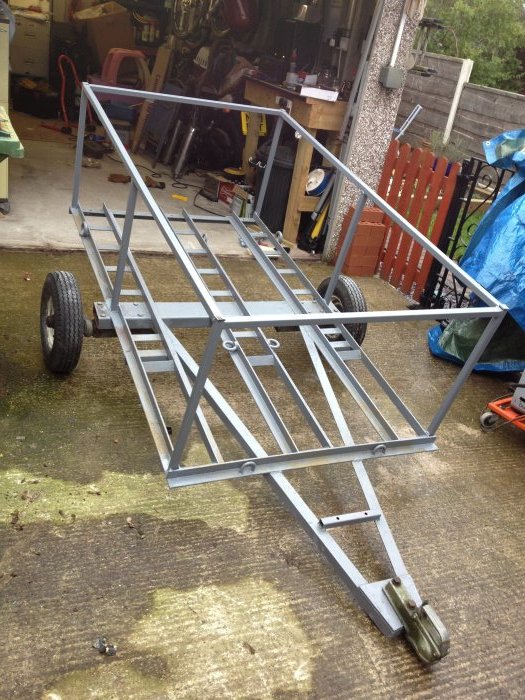

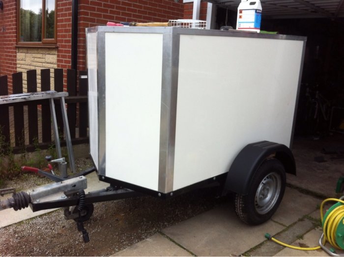

Hi Guys,
I'm currently re-building an old motorcycle trailer i bought off Ebay.. The Chassis is a 3 bike trailer, which had been converted into a box triler with ply base on the bike ramps and very high ply sides, all of which were very damp and rotten. I junked all the wood and began cleaning up the flaky chassis (only surface rust), but cleaned up ok with needle scaler, wire brush and grinder. Painted with a real heavy zinc paint it all came up ok.
It was a bit wide so i narrowed it 6" each side, cleaned up the indespension units, bought some old 4" PCD 12" Minilite wheels to raise the whole thing to a better angle for towing (level rather than nose high).
I got a load of free 25mm X 25mm box and welded the main structure, will be using thin sheets of GRP for the sides and Phenolic ply for the base.
My question is what is the best and cheapest type of angle to trim all the edges in? I would like to use aluminium and rivet it all down, however 25x25 ally angle is very expensive. Any other ideas gents?
Thanks in advance.
