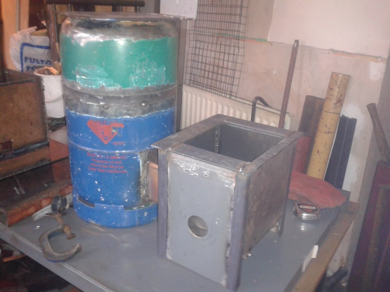

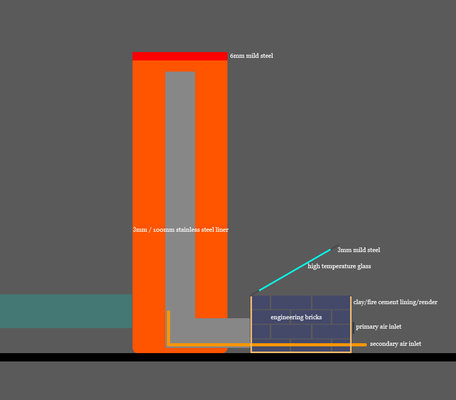

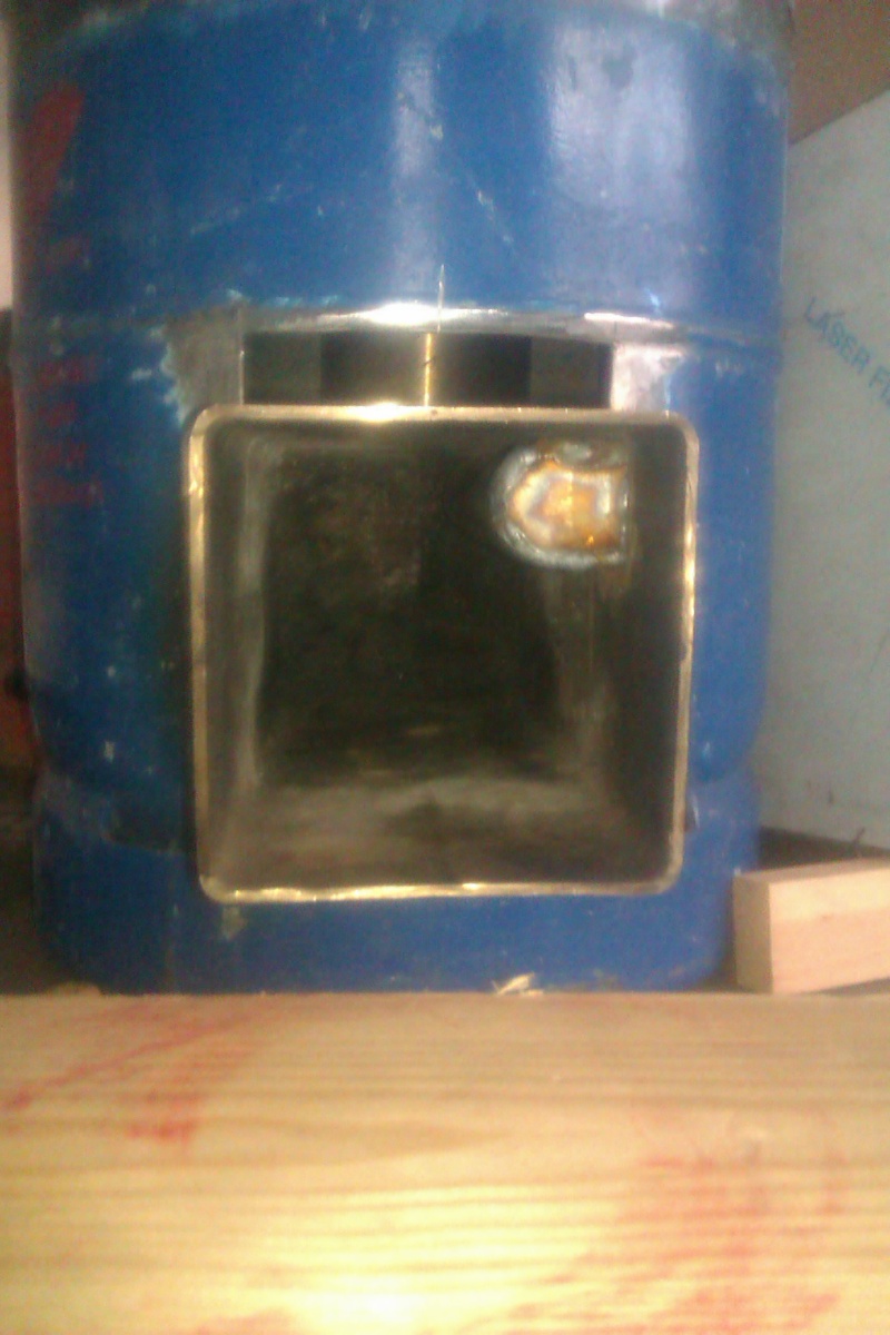

Newbie welder, going to give this a bash, abit practice untill i get a bigger bottle for the garage. Going to try make a mini burner, looking for some advice. Want to keep it simple as possible, but always want it to work properly.
removed the valve, flushed with water, its been sitting for 2 days now with water/washing up liquid. ready for next step..
