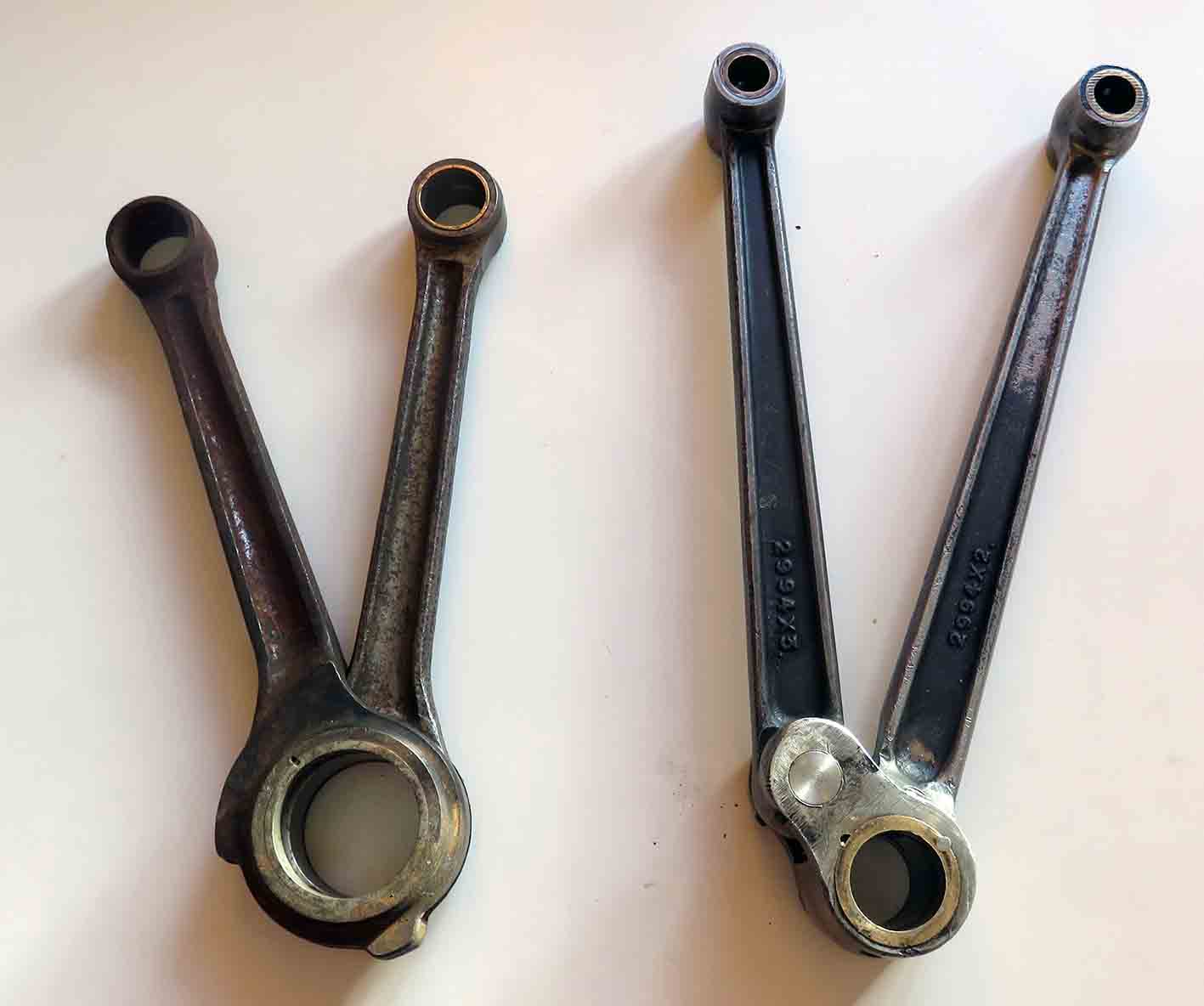

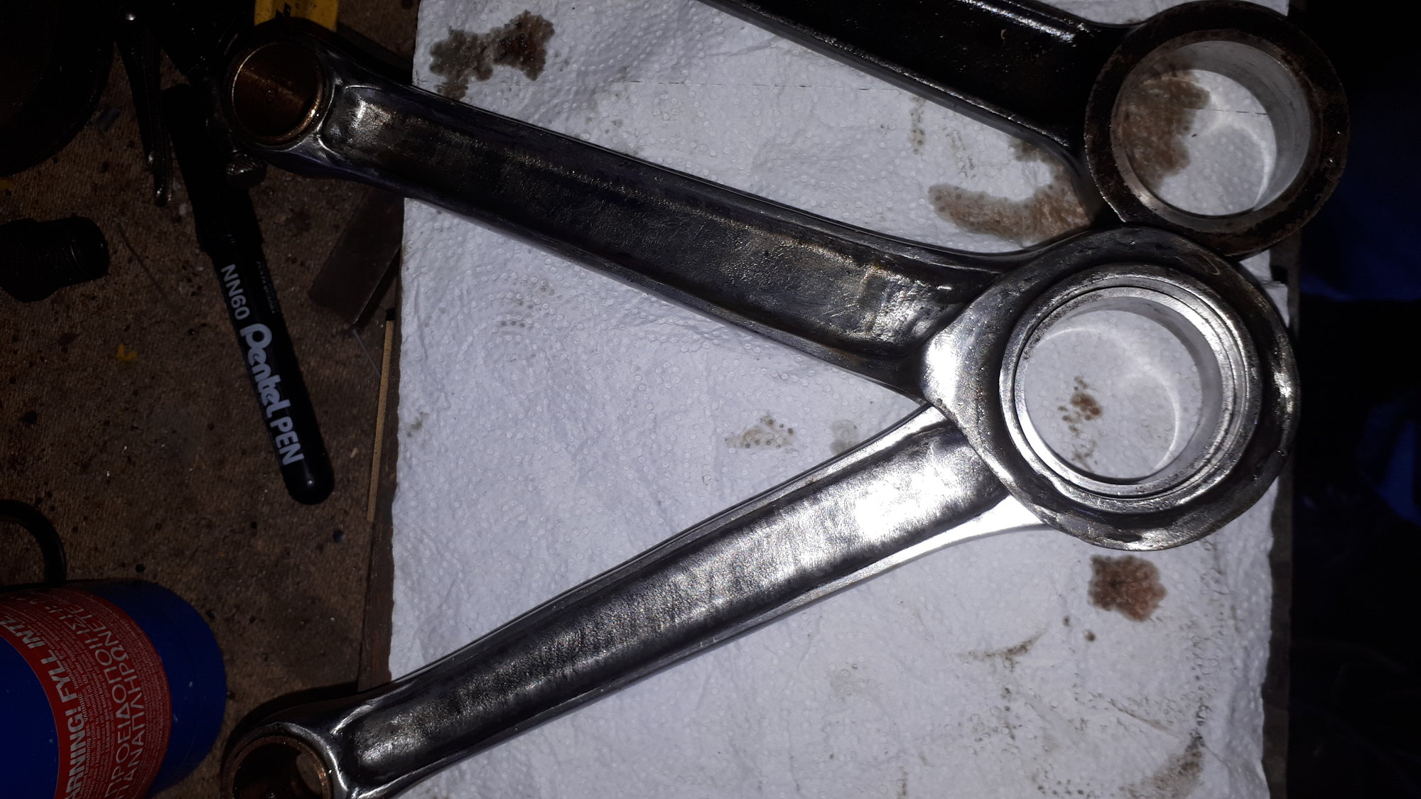

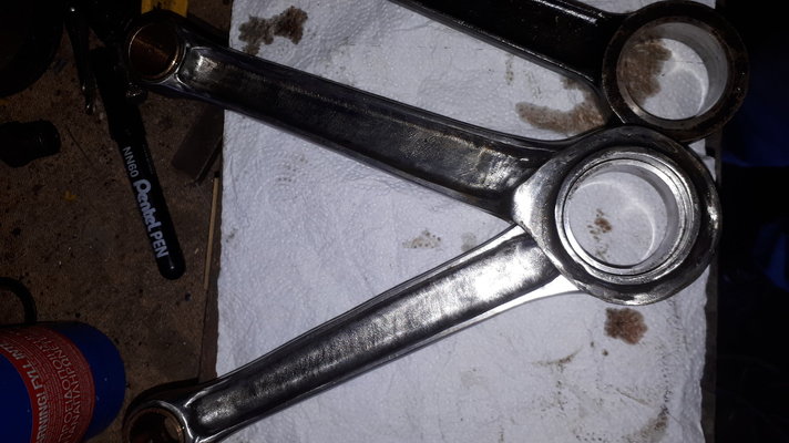

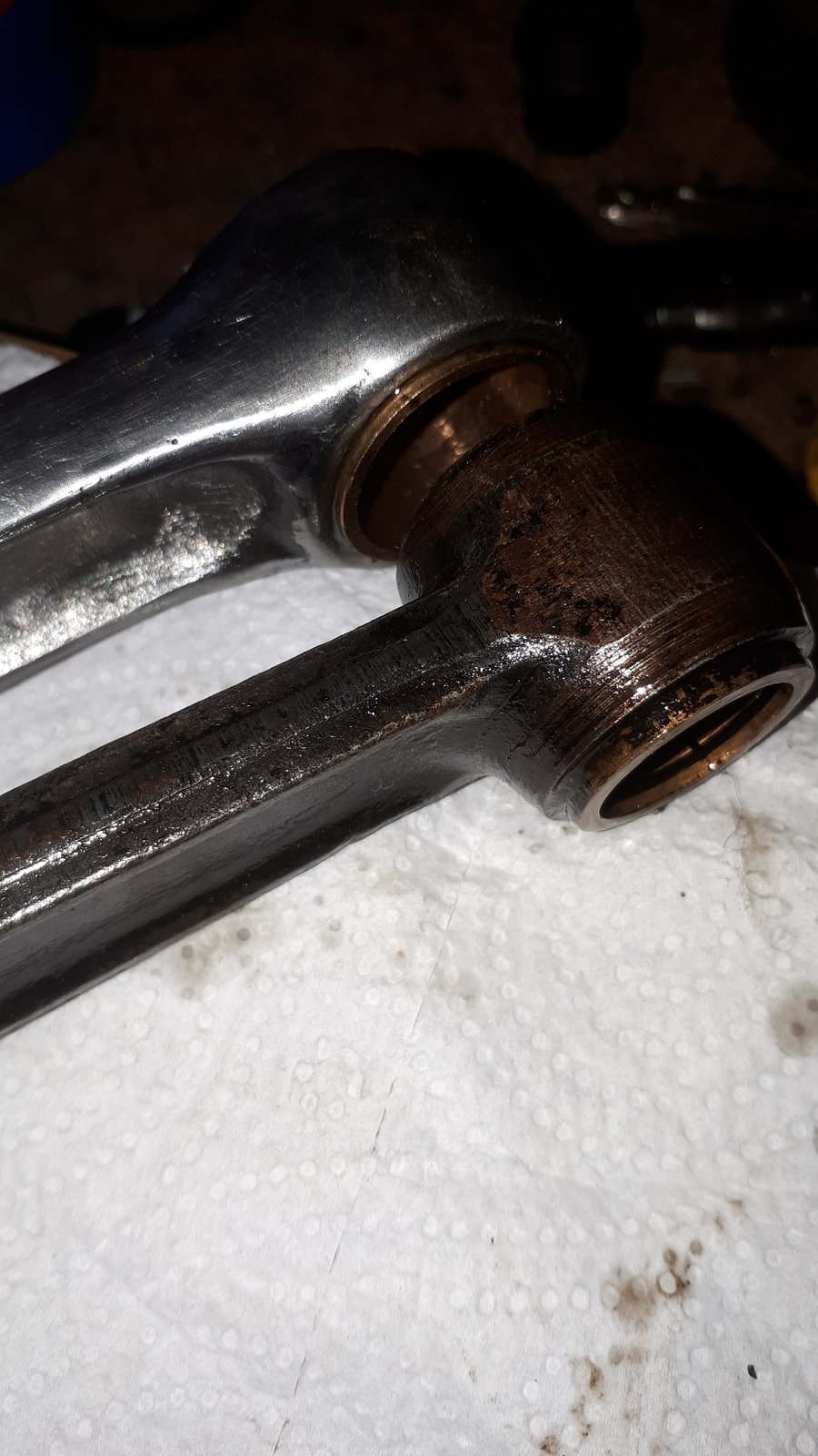

I have obtained two sets of World War 2 ‘old stock’ V-twin conrods for a 45 Harley Davidson engine. Below is a photo of both the Humber and Harley Davidson conrods.
The Harley Davidson (left) Humber (right)

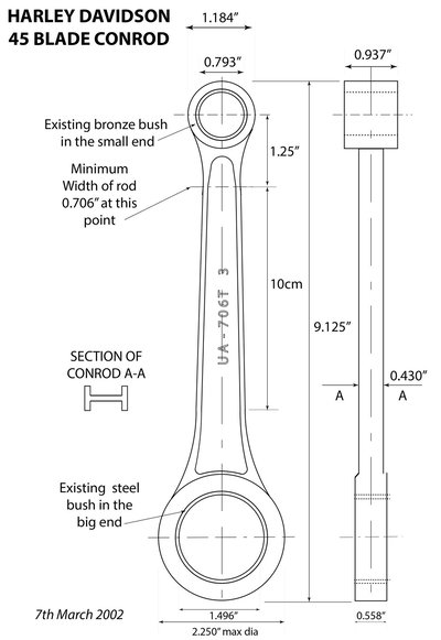

Now here comes the problem. The Harley conrods are around 7.5” between centres and the Humber conrods are around 9.5” between centres. Therefore, I need to increase the rod length by approximately 2”. I think I have two options.

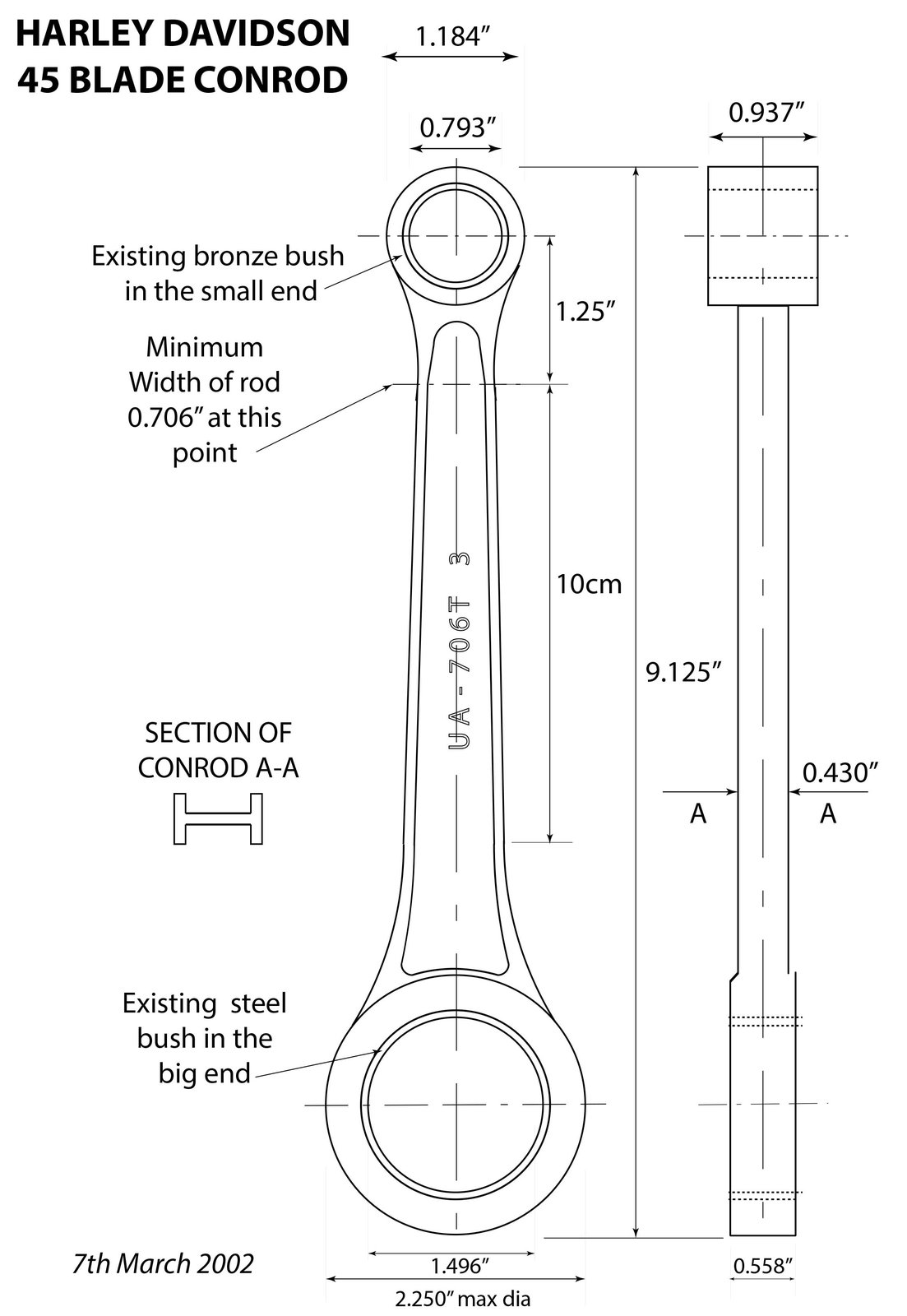

I can cut a section out of one set of rods Harley rods and weld it into the other set of Harley rods. Or, my preferred option would be to machine up a section of steel to match the section of the Harley conrod in my Bridgeport milling machine and MIG weld them into the cut rods. The rods would be cut at a diagonal of 45 degrees to increase the weld length and I would make a sturdy jig to hold the parts in place. Below is a drawing of the 'blade' Harley Davidson conrod I want to extend, the forked conrod is similar, but I have not drawn that one out yet.

My question is if I buy ‘new steel’ to make the section that I would like to weld in, what specification of steel would be best for welding to the old Harley Davidson conrod material and does anybody have any tips that may help with the welding? Another question - does anybody know what material Harley Davidson would have used for the conrods during the WW2, or have a suggestion on who to ask?

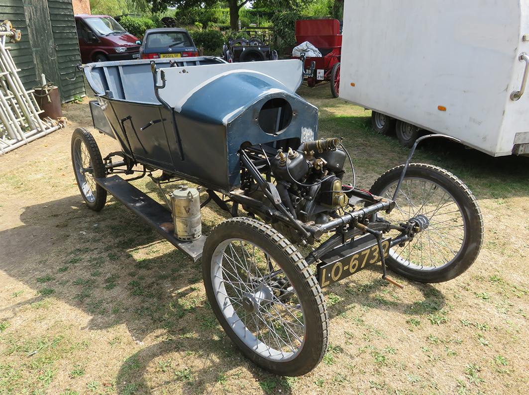

This is a photo of the Humberette, partly dismantled, showing its engine.
