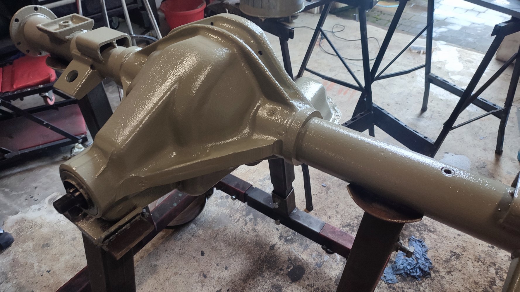

Evening all, I’ve been reading various threads and I am of a mechanical/electrical bias in vehicles. A personal project of mine is a bmw 1602 restoration with a touch of resto mod. Either way…
I am in the process of stripping the underside and addressing rust (so far mainly in one location and a replacement panel has been sought)
So I am left with an underside which is a mix of built up original underseal, given it’s a 49 year old vehicle I’m very impressed as when taken back to metal it’s like new!
To the bare metal areas what should I apply? I have read several threads and some are contradictory to others.
Zinc vs etch vs epoxy
Then my approach thereafter is to apply dinitrol 447 and a cavity wax as final stage.
Appreciate your advice, i know this has been covered but want to understand the best approach for my car.
