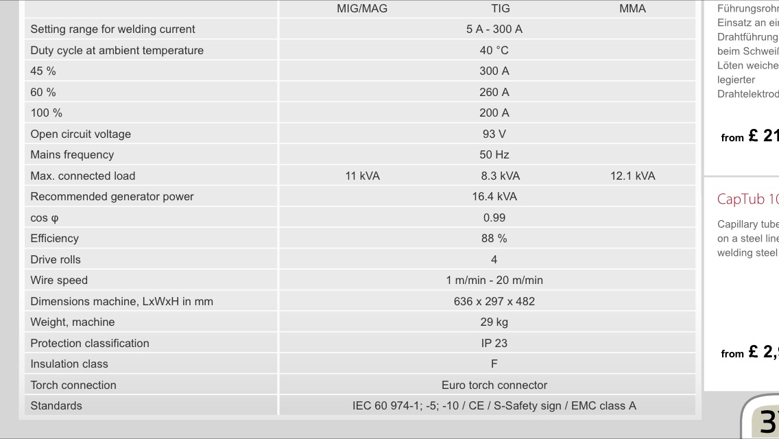

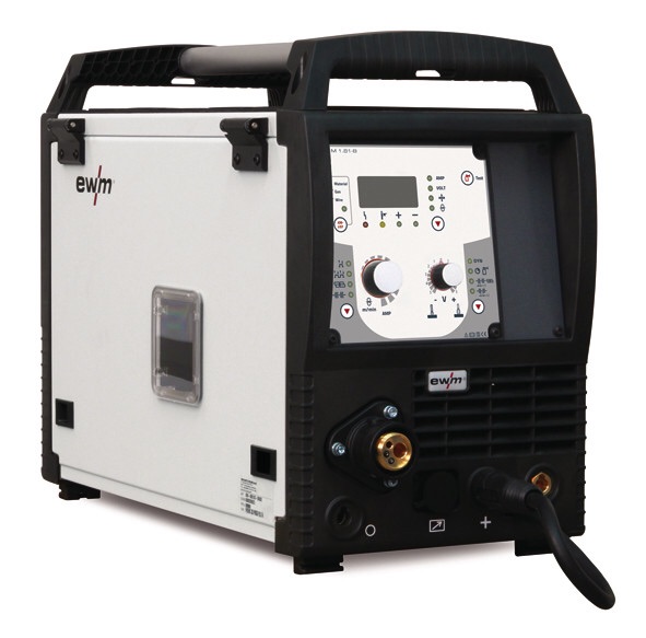

Forget what else it does, concentrate on any machines ability in the main mode it will be used in. It's a very capable MIG set, not much of a Tig really but it does have some handy Tig features like downslope and postflow. No HF though. Stick mode is nice too, but those are bonuses you get on almost any decent inverter Mig these days.
It's party piece is well resolved smooth synergic control on a range of materials the average fab shop is likely to use as well as a few you might not.
