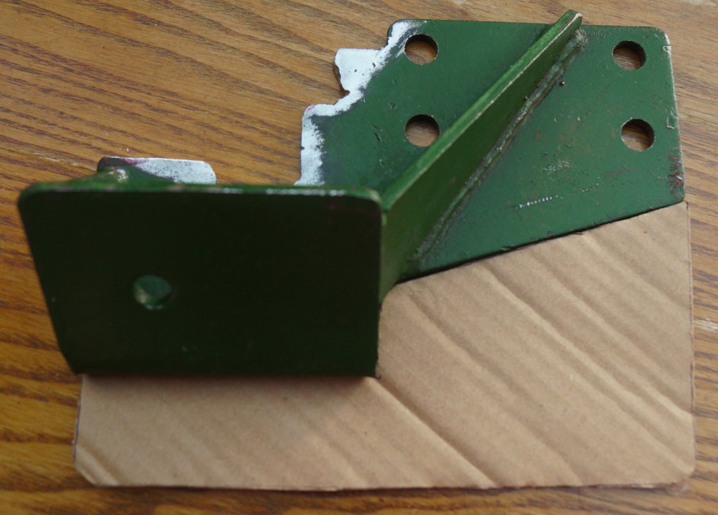

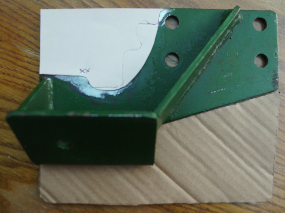

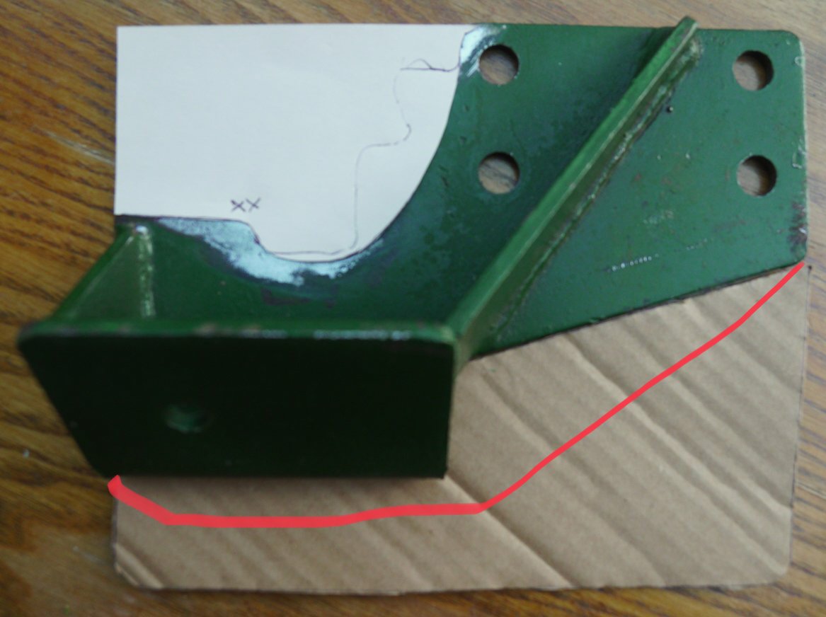

I have been adapting a transfer case/gearbox mount for a Landrover project. The left and right mounts are virtually identical except that they are handed, The left hand mount goes on fine but to make the right hand side mount fit I had to cut away some of the 4mm steel - attached photographs show before and after - I am planning on adding the steel shown by the card.
Any thoughts please - is it likely to still be strong enough - I could add a small gusset to the left of the mount supporting the part that rests on the rubber mount !
The mounts bolt to the transfercase then you have the gearbox - I am using a different gearbox which has created the problem.
