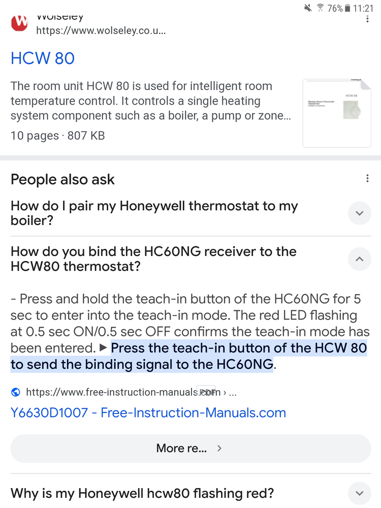

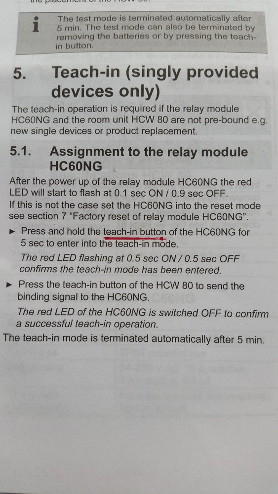

My C heating programmer works ok for the hot water but currently not for the heating. Apparently I need to syncronise (pair it) with the room thermostat. Also called 'binding'.
The instruction sheet says that the pairing is done by pressing the "TEACH IN" button. I cannot identify this button, so I am stuck. Can anyone help.
The HC60NG is the programmer.
The HCW80 is the room thermostat.
