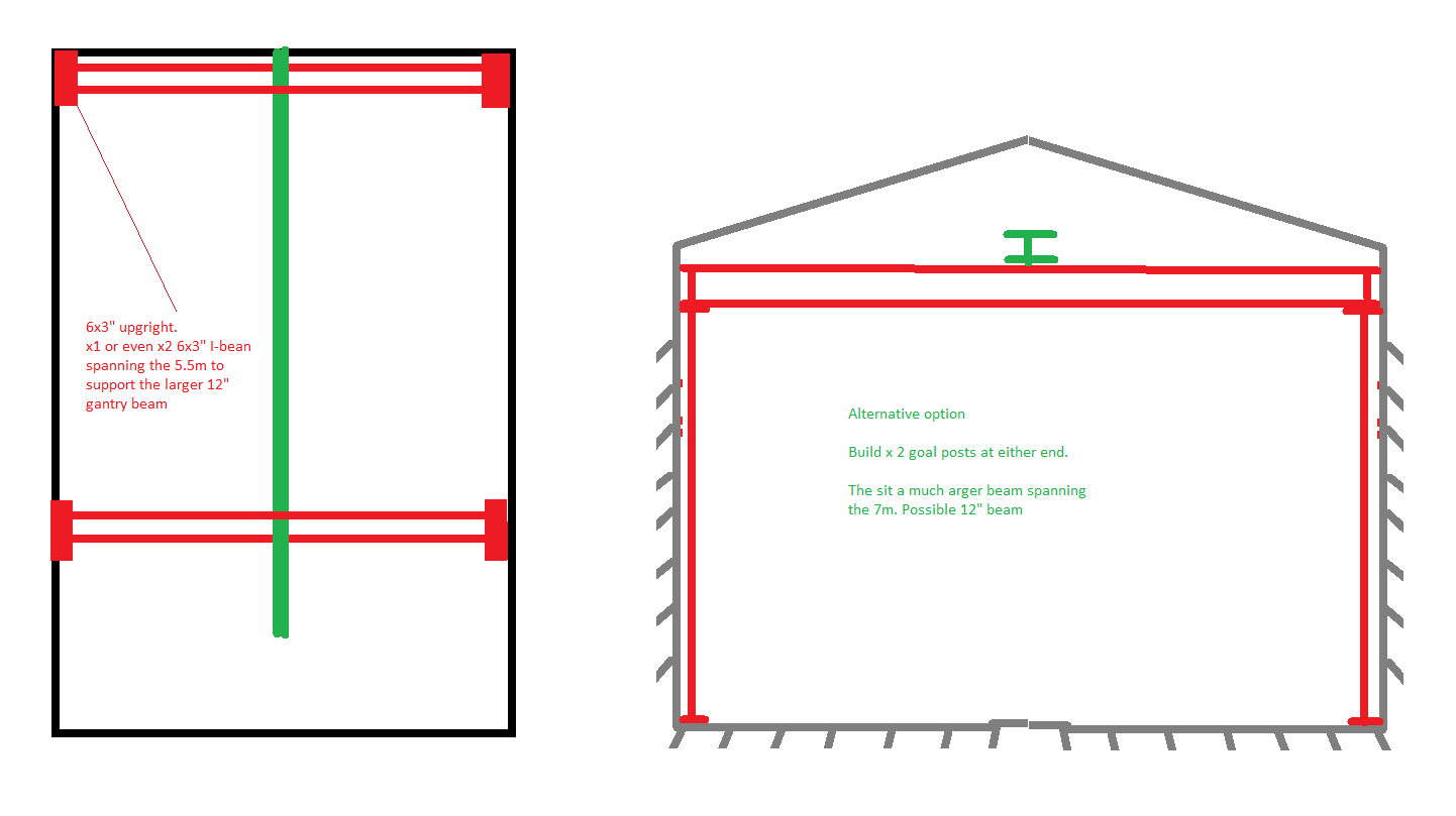

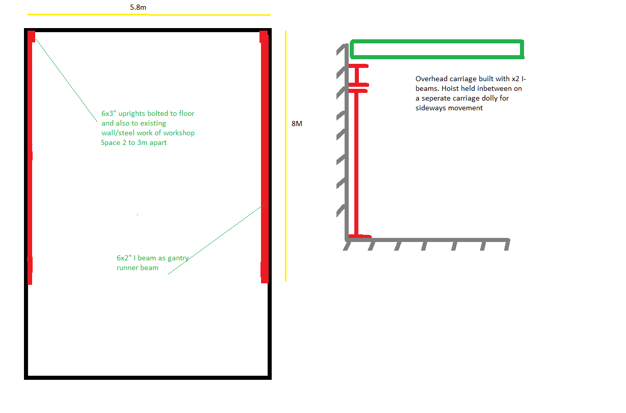

Good afternoon,
Been here a long time however life and work has left projects and workshop to the side.
Currently i have got my lathe, mill and workshop extension built.
What i would like to do now is erect a gantry crane in my workshop.
What i have is as follows:
- 10x6m workshop,
- large number of excess 6x3" I beams.
Plan:
- Erect I-Beam uprights about 2-3m apart on each side of the walls. Its a steel frame workshop so I can also tie this into the overall structure for extra support.
- use x2 I-beams joined together to span the 6m width (maybe 5.5m when remove wall width) gantry.
- Max weight would be my Colchester student lathe. however I would like make sure its capable of more but de rate it
- Uprights will have plates/webs welded in-between flanges to reduce any twisting.
Concerns
- Would x2 6x3" joined be too small for the span.
- Could I stretch the span to 3m between beams
Option 2.
- x2 6x3" goal posts at each end.
- Then span the 7m with a 12" bean to act as main gantry beam
