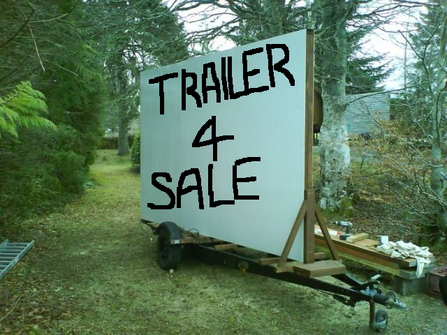

This trailer is for a friend, he has relitives with fields
I started the project at the weekend
I bought this old ALKO caravan chassis off a mate
The plan is a twin sided ad trailer with 12x8 faces (to use standard size 8x4 boards)

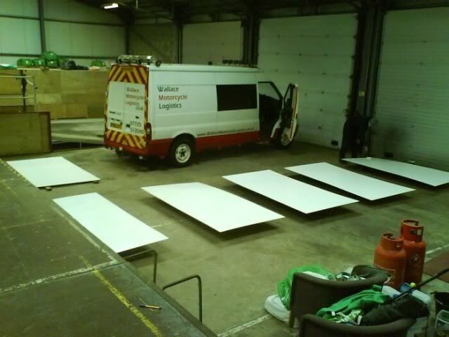

I bought the wood on saturday morning, here I'm painting the sheets of 6mm ply in my brothers work:

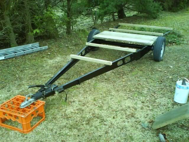

And then I cut and drilled holes for the cross pieces on the chassis. Mainly 2x2 but I had some offcuts of scaffold board so I used 3 of them to make a strong "shelf" above the axle where you can pile up blocks to weigh it down. I will also have to make some mudguards to mount off these boards
The sides will start out at the rear corners of the chassis then come in and meet near the front.
I've now unbolted the wood from the chassis to give it a quick lick of black paint
