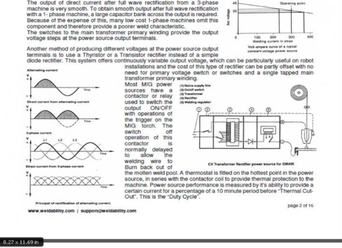

Evening all. I thinking of selling my 3ph esab for a single phase machine. But what I am wondering is, I does a 3ph machine give a better weld than a single ph?
I know that you can run much higher amps on a 3phase and it draws less current, andbut tthat's not really an email issue as I have 32amp outlets. Just thought it would be a good idea if I wanted to use it elsewhere other than where I have 3 phase of supply.
