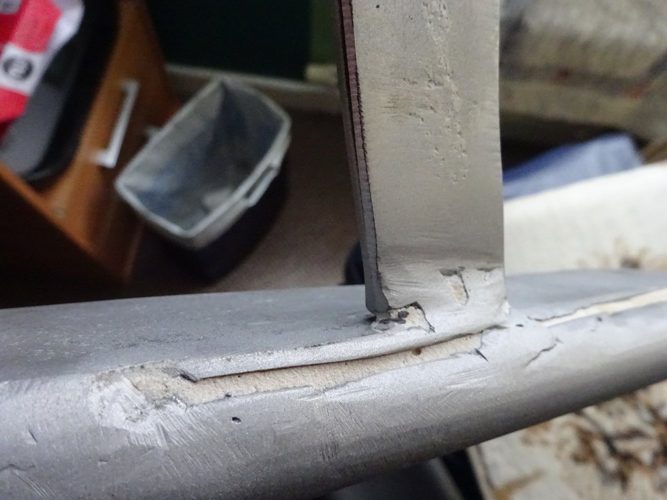

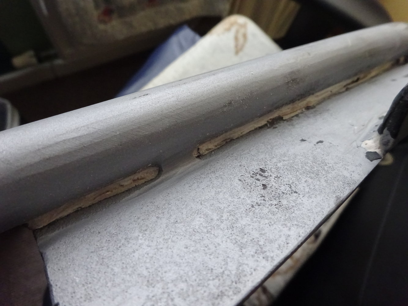

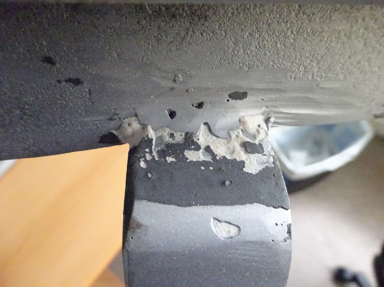

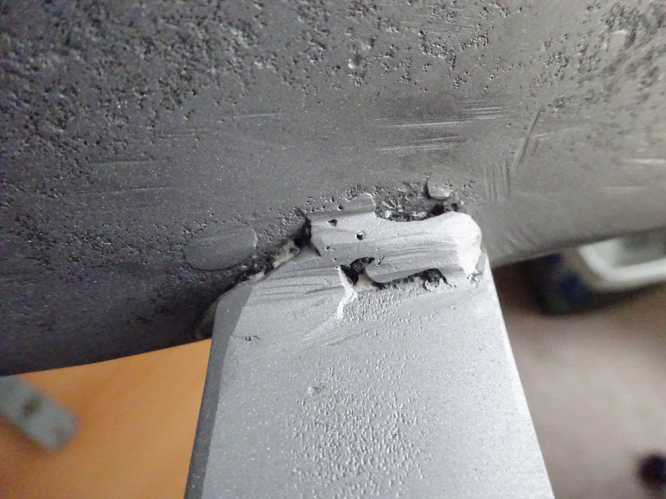

bought this off ebay a weeks ago and finally got round to stripping all the ugly paint off.
and found this,the welds er what weld??
shot blasted the whole lot and re-welded.
a copy of shad 3p frame which you cannot buy over here.
solid as a rock now. just shows you can't trust any body this days to be honest....
this is what he put on his advert.heavy duty.lol
