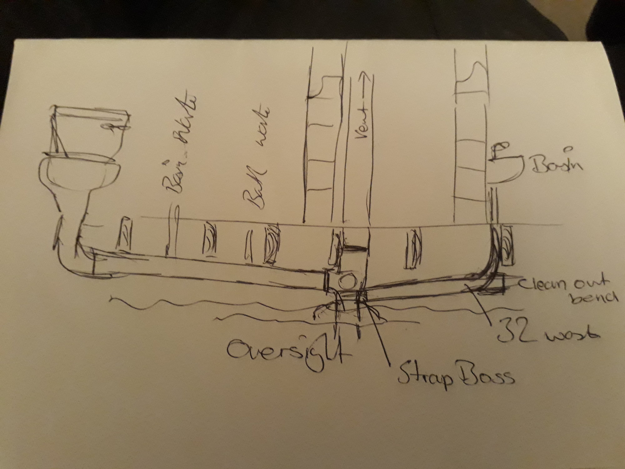

Its a bit tight under our shower room floor so the plumber fitted one of these gadgets under the tee and ran separate wastes, no gurgling or syphoning and very compact.
