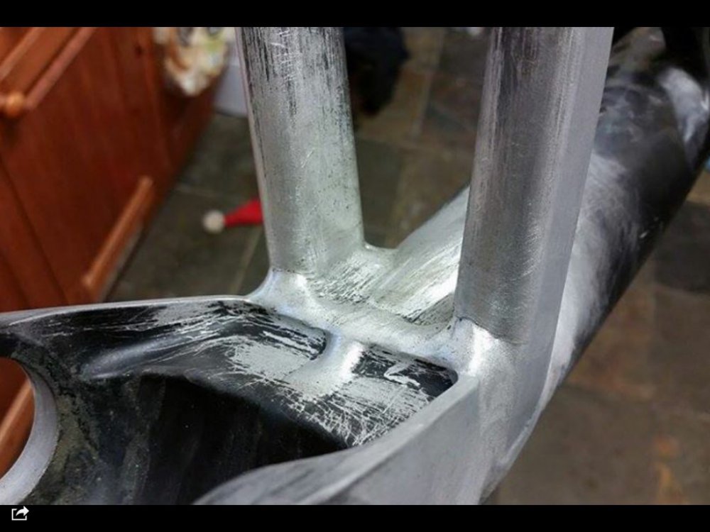

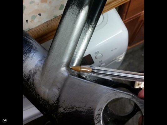

I have a mountain bike frame that has a crack in it (at the toe of the weld where the pen is pointing) which I'm going to weld up. Then Im going to add a gusset on each side to strengthen it a bit. The frame is 6061 T6 Ali, the gusset will be out of the same material and I will use 5356 filler, using a Lincoln V205t AC/DC inverter. I'll post picks when I'm done.
Just wondering if anyone can invisage any problems with this?
