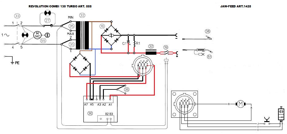

The Combi has a slightly different pcb to the other models, uses a two wire torch switch and the contactor switches the + torch feed unlike the others that switch the - return.

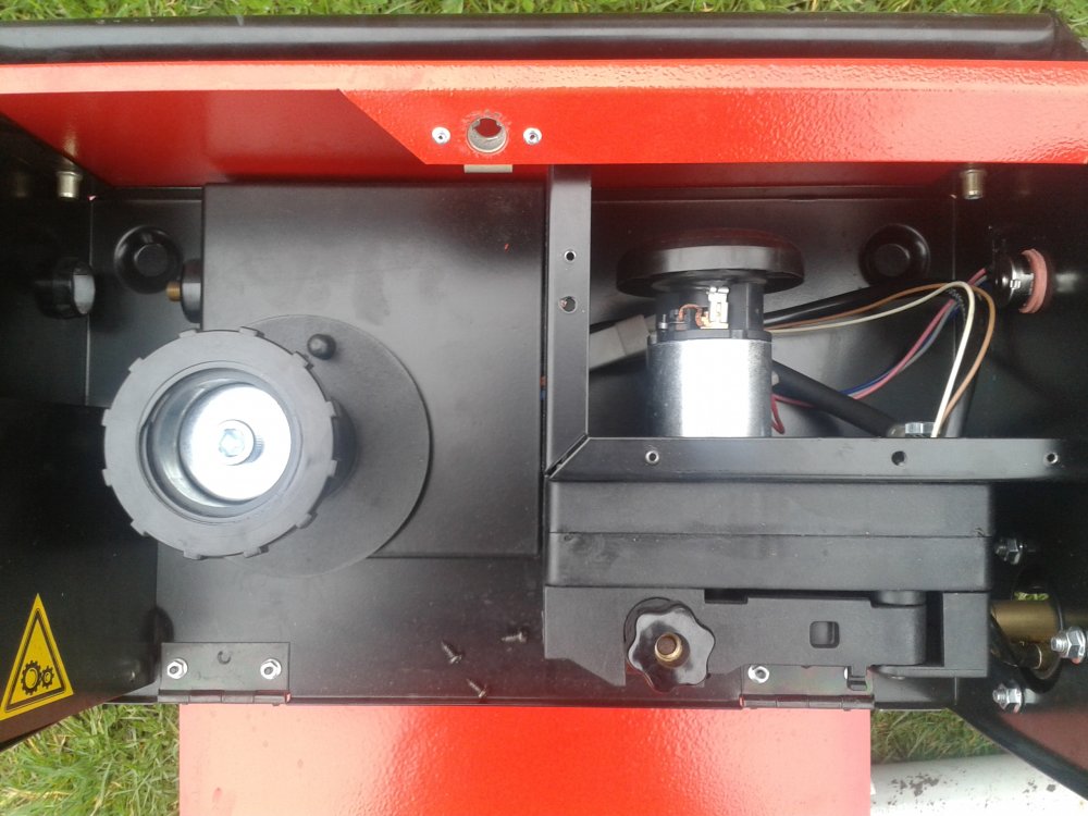

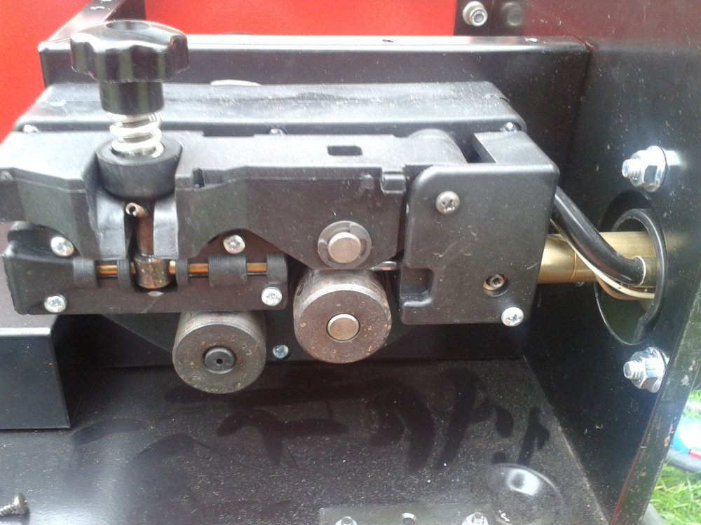

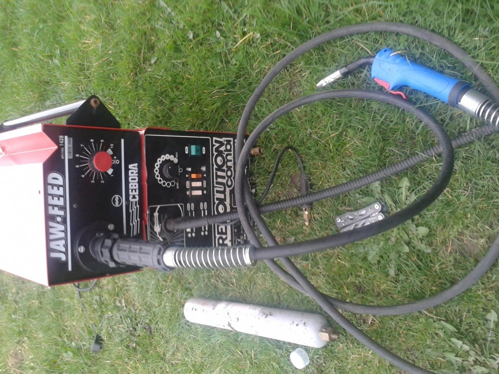

I was going to do a euro torch conversion and bought a Trafimet Ergoplus 4m MB15 type torch but whilst I was looking for a socket, spool holder and gas solenoid I managed to get a Cebora JawFeed (Art 1428) for a Jaguar 203 (Art 584) I got the torch and feeder for around the same cost as a universal euro torch conversion kit.
The wire feeder is the same width and depth as the Revolution Combi 130 Turbo so I've now removed the torch from the welder and I'm going to make up a trolley for them so the JawFeed will sit on top of the welder.
I'll fit a male dinse panel connector to the front of the wire feeder and a male to female cable from the feeder to the welder for welding current and a 6 core cable for wire feeder motor (24V DC), solenoid (24V DC) and torch trigger.
Hopefully the welder will be able to power the bigger wire feed motor.
The feeder has wire rollers for .6, .8/.9, 1 and 1.2 mm wire but my welder will only be able to use .6-.9 wire I'd have thought.
