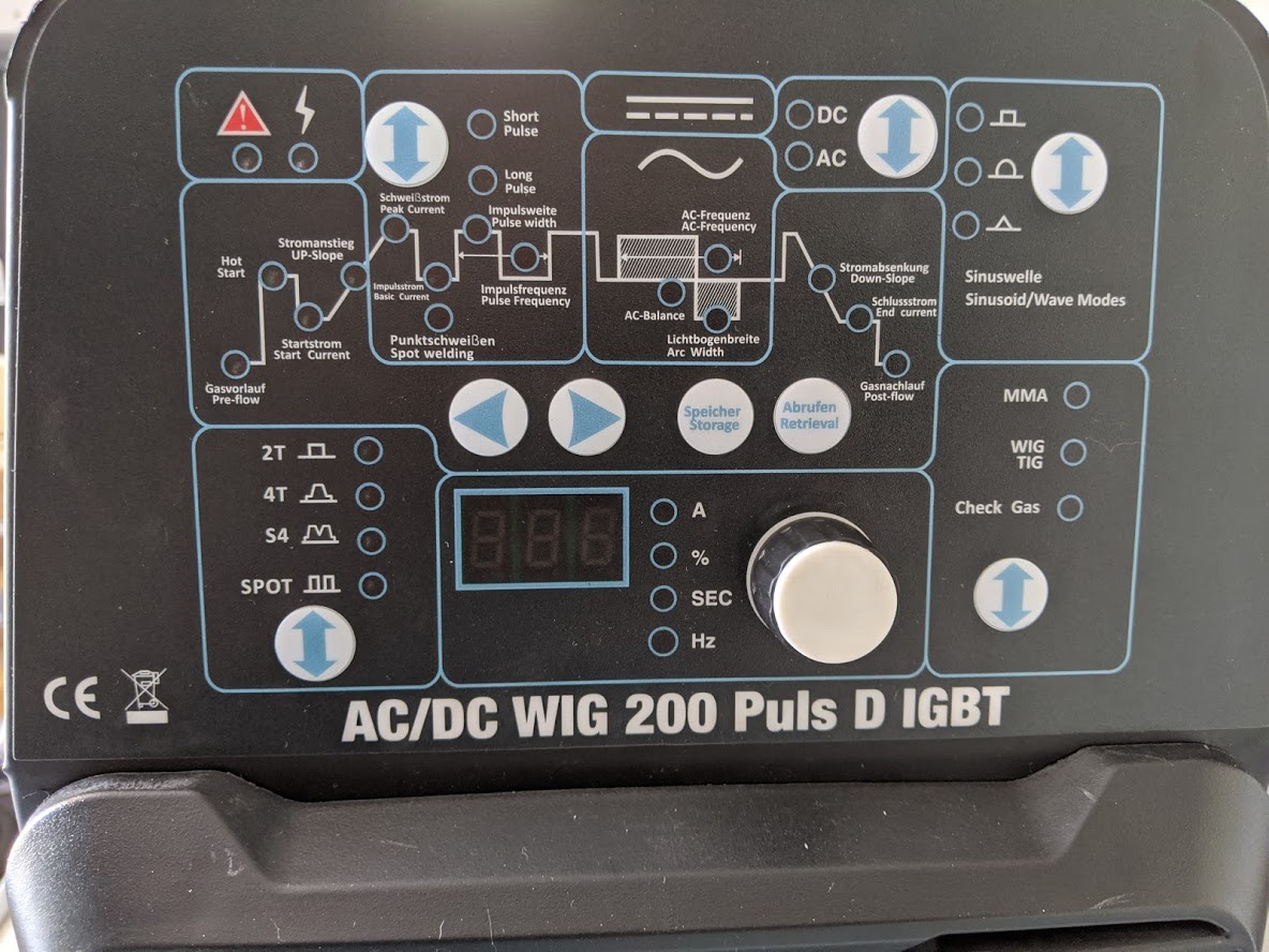

And a picture of the front panel :

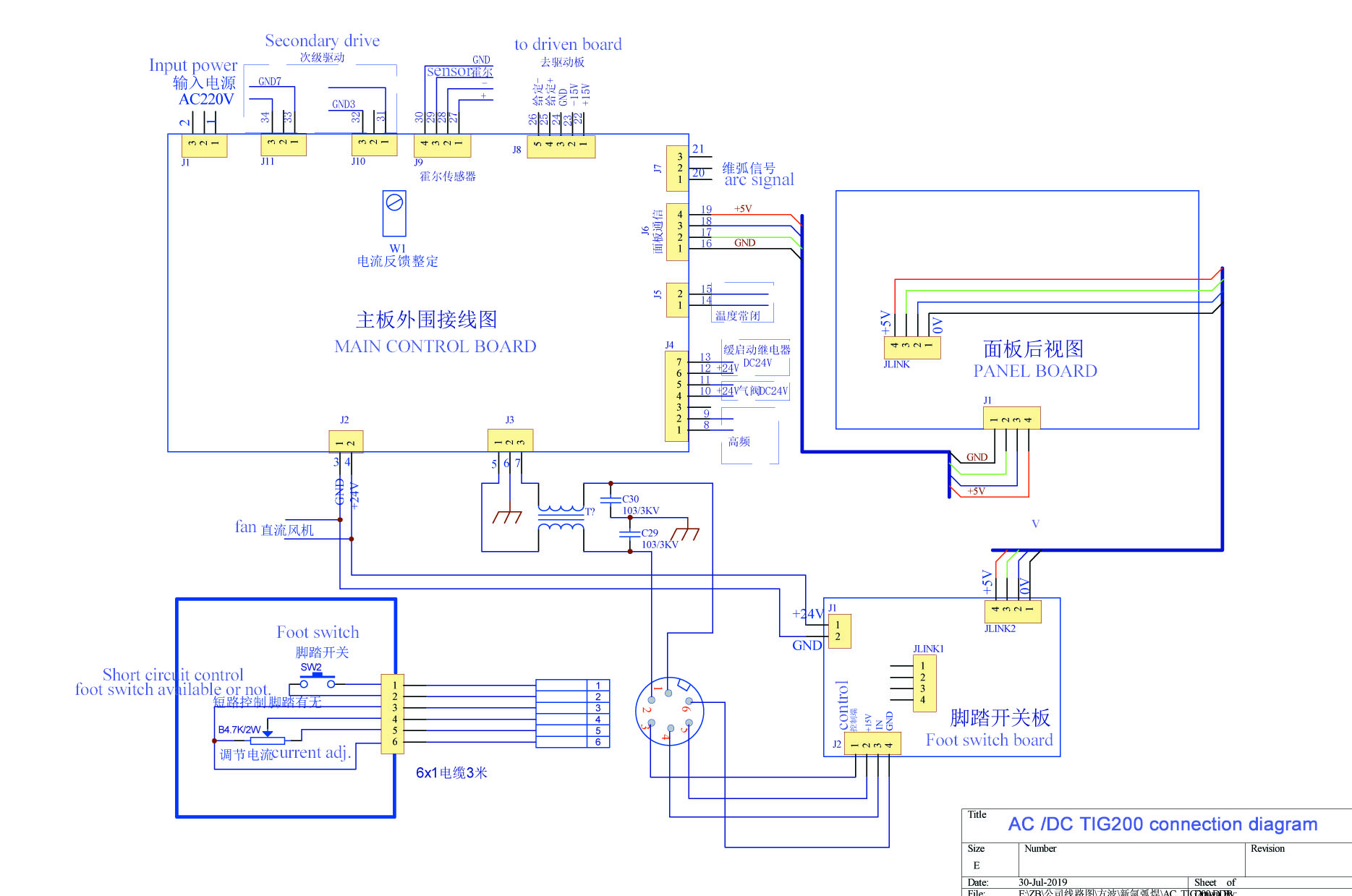

Using this, I found a seller on Aliexpress which are listing similar boards, he provided me this drawing :
So seems perfectly feasible, but should require an additional board ("foot switch board" on the drawing). The seller stopped answering me when I asked if he can supply it (that should mean "no"...), and I dont have any clue about where to buy this board.

- Any idea about the signal type between the foot switch board and the control panel (TTL, PWM, proprietary protocol ?) ? I guess that it's shall be rather simple, and probably feasible to do the same with a basic arduino. By difficult to figure it out without having a board in hand.
