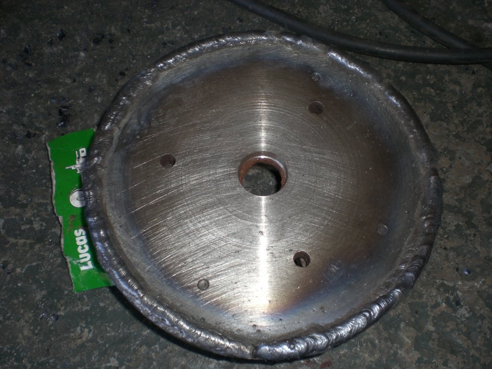

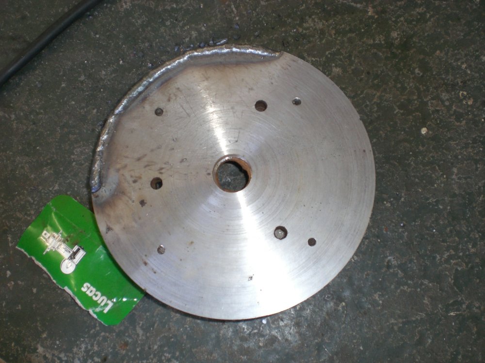

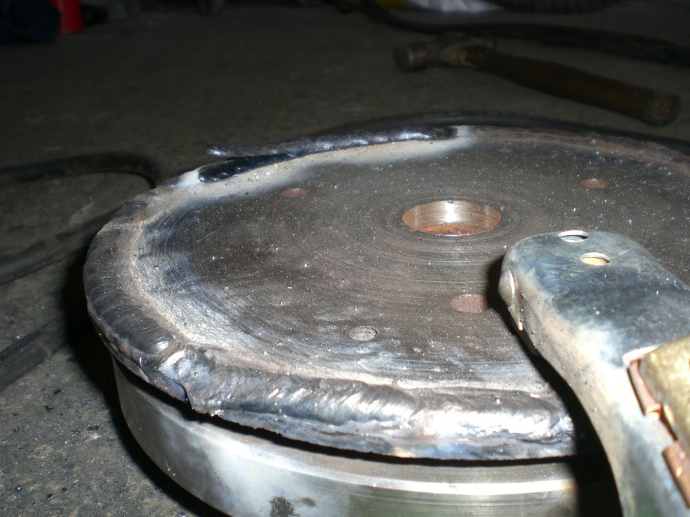

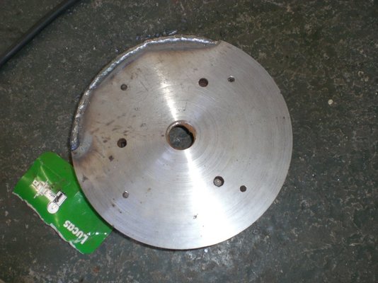

Nothing exciting, just a couple of photos of a plate I'm making for my lathe, dug out the worlds rustyest piece of steel and drilled and tapped to mount it on the harrison faceplate then faced it off, it could've been a bit thicker ideally as I wanted it to fit tight over the harrison faceplate. Built a ridge of weld up around the perhipery to achieve the lip, have not yet finished machining the lip.
Will post some more when I get more done.
