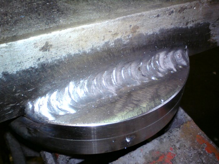

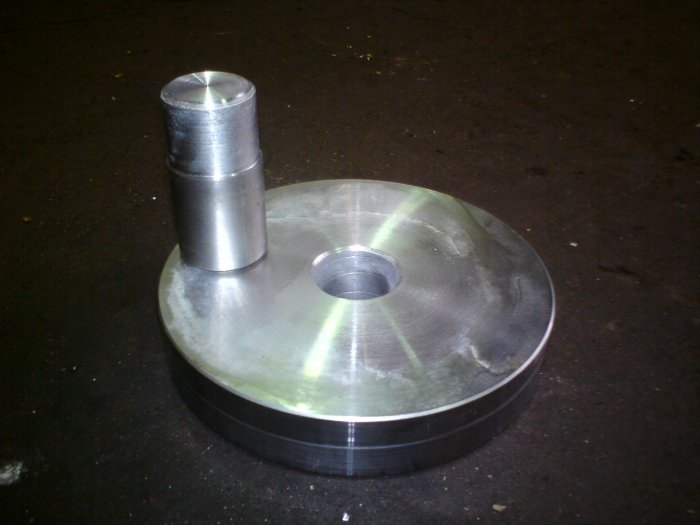

single plate 100mm x 100mm x 10mm roughly with a stub in the middle 30mm approx bar sticking out about 50mm so 60mm to go through the plate flush
reason ..

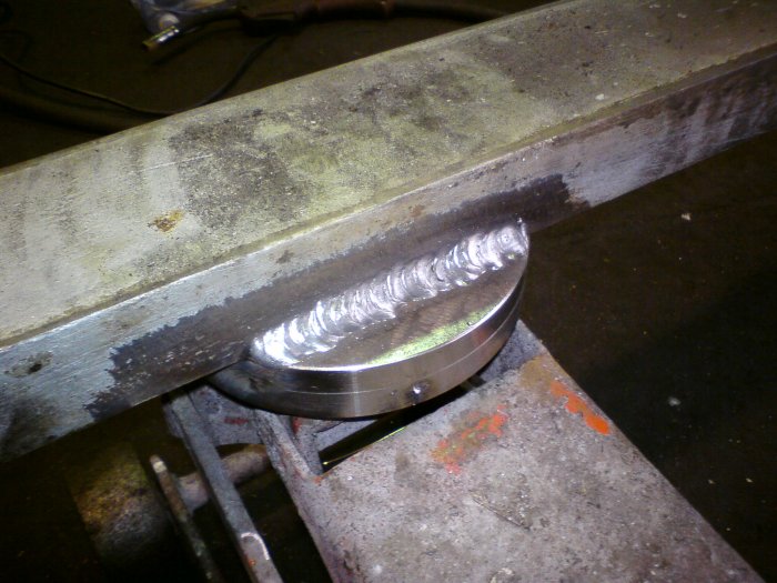

was given a couple of years ago a ramp jack (sits between the ramps to allow you to jack the car from underneath when raised using the jack points etc) that had failed its safety check - wouldn't trust the jack to raise a smile yet alone a car.
but the top bar is in good condition, so me thinks that a plate welded to this centrally with a stub could be put onto a trolley jack as the central plate is stubbed as well.
working off the floor, so till I can afford ramps I am looking for alternatives.
