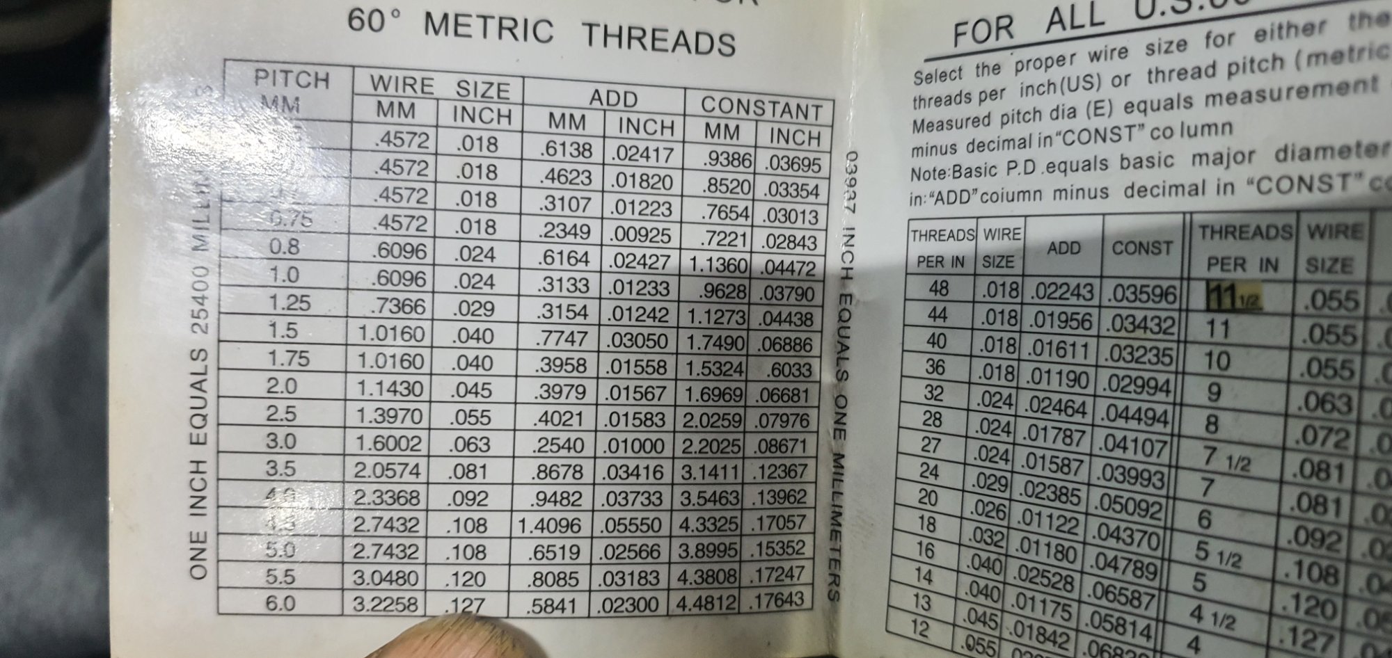

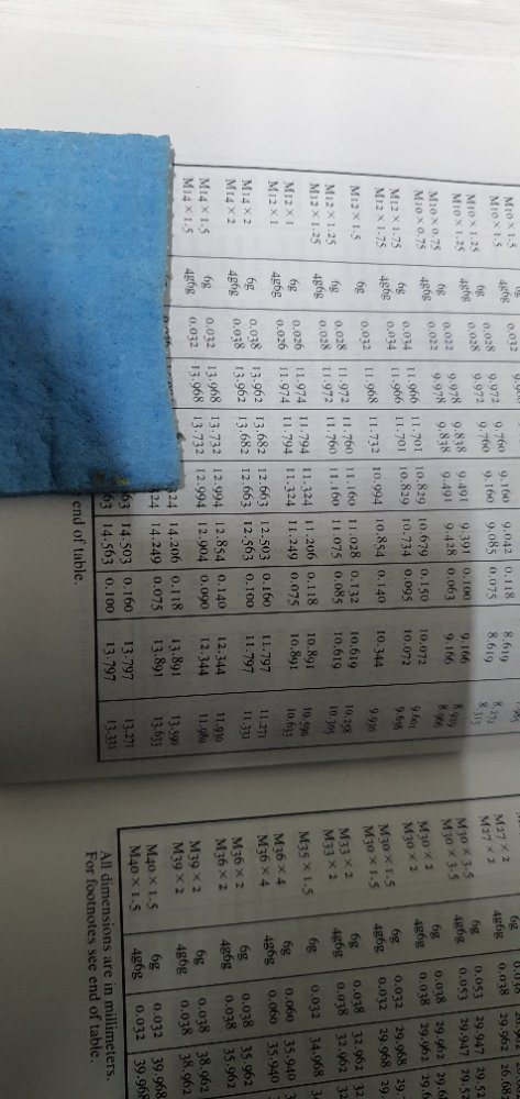

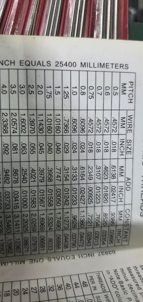

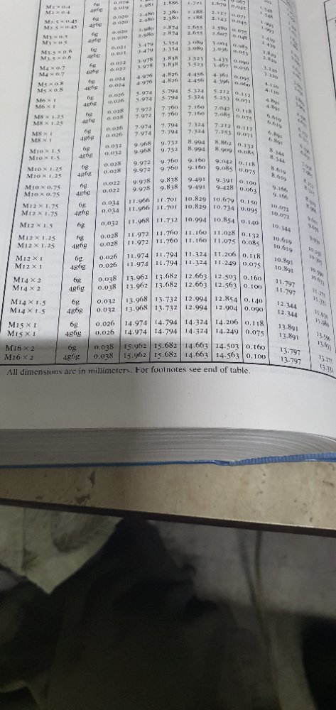

I do own a machinery handbook but reading/understanding it is not my strong point

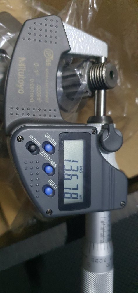

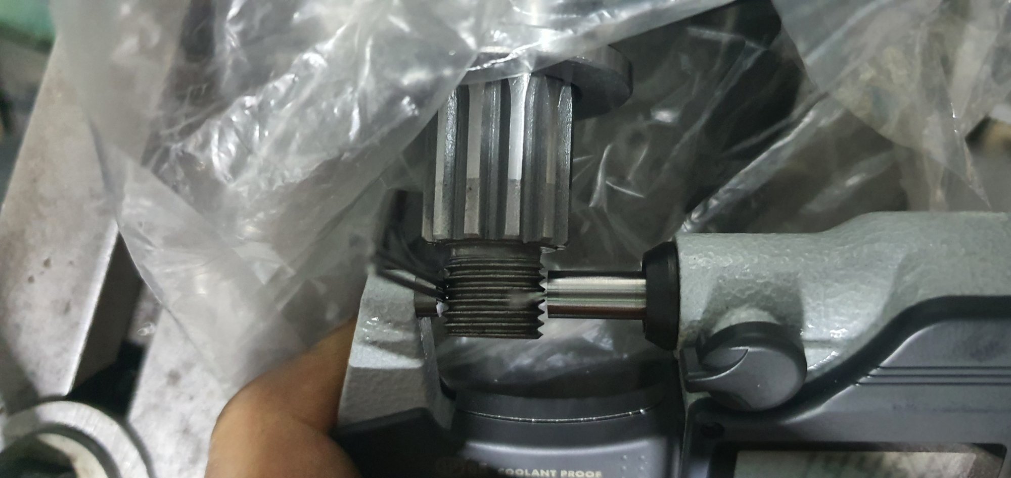

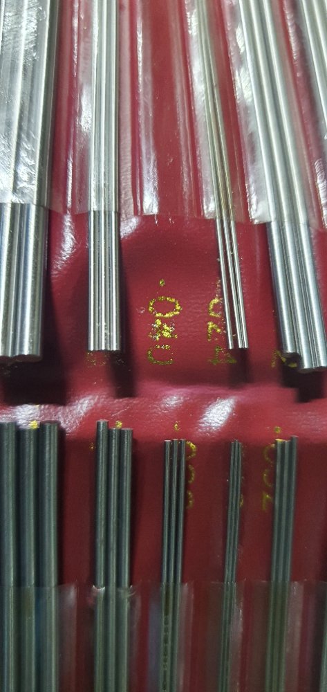

I have just purchased a motorcycle crankshaft.
I paid a lot off money for it as it was supposed to be one off the best

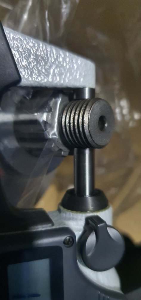

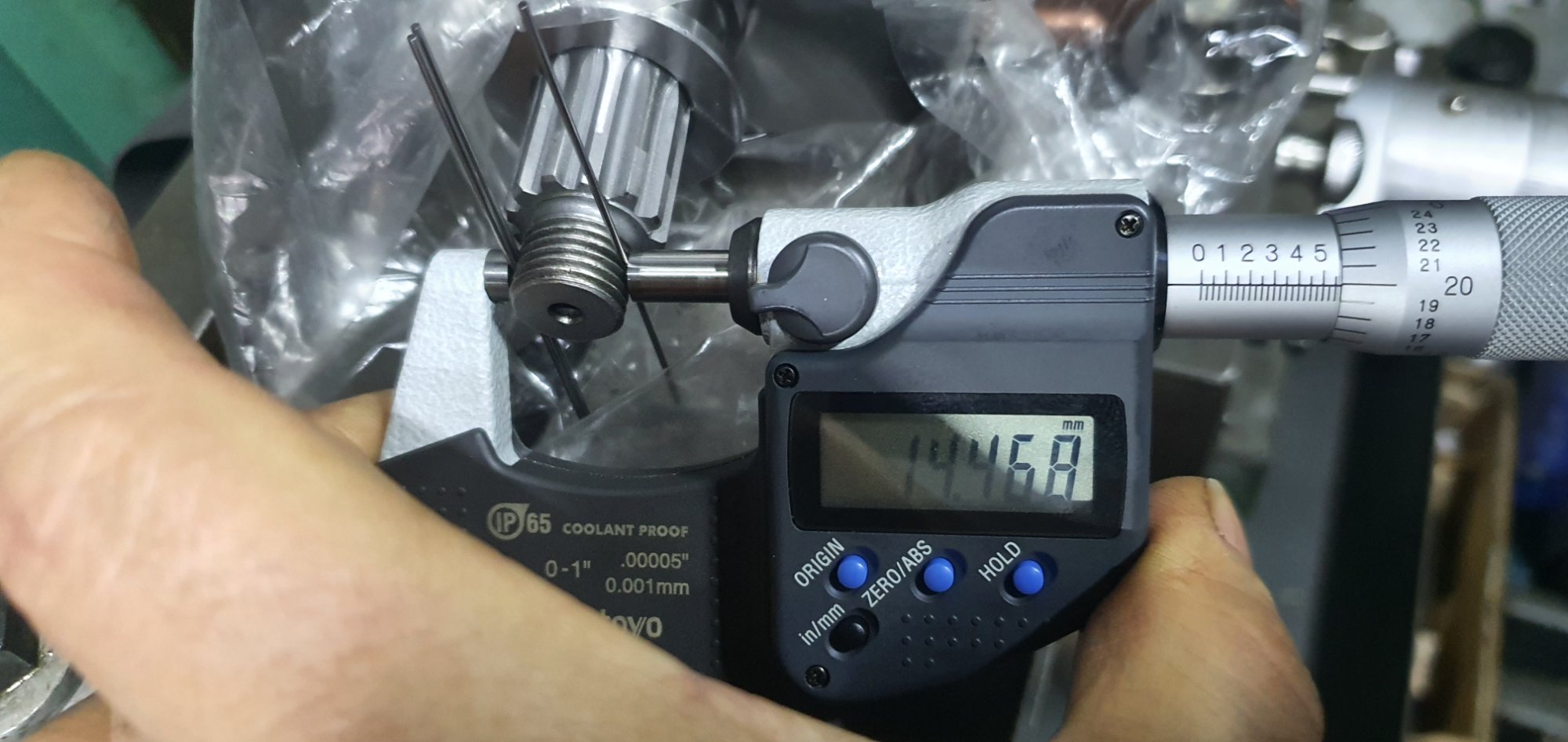

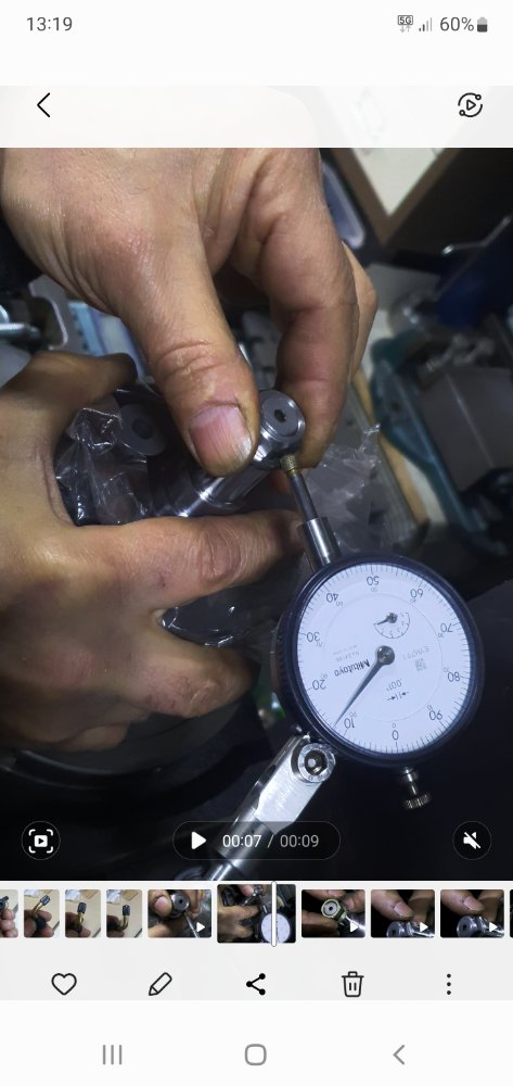

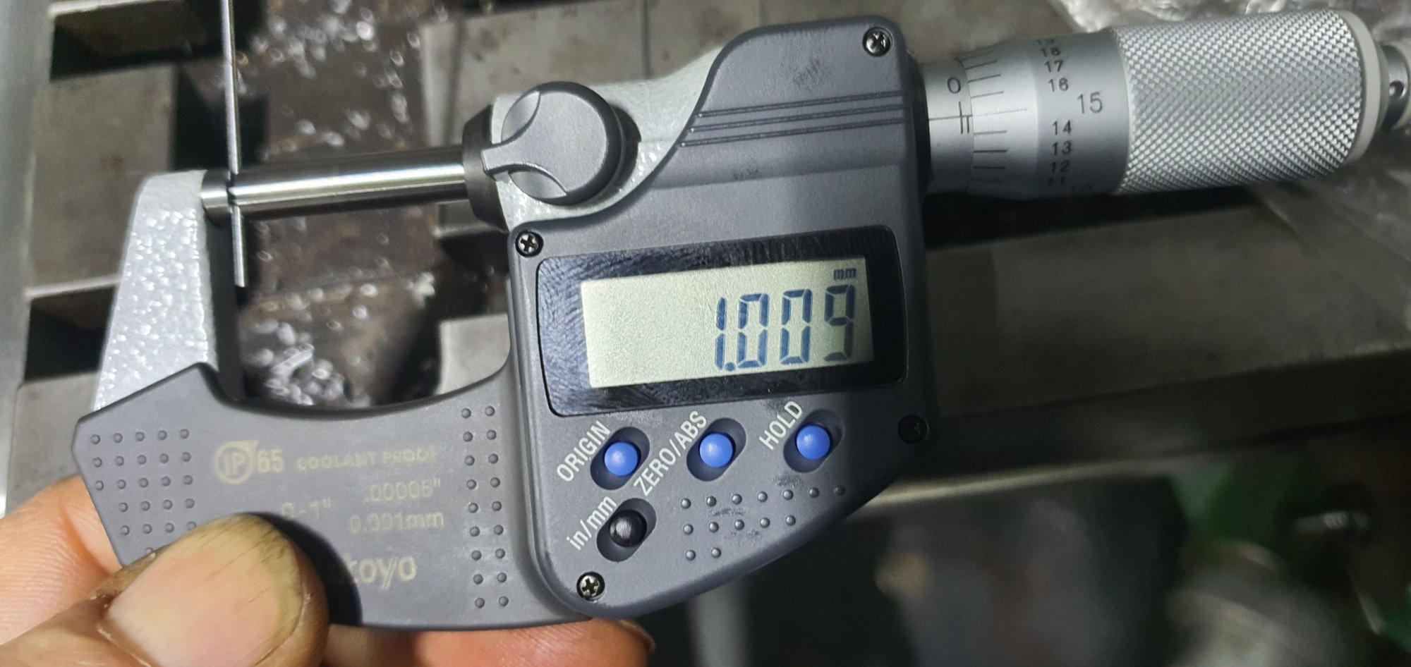

Unfortunately, I am not happy with the treads
The supplied nut for the clutch side slaps around too much for my liking.
I would like to verify it the threads are acceptable or not
