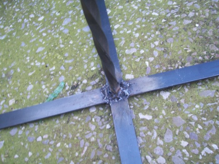

bet the crows and pigeons will love itI've just made my first thing today; a base for a bird bath!
Just thought I'd post the image for you to all laugh at and give me some idea of how I can improve my technique (apart from practice, practice, practice...)
I think you should put four gussets on that. It'll give you more to weld to and lessen the chances of it breaking off when a large bird lands on it.

I'm surprised no-one's mentioned about getting in a comfortable position.
Undoubtedly there will be times when you just cannot get comfy for love nor money but if you can, then do! If you can, position the job at a comfortable working height, whatever that might be for you. If that's standing height, make sure you're stood comfy. If it's lower, pull up a stool. I worked with a welder back in Sheffield in the late '80's and even though he was a 100% wazzock, he could weld. He always used to take his time getting sorted before he put a run down and after I watched him welding an overhead crane wheel with TWO stick rods, one in each hand, I fully appreciated his practices.
Call me Captain Geek if you wishbut I'm a great student of ergonomics. Whatever I'm doing, I try and get comfy and make sure that everything is in the best place.
