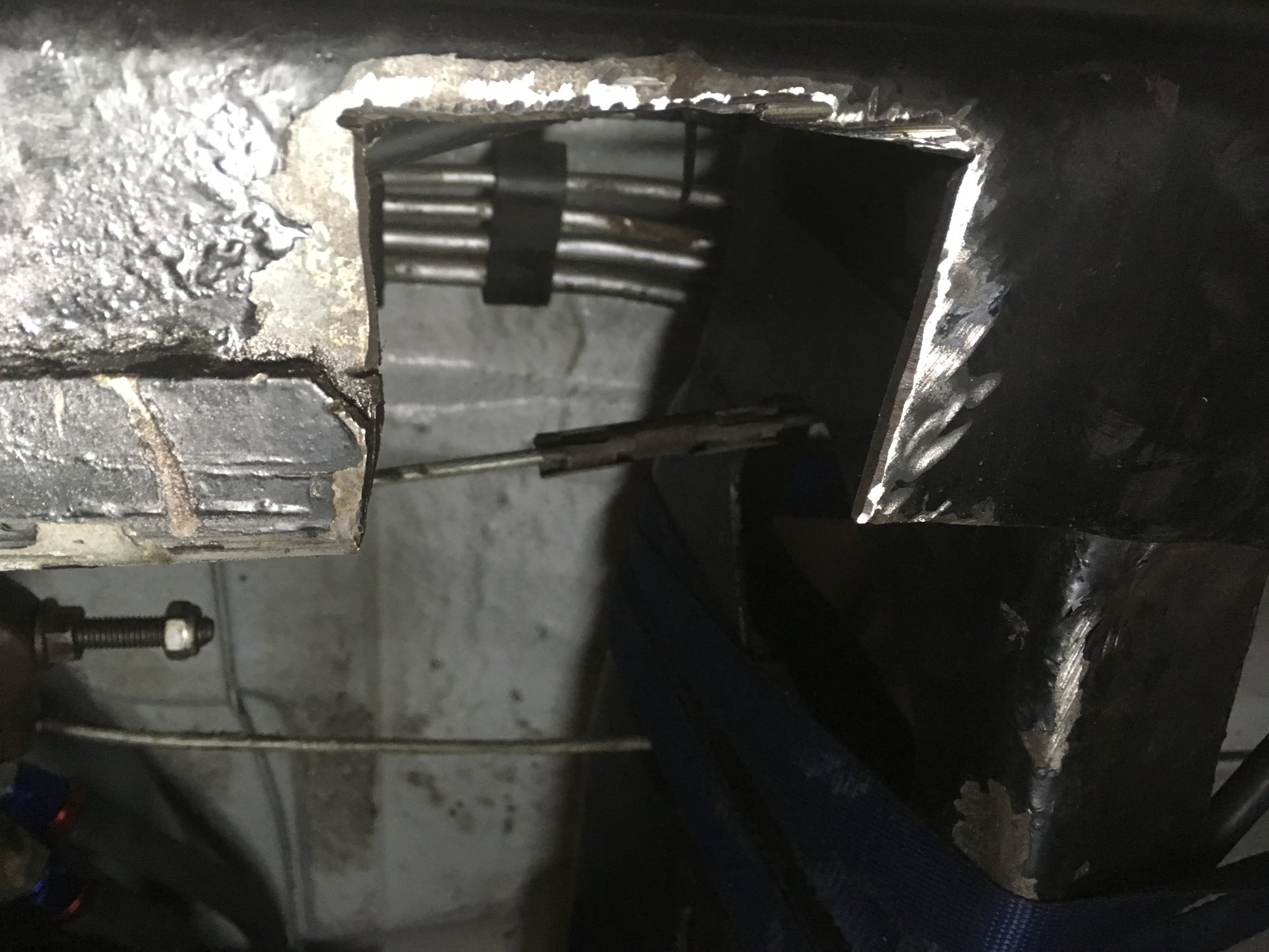

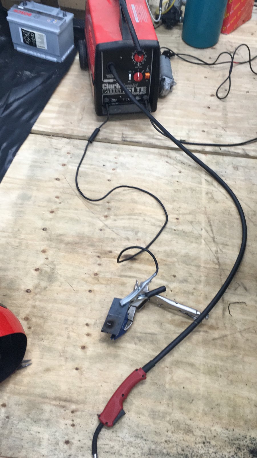

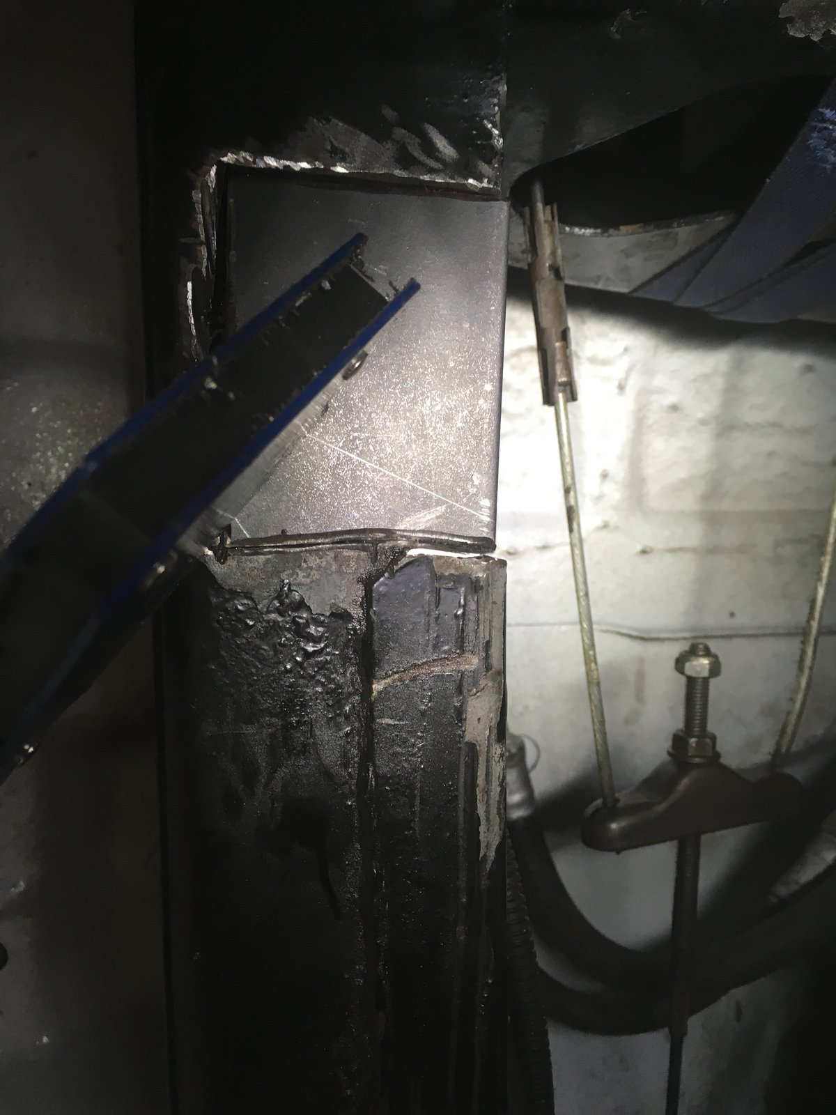

In a nutshell, I foolishly cut a piece out of the chassis of my truck. It's 4mm thick steel. I have a Clarke 151TE. I have argoshield. I have all the tools.

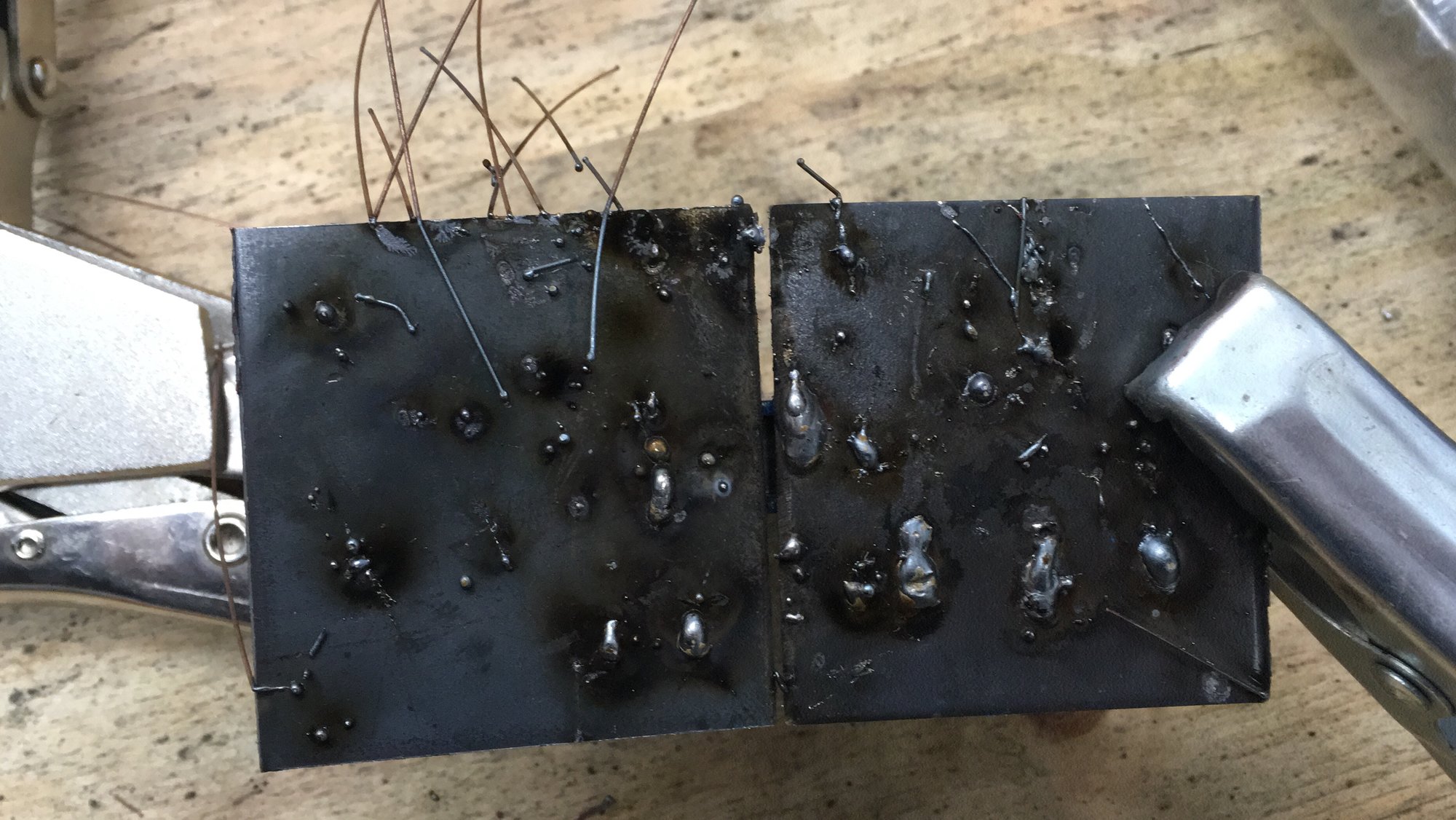

I set myself up...(for failure)... I've had the welder a few years and have used it in the past to make some welds but last night, a 30 min job turned into 2 hours as I tried to find the problem.

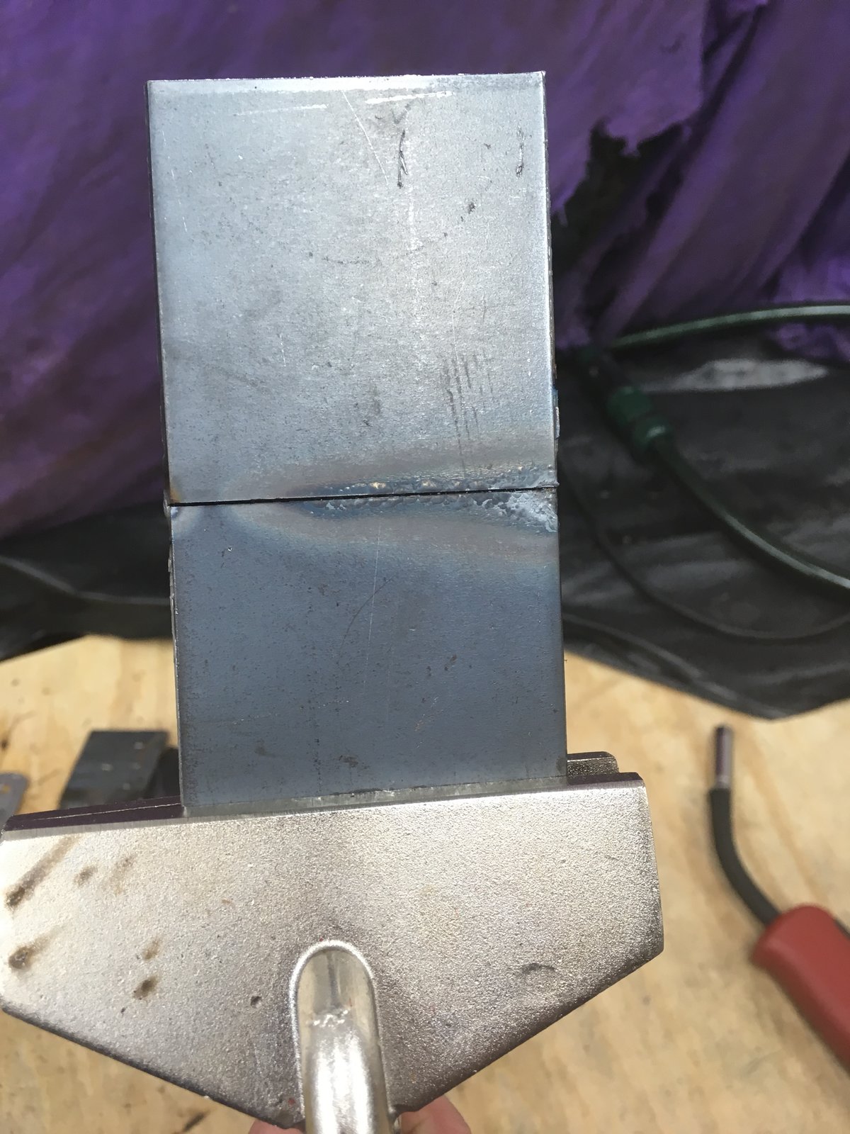

I thought some simple butt welds would be a good start but alas, the welder wasn't happy...

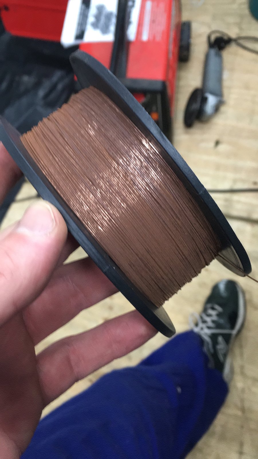

I changed the shroud and the tip but then I read the manual and had a look at the wire:
Not so good eh? So, I luckily had some 0.8mm wire laying around and learned how to change that around and got the welder working.
The very next weld:
I was very pleased but that was it for the night so I decided to attack it again today.
So, the section missing from the chassis is 55mm x 70mm approx and measures 4mm thick. I got a piece from a local engineering place and cut it to size as well as putting in a v on each side of the weld, ready to go...
And the piece fitted, magnet and all...

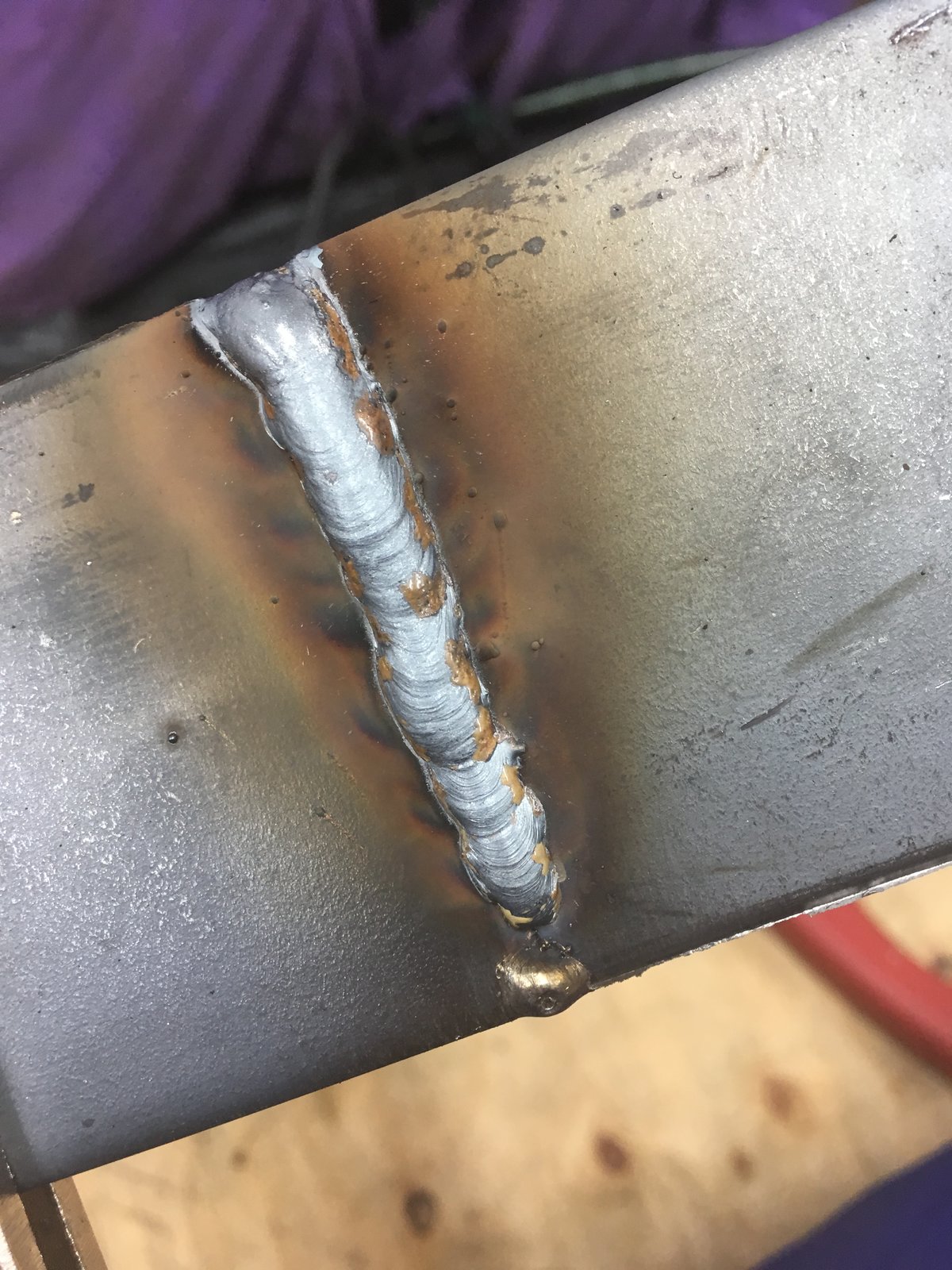

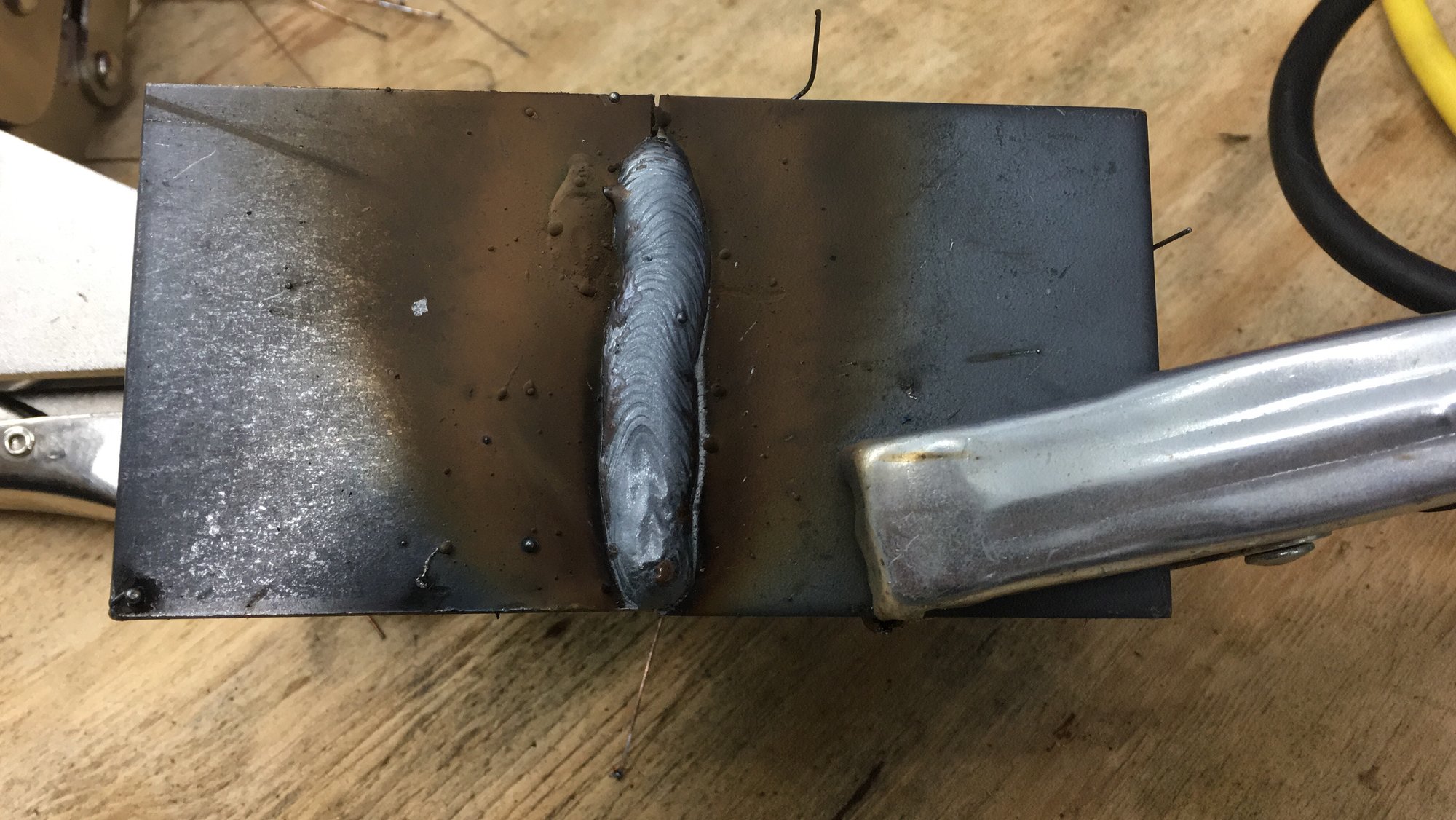

I decided to practice a bit more before messing up my chassis. This was my second attempt.

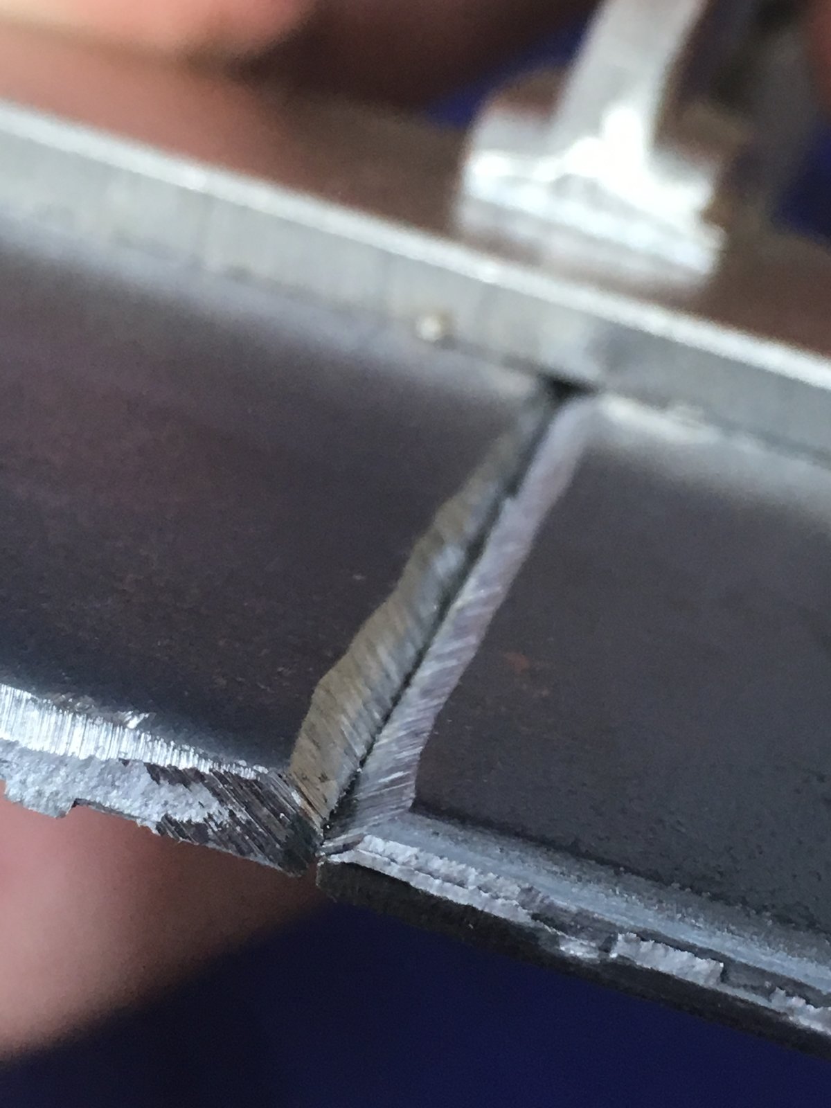

I thought it looked OK but it didn't go all the way through it would appear.

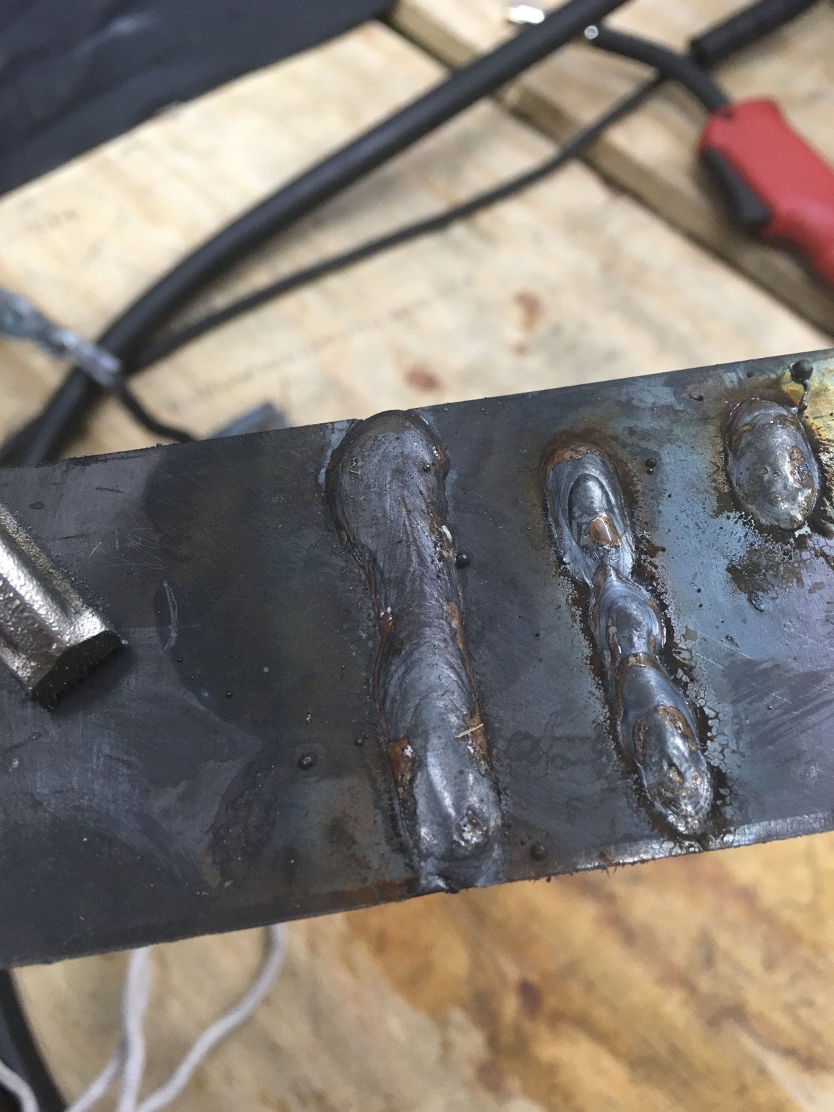

I tried again..
Weld looked OK on the top...
But again, didn't seem to penetrate... see next post.
