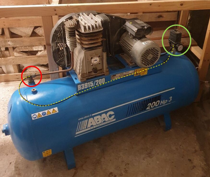

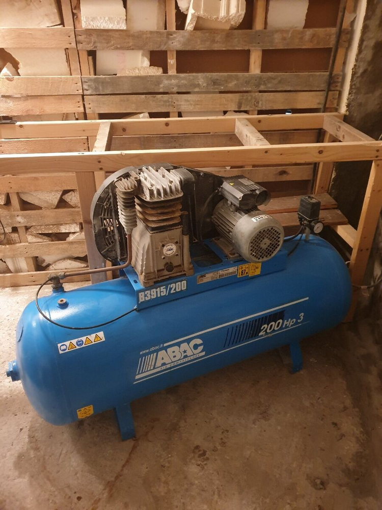

Hi all,
First post here as ive seen a lot of helpful posts here and hoping someone can shed some light on my problem. I have an ABAC B3915 Compressor 200L wired to a 13amp plug. My issue is when using the compressor normally from an empty tank it will start no issue and take some time to fill up which is normal I believe. My problem is that if I was to use the compressor and come back the next day and try to start it with 50 or more PSI in the tank (tank not fully empty) It will try to start up turn the motor over a few times and then trip the fuse in the garage. I had a look online and found out that my pressure switch seems to be rated for 16 amp 240V single Phase link attached. https://www.compressorshop.co.uk/ne...-?search_string=s-9063084&records_per_page=10.
Would this be why the compressor is tripping the fuse when the tank is not empty because its possibly drawing more power on startup with air in the tank as opposed to being empty ? It can take about 5 minutes for the tank to drain fully most times when trying to use the compressor and its a small inconvenience but when your using the machine every day its very annoying having to drain it empty before each use and then let it fill up to max again before using.
When using the compressor normally for example drained tank, filled back up and start spraying with the compressor there is no issues at all when the tank goes to refill after reaching say 50-70 psi before running the motor again it does not trip the fuse only trips when there is air in the tank and I come back the next day to use the compressor.
Any help appreciated, thanks
