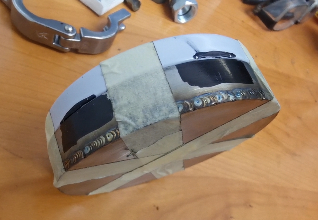

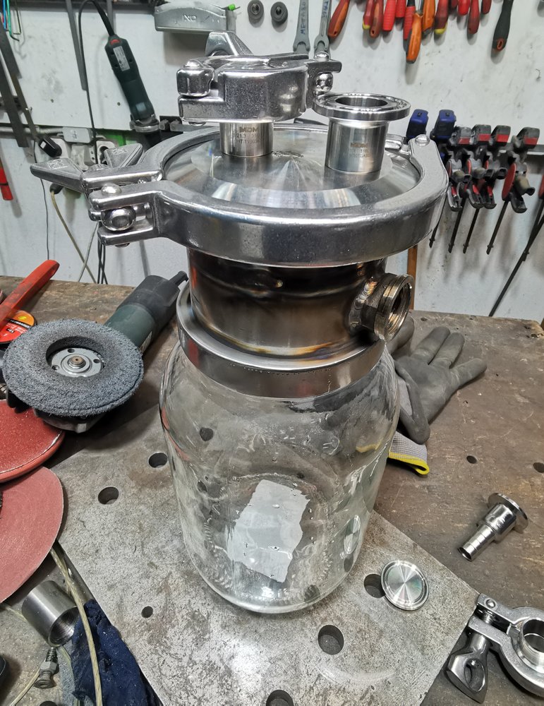

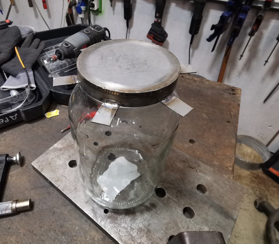

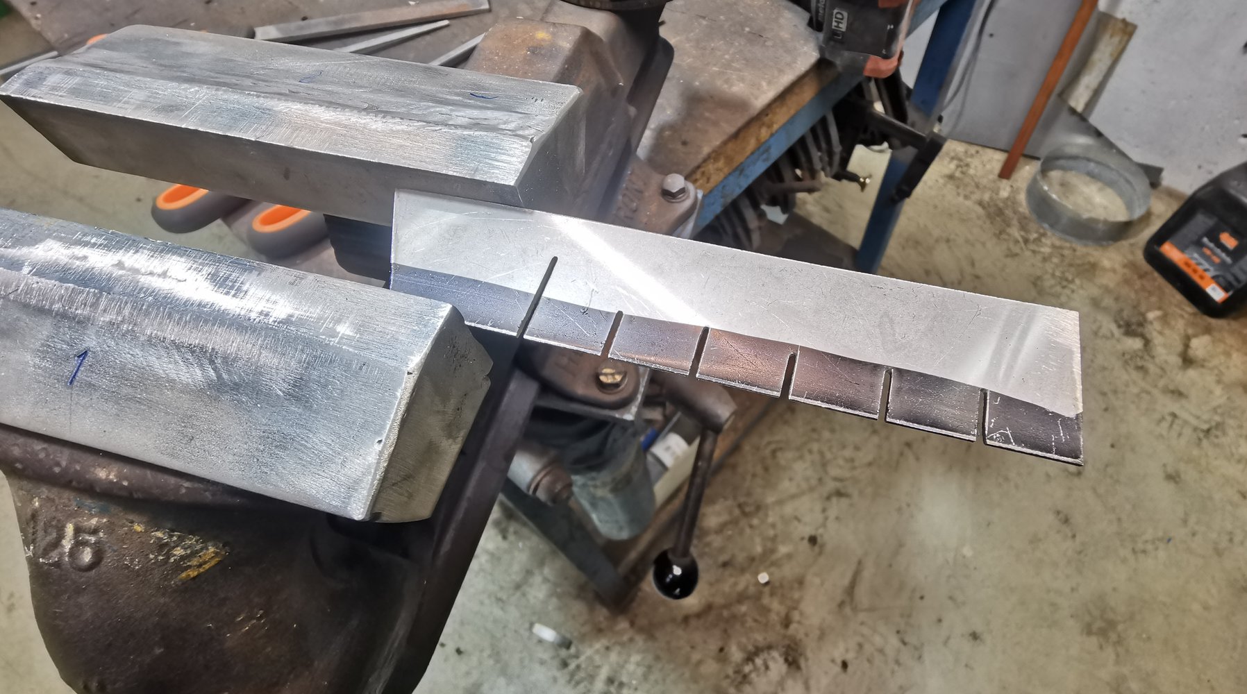

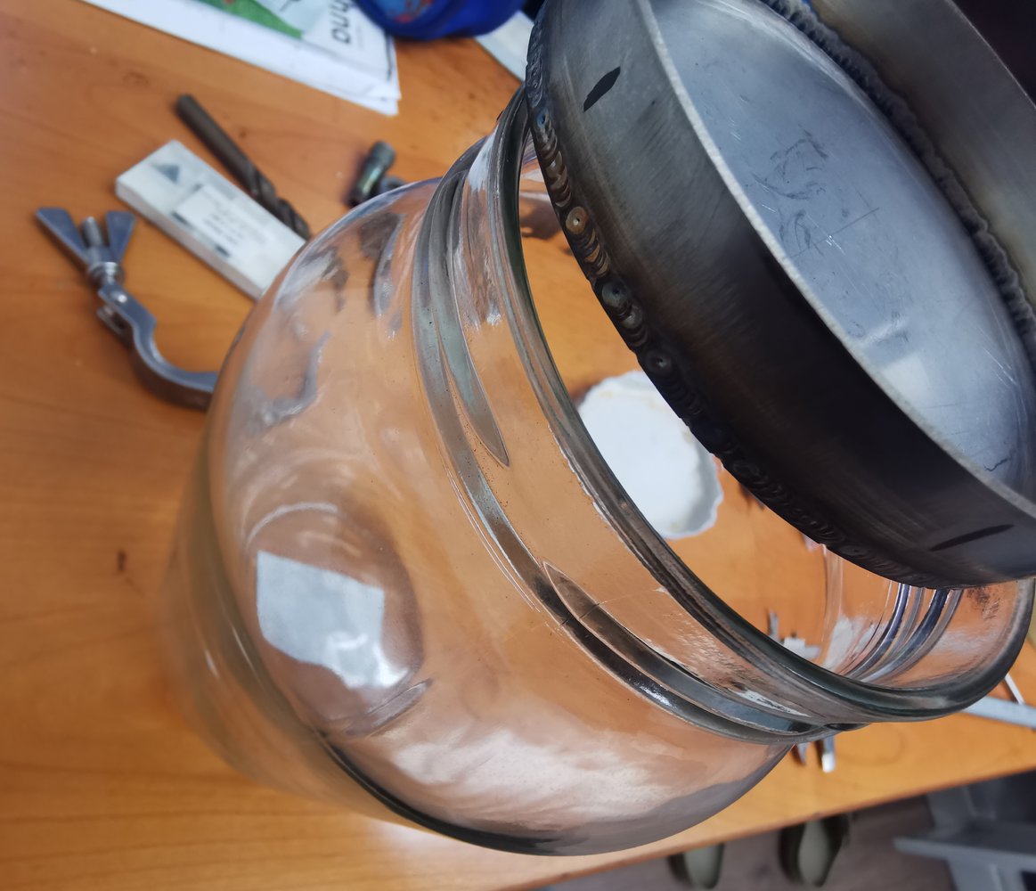

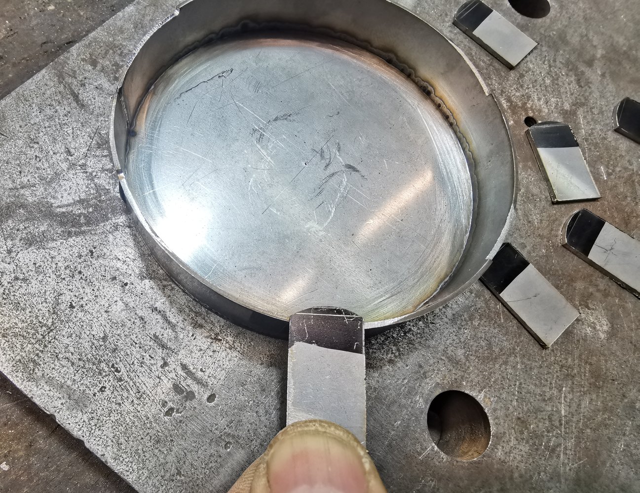

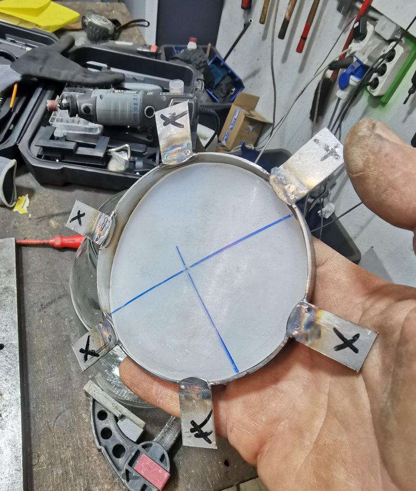

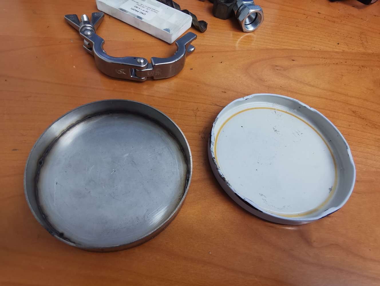

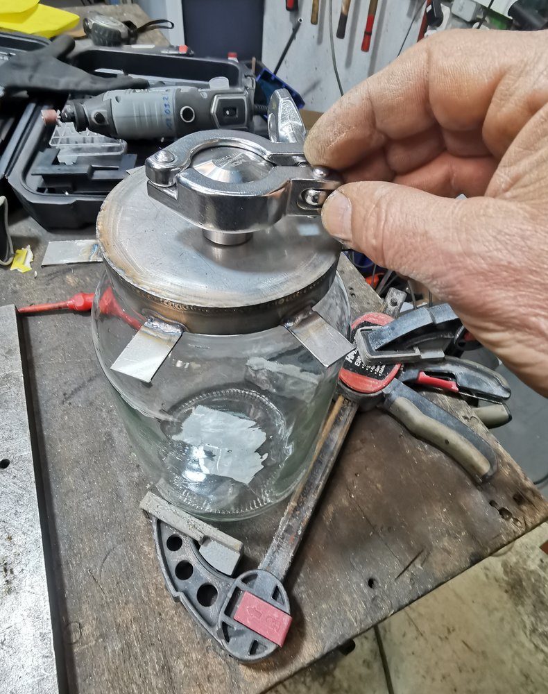

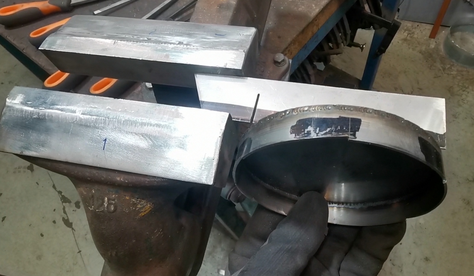

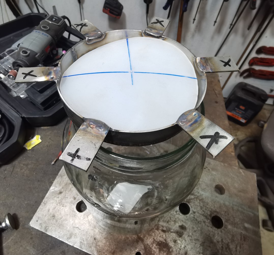

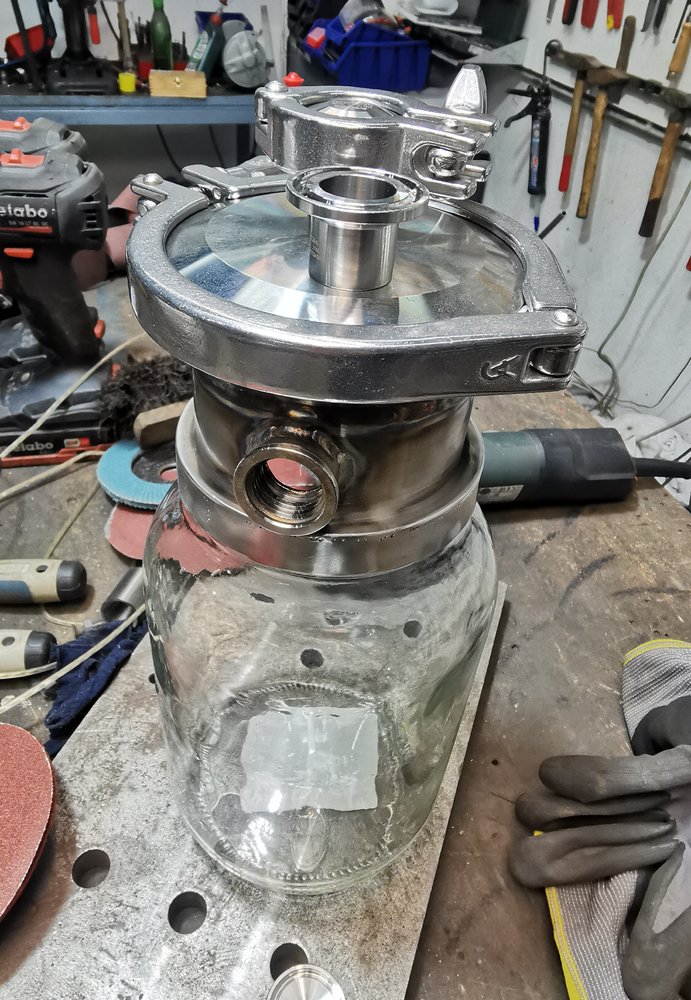

View attachment 428467 View attachment 428468 View attachment 428469 View attachment 428470 View attachment 428471 View attachment 428482
I haven't finished the lid of the jar yet, it will be more functional. That's what I'm doing right now. Synthesis reactions - gas supply, gas removal, ultrasonic probe, anchor stirrer, external heating and so on. Several functions for different tasks.What type of chemical reaction you plan to run in this jar?
