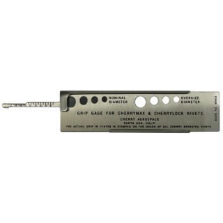

Sarto Small flower carts specialist Messages 478 Location Padova - Italy Apr 5, 2018 #22 Maybe you don't need it anymore, but I find this catalog good to have a look on the size (and the strenght) of the rivets, when I need some info. http://www.rivit.it/content/files/rivit/content/pdf/Blind-rivets-Rivit-catalogue-2017-8_1.pdf Hope this help. SARTo

W wookie Member Messages 2,590 Location . Apr 5, 2018 #23 thanks @Sarto that is spot on From that catalog for example for a 4.8mm rivet needs to be 5 to 10mm longer than the thickness of material being riveted before use.
