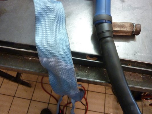

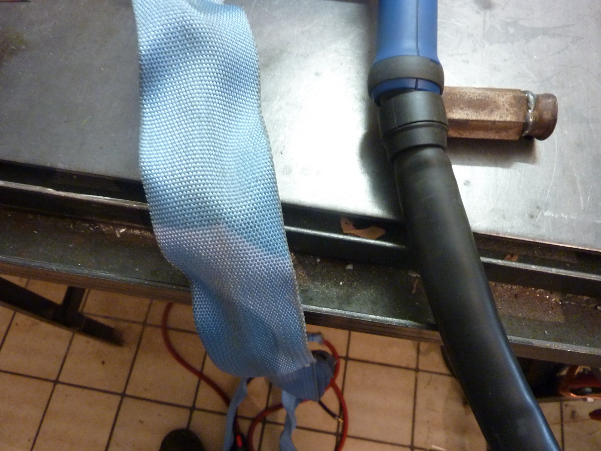

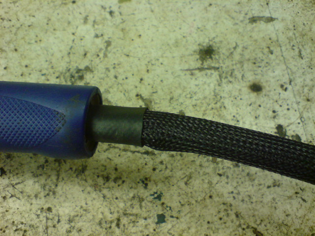

One thing I struggled with was finishing the weld neatly. The button on the torch was not very well positioned so when I released it at the end of a weld the torch would jerk. I used the welder on 2t rather than 4t as that meant less button presses.
I am also going to get a flex head torch, it will make it much easier to get a better angle for welding. I am also thinking that a bicycle clip would be useful to hold the cable on your arm as my lead is too stiff to wrap around your arm.

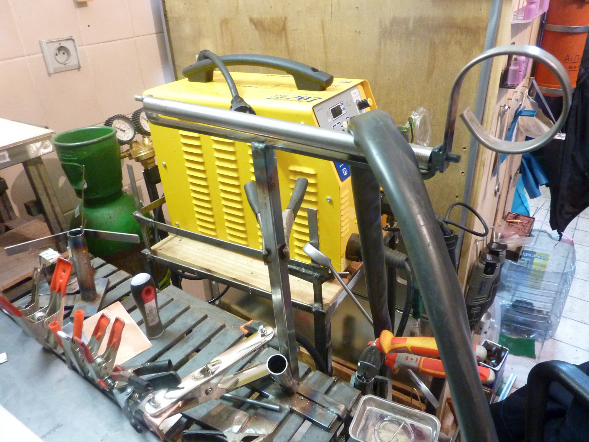

I've no welding bench yet but I've one planned (a modified drawing table). One thing I really need is a welding trolley, welder is currently perched on the bench, ready to fall & break like my last one and the gas bottle is tied to my sack truck!
and was a good way to learn tig the hard way.
