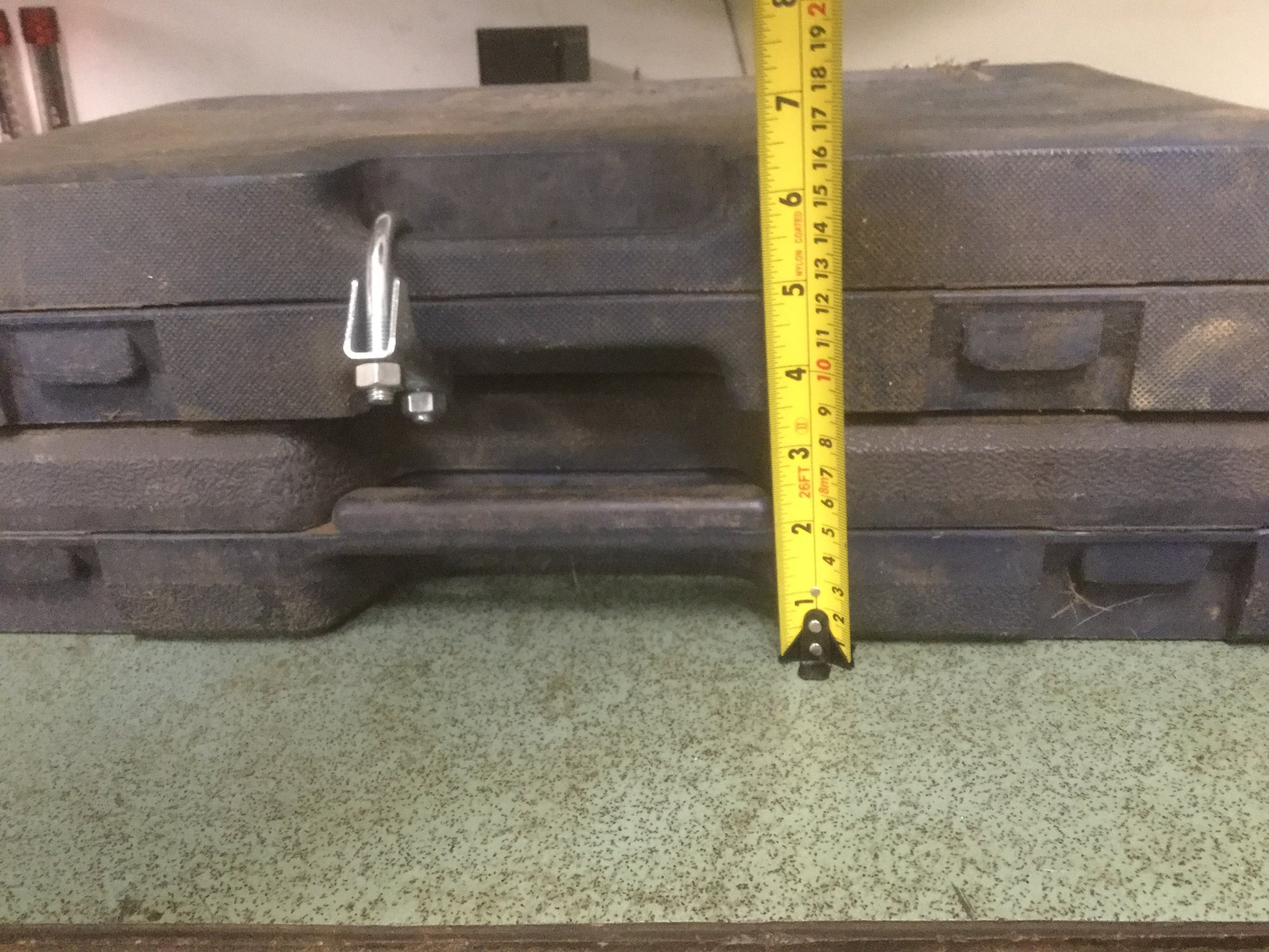

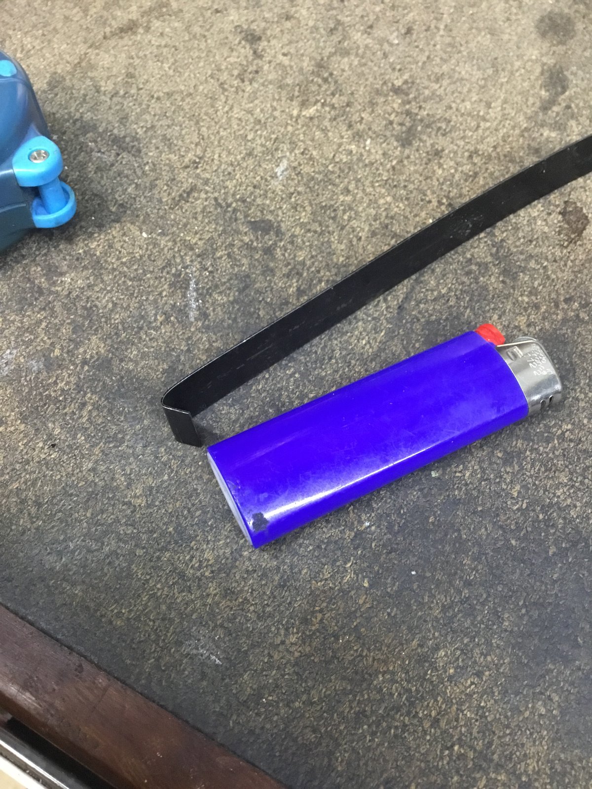

A catch for the original tab could be made from a bit of wide spring steel pallet banding. Its about 25mm wide, a 5mm bend in the end would hold it. Pop riveted to the other side; the type that expand to a star
Can find any 25mm its thicker as well. You get the idea
If you can wait for them, cheaper than chips !

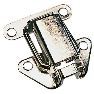

toggle latch?
https://www.screwfix.com/p/toggle-cabinet-catch-nickel-plated-45-x-36mm-10-pack/15443

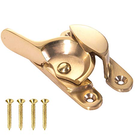

or a sash window lock:
attach with pop rivets

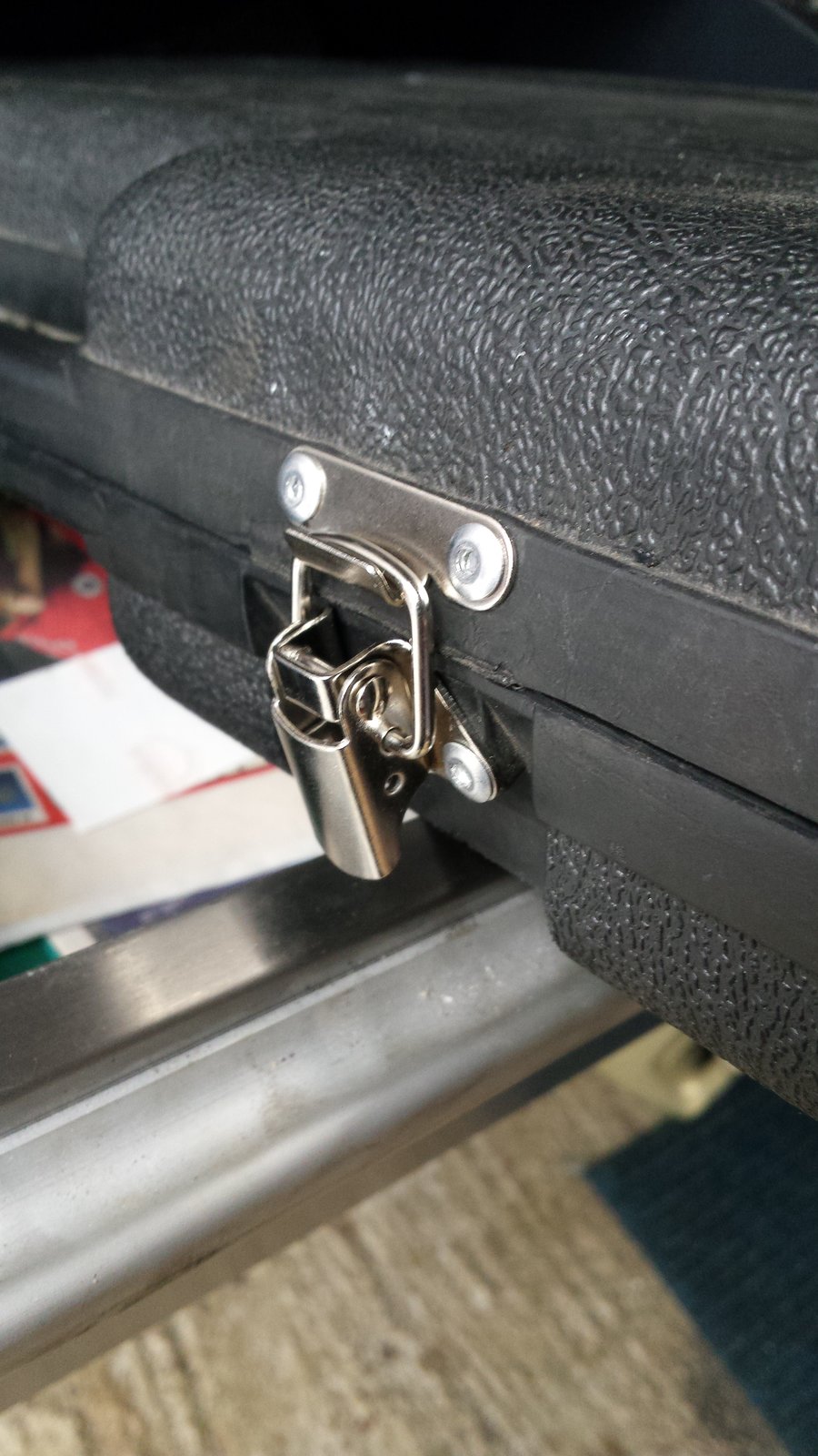

This type of over-centre catch:
https://www.ebay.co.uk/itm/Metal-Su...-Hasp-Latch-Catch-Clasp-Hardware/352328291644
Probably need to make backing plates for the inside of the plastic case, and fix through with 4mm aluminium pop rivets.
