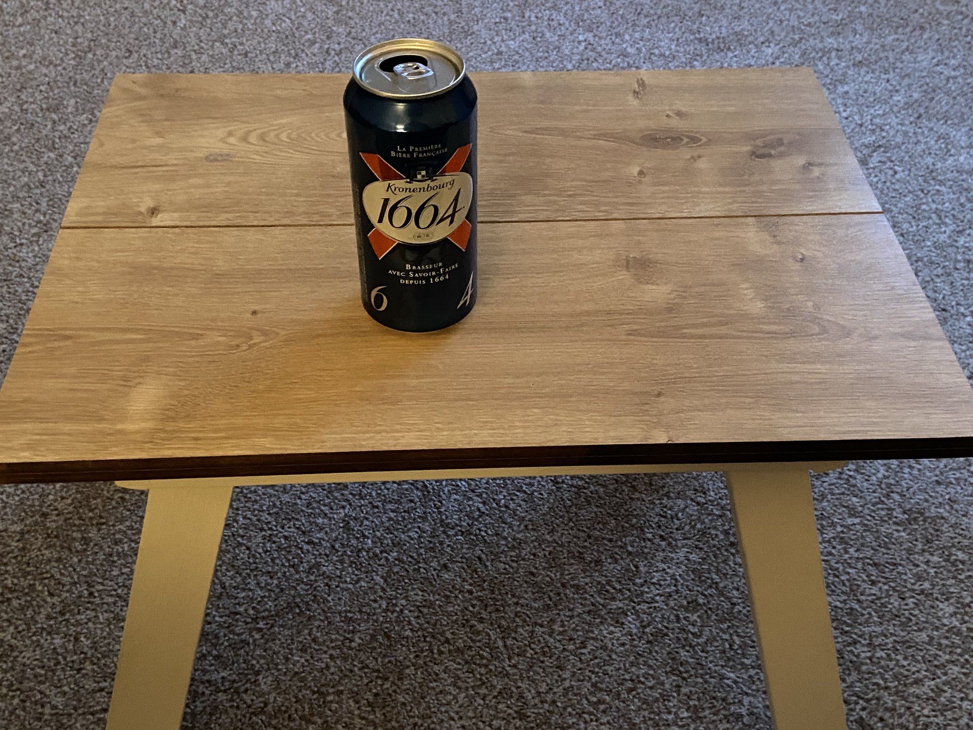

Following on from our last table build, this happened
It really is made from junk that I’ve collected when going for a walk every evening

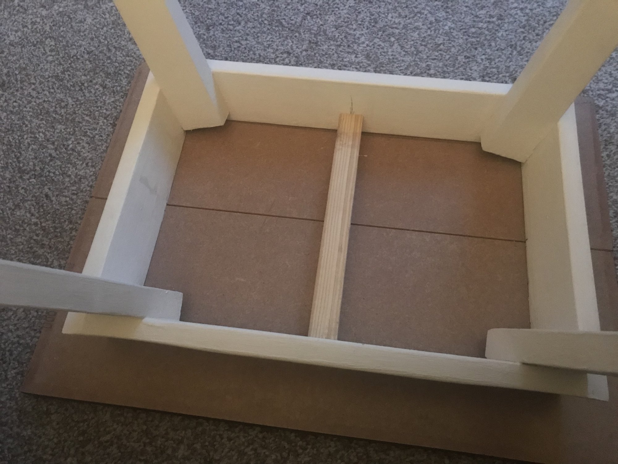

The legs are old roofing battens, the rails are old bed slats and the top is two layers of laminate flooring. First one screwed to frame second one stuck with pound shop epoxy. Paint is a tin of Dulux Matt emulsion that was out for rubbish. Filtered through a pair of tights and it was good to go. Brown dye on the edges is a bit of brown boot polish.
Total cost is £1 for a tube of pound shop epoxy
It’s not perfect but I’m quite pleased with how it’s come out
