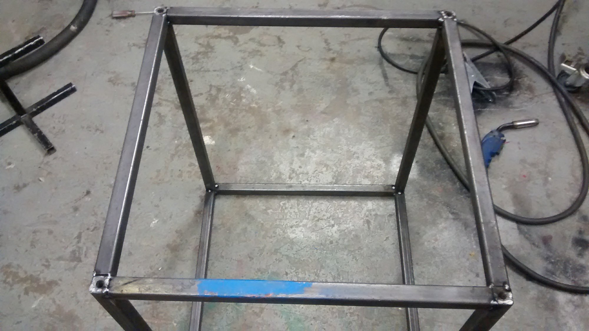

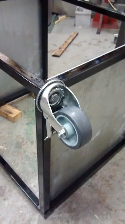

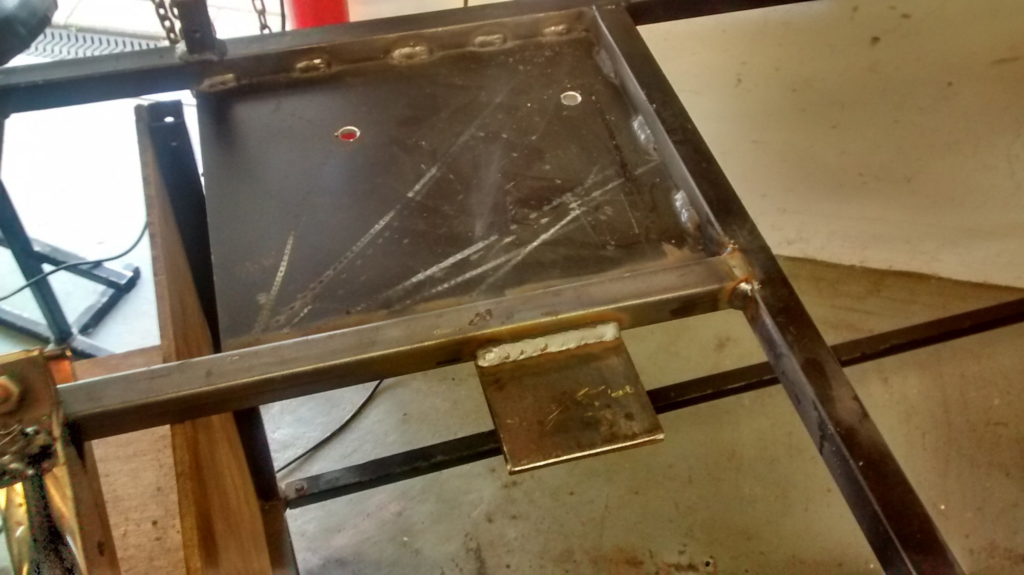

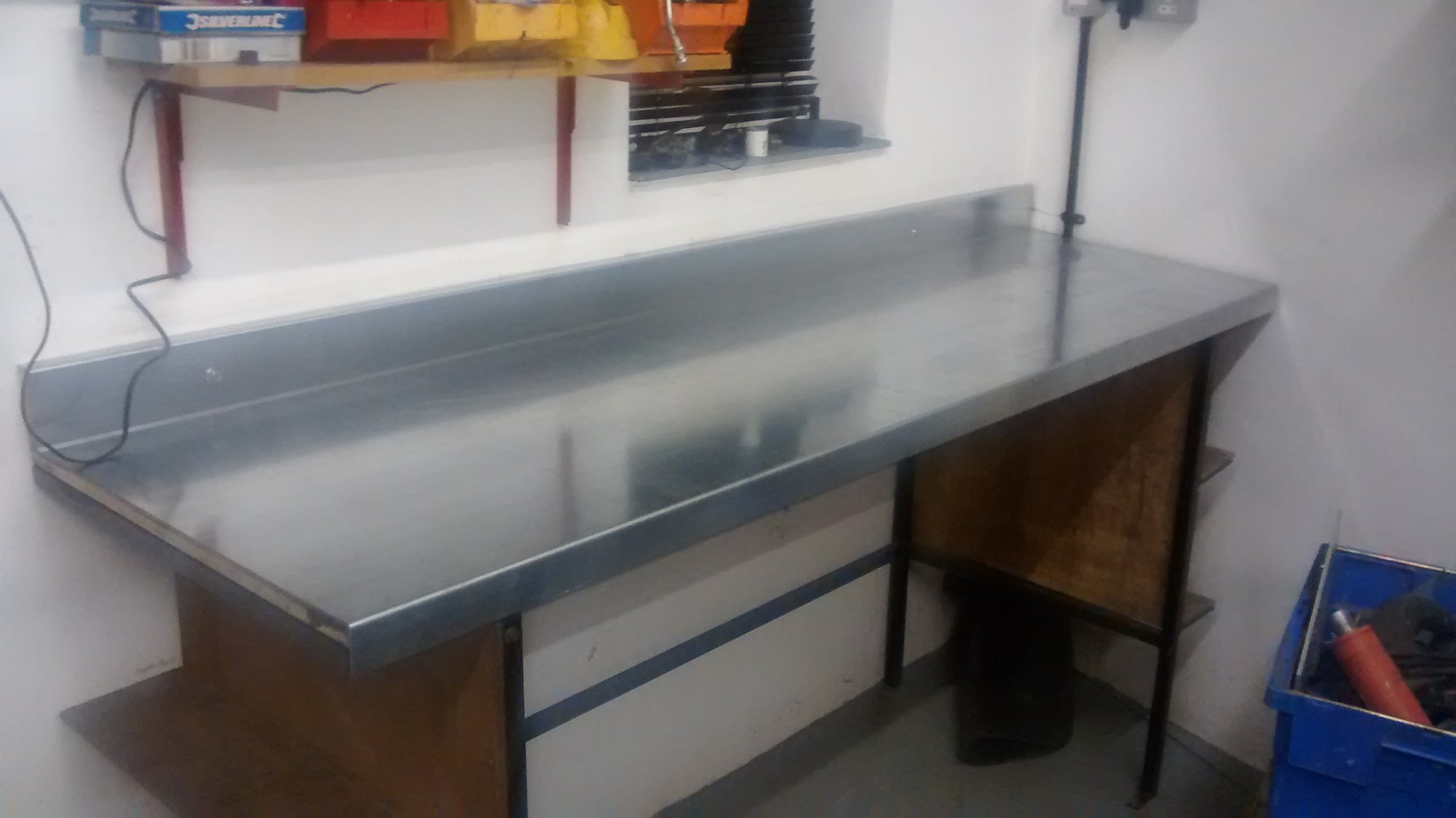

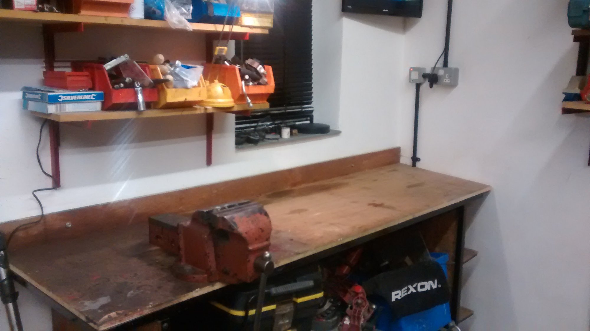

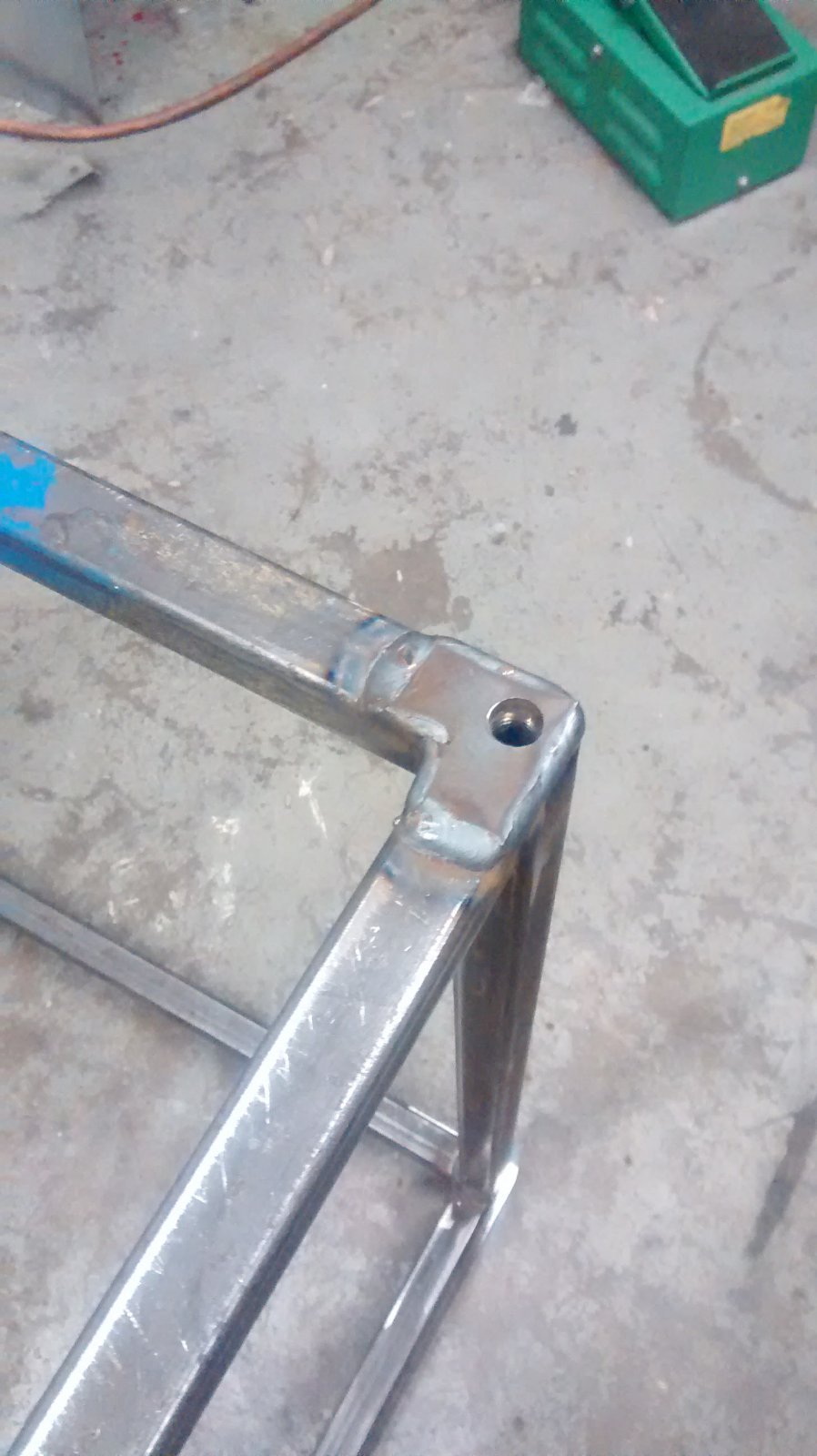

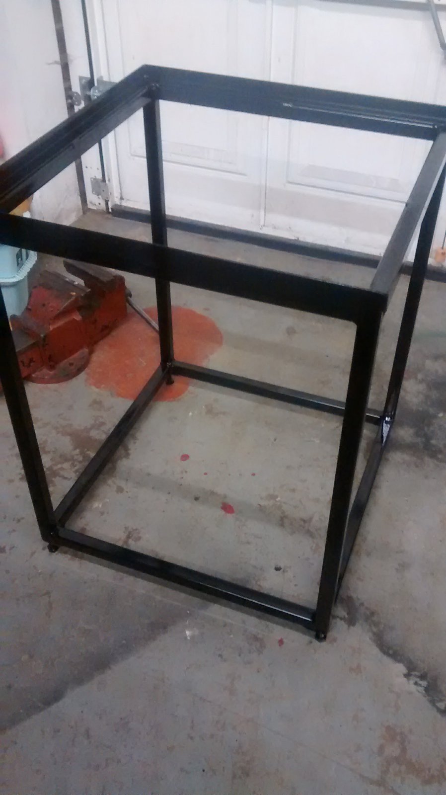

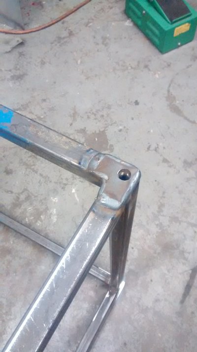

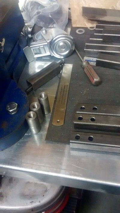

Fazerruss Member Messages 3,159 Oct 29, 2016 #1 I recently purchased a new to me record vice so but it had different fixing centres so the bench needed some modifications. I also had a new steel top folded. Before . ...... New top on

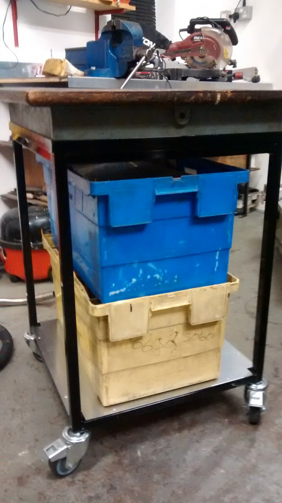

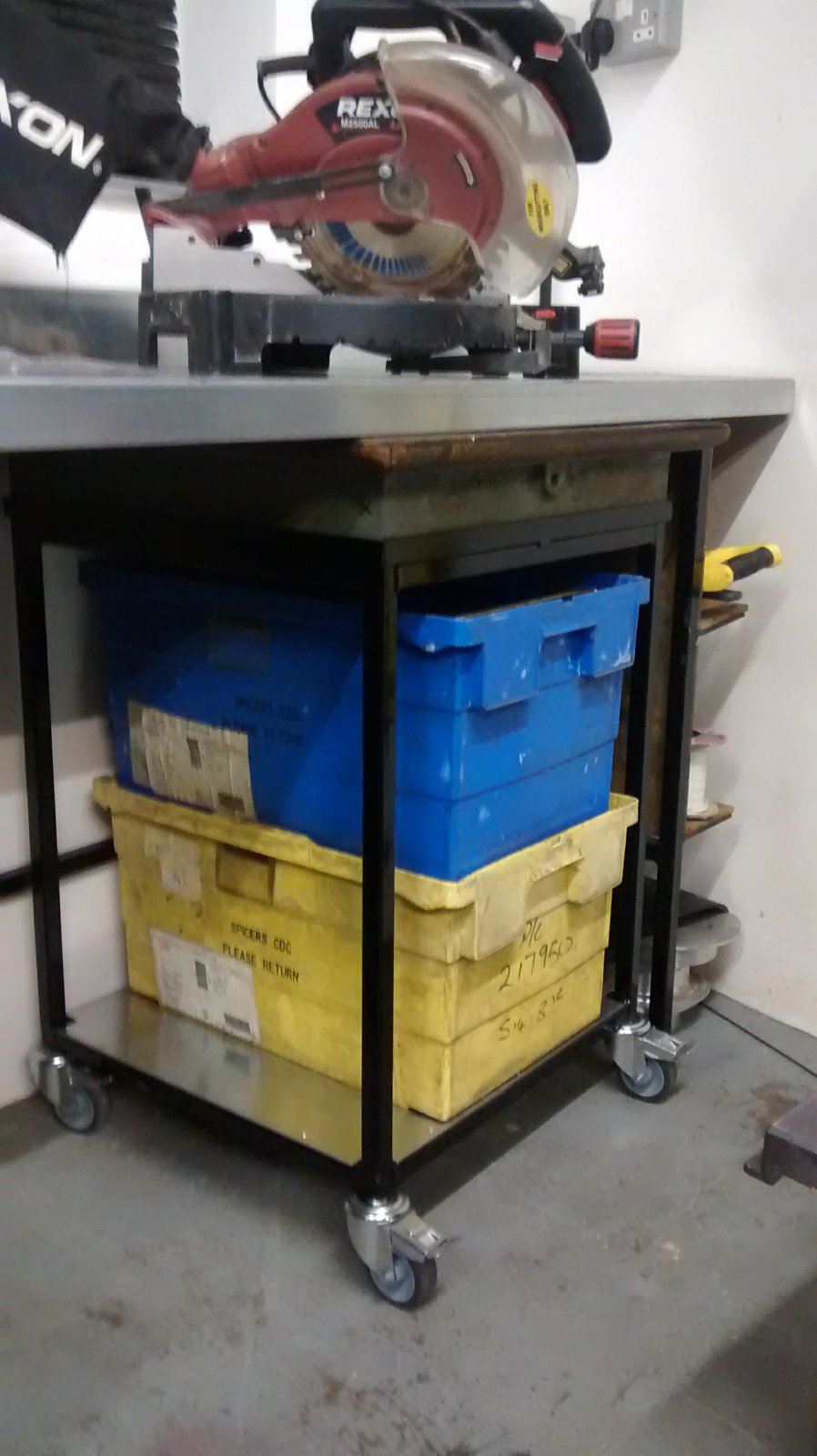

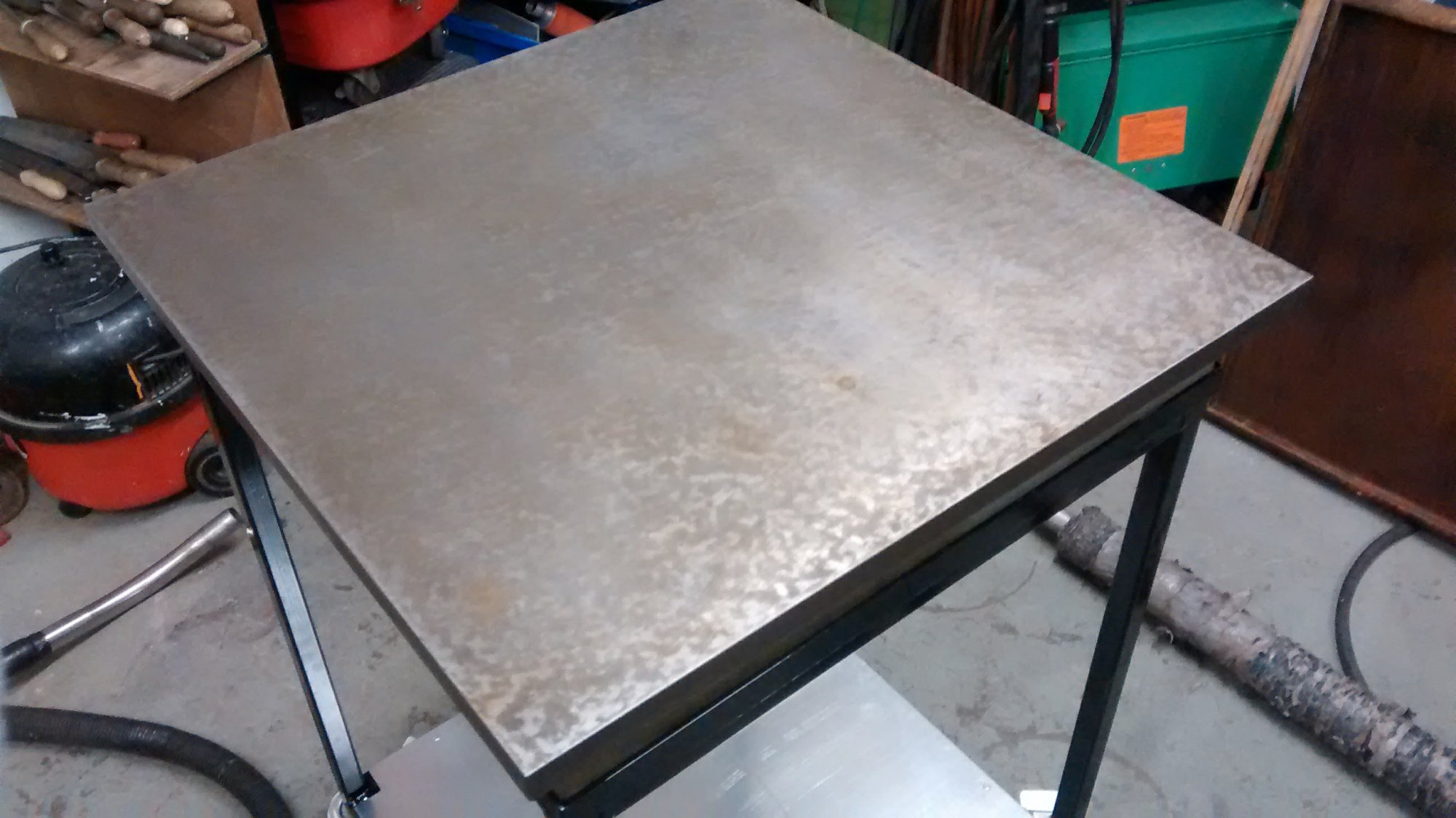

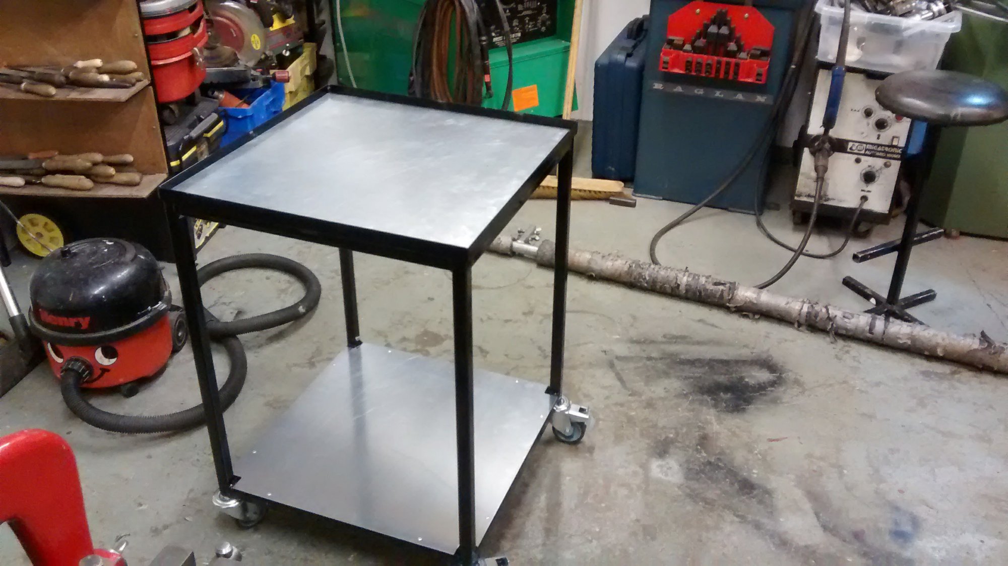

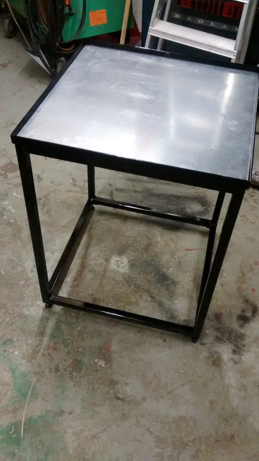

Fazerruss Member Messages 3,159 Oct 30, 2016 #8 I nearly killed myself lifting the surface plate. it's 2 foot square and weighs a ton! Last edited by a moderator: Oct 30, 2016
Fazerruss Member Messages 3,159 Oct 30, 2016 #9 pdg said: Is the plate resting in the angle all the way round? Should it not be on 3 points instead Click to expand... No, the surface plate has 3 feet (part of the casting) so it sits on those. the angle is just to stop it sliding off on to my toes Plus it gives a nice neat finish
james butler Member Messages 1,536 Location birmingham england Oct 30, 2016 #10 i like it, looks very nice especially as it tucks away under your desk like that
