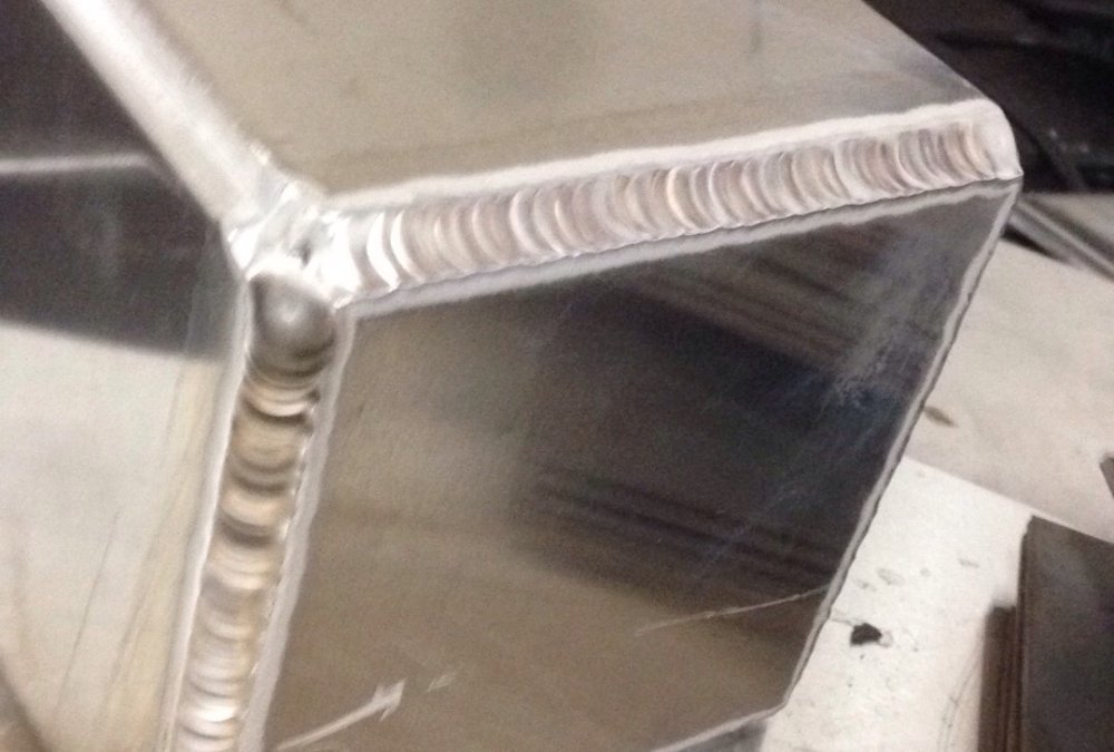

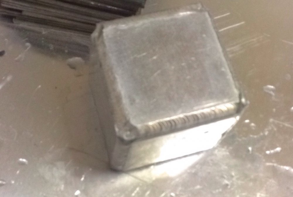

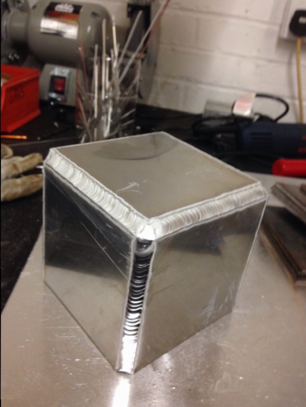

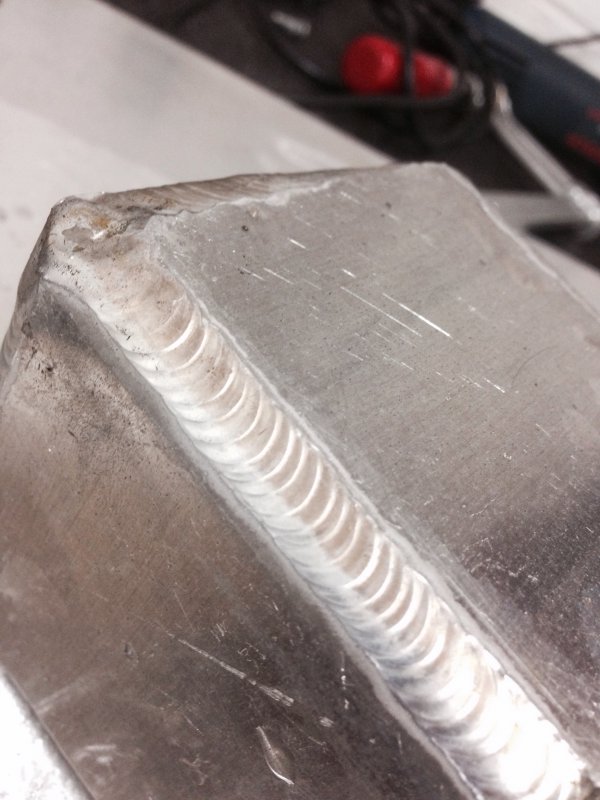

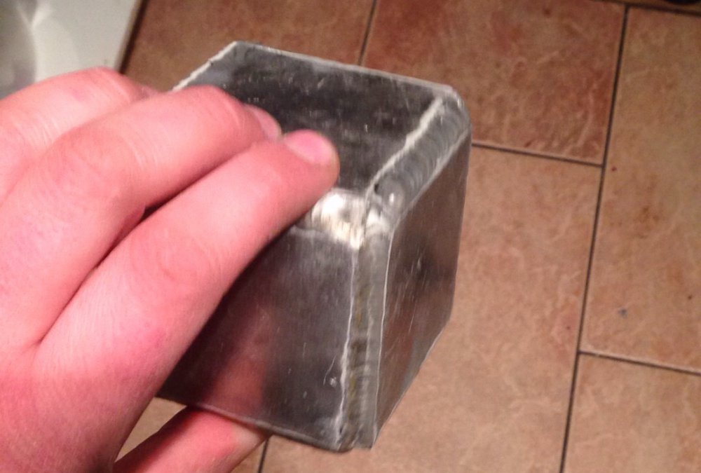

If you currently add the last dab of wire, stop moving and then slope out instead try adding the last (or an extra) dab of wire while sloping down and/or keep the arc moving until the weldpool freezesStill struggling a little on the crators at the end of the weld. A lot harder than tapering down on steel.
