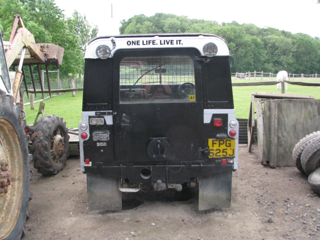

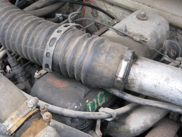

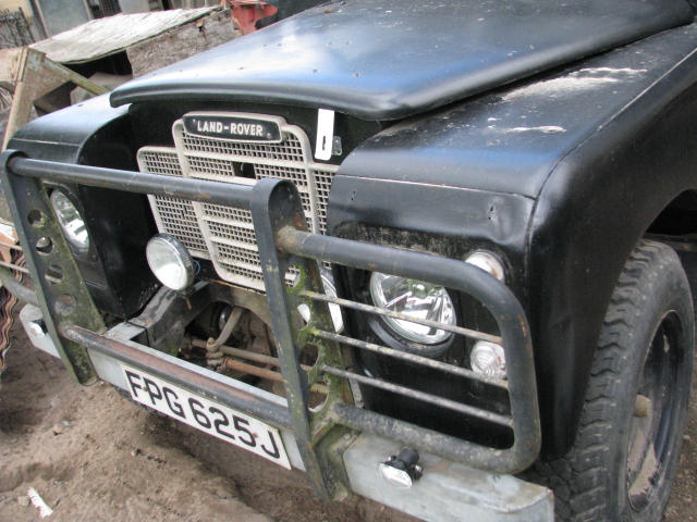

Here is my series 2a/3 shortie, it has basically had the entire good body shell grafted onto a s2a chassis, the engine has been changed for a Daihatsu F50 Taft diesel it was petrol.
The chassis has had some work done, rear x member, and front dumb irons changed, but other than that it was sound, someone will spout its a s111 but it retains the chassis, steering and suspension, the rest of it was a rotted out chicken coup, much of the work was done some five yrs ago, and just recently the project has been revitalised with a new clutch and fuel tank fitted.

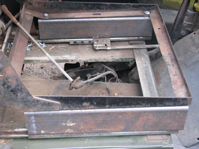

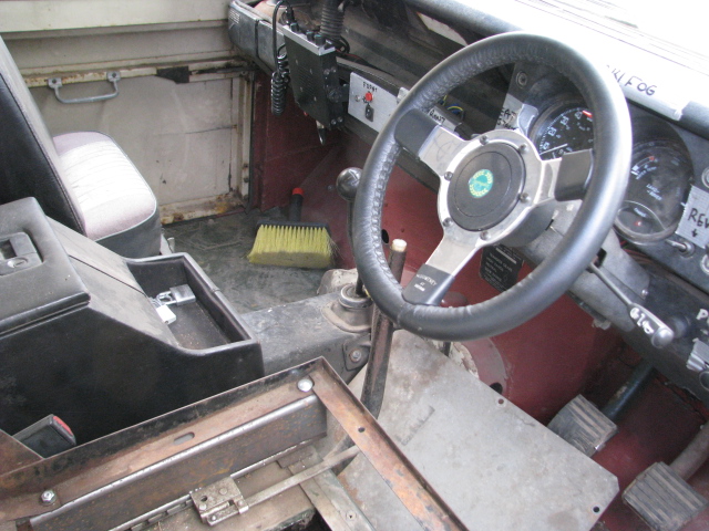

Some modifications have been made to the drivers side so I can fit in and attempt to drive it, leg room, belly room and hight adjustment for the right foot, the artheritis means that I can no longer keep my foot in the position rover dictated.
