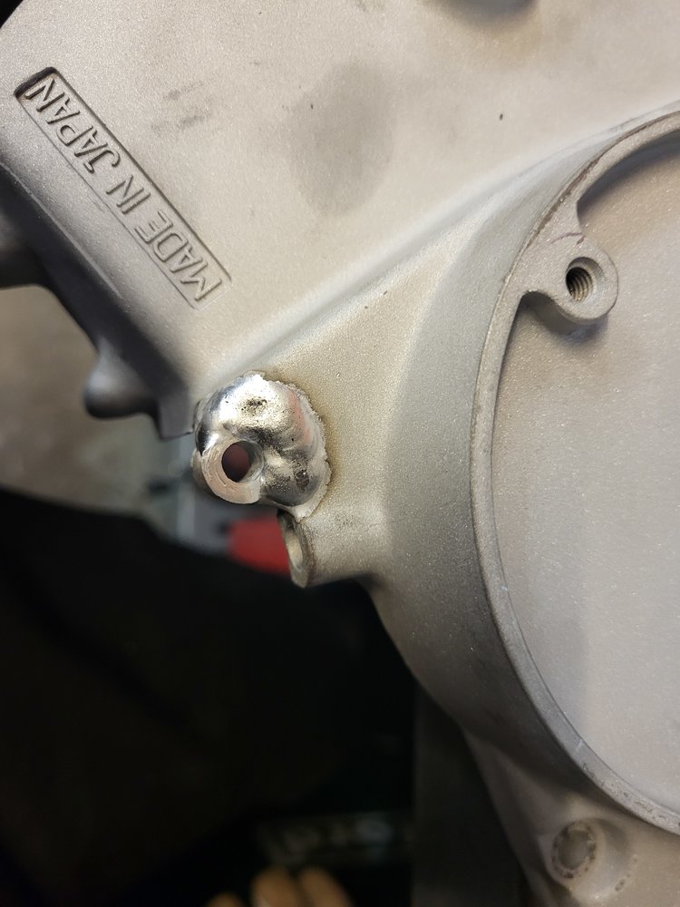

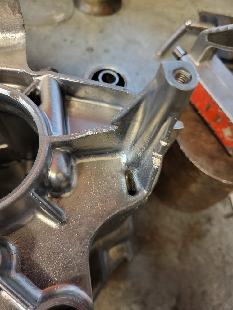

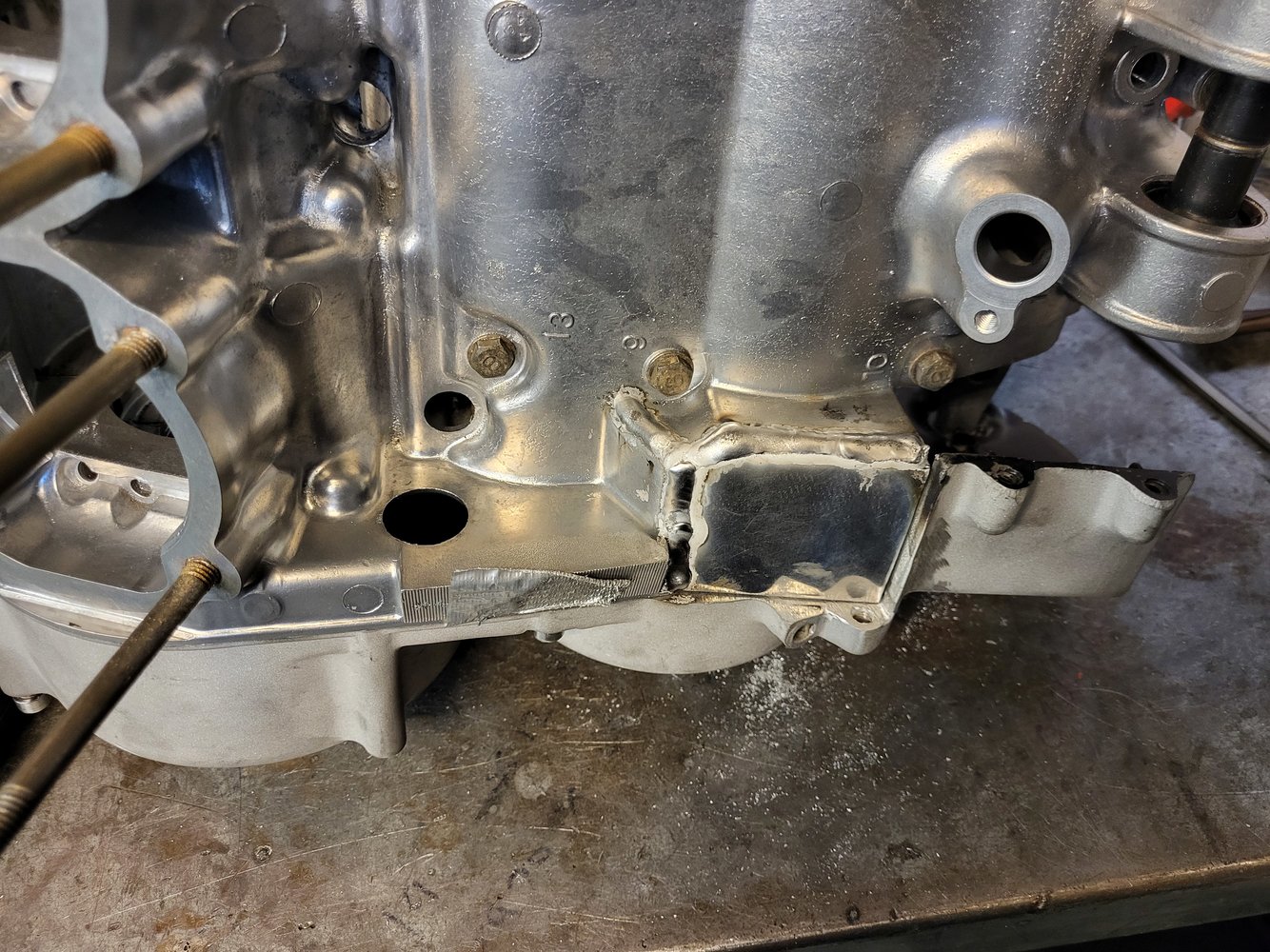

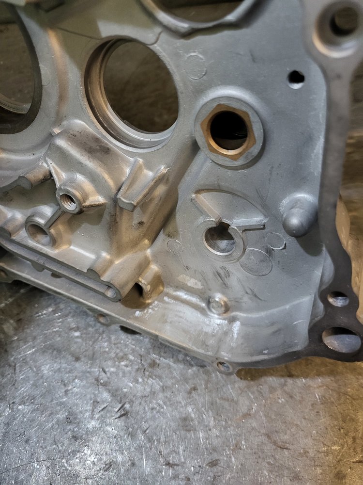

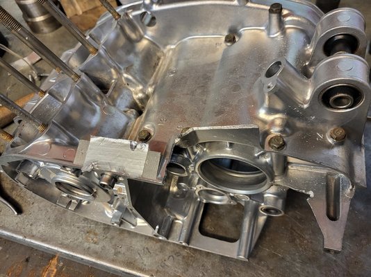

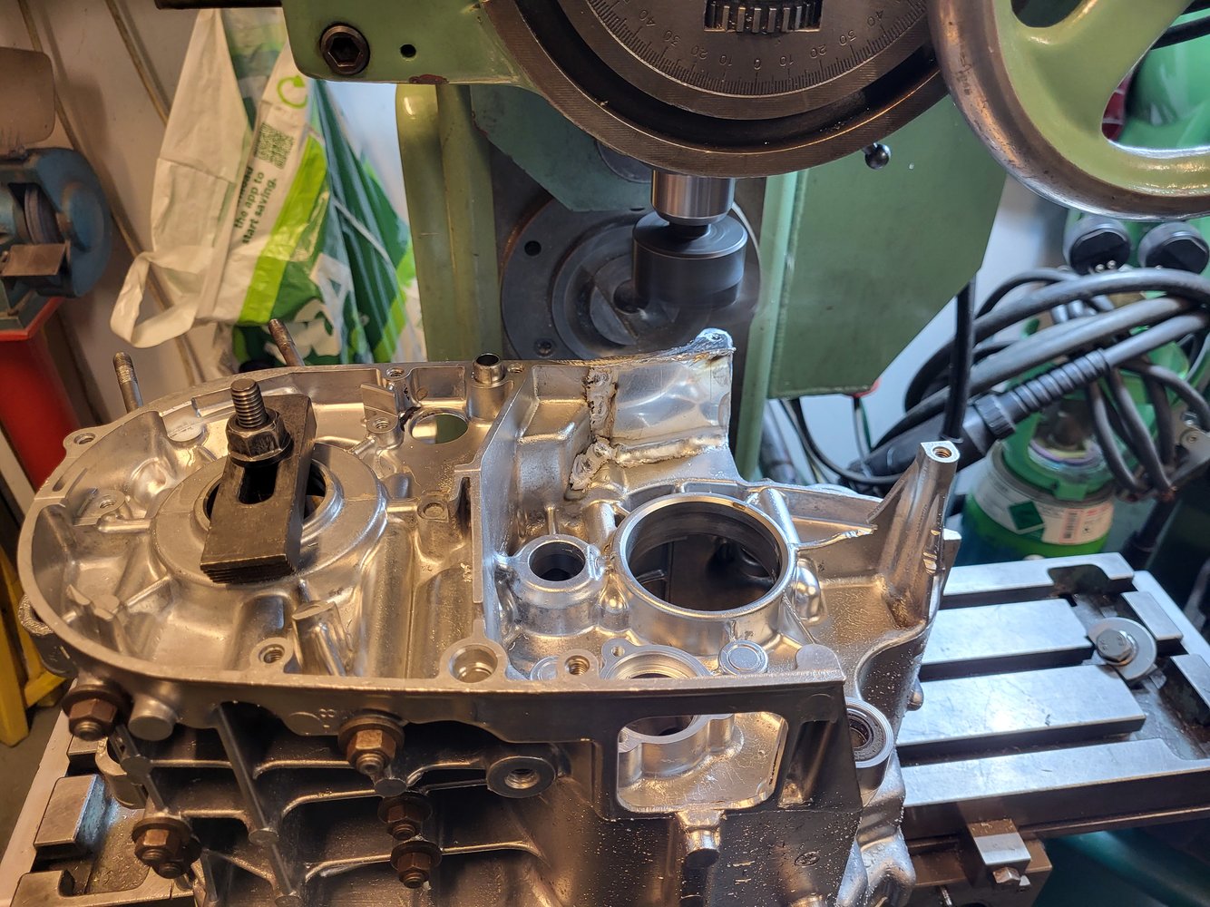

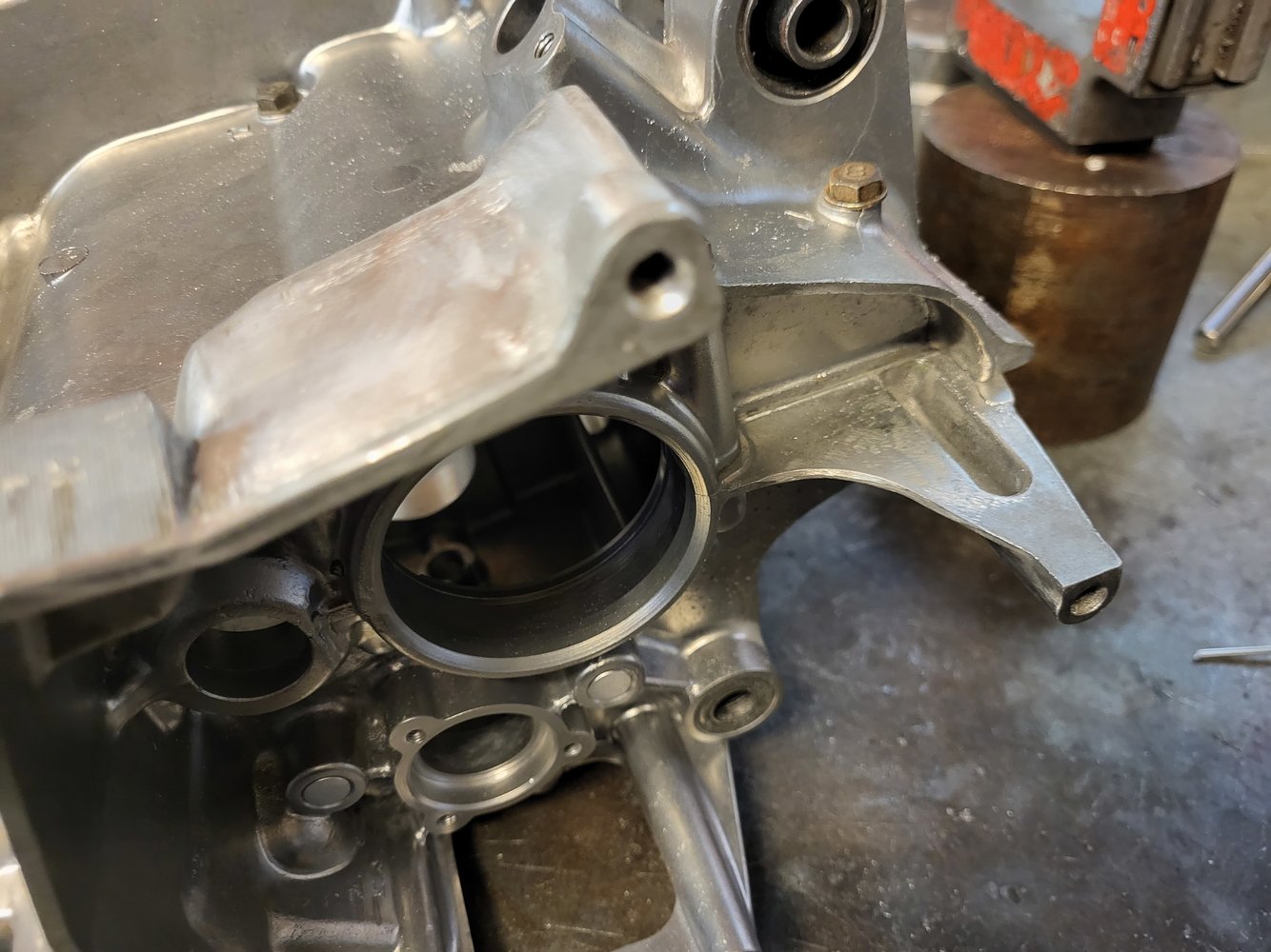

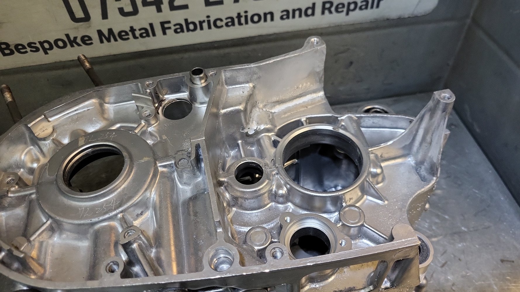

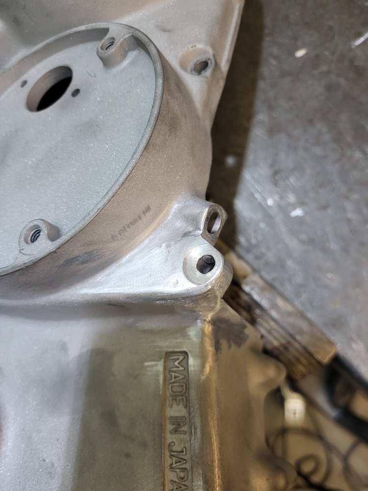

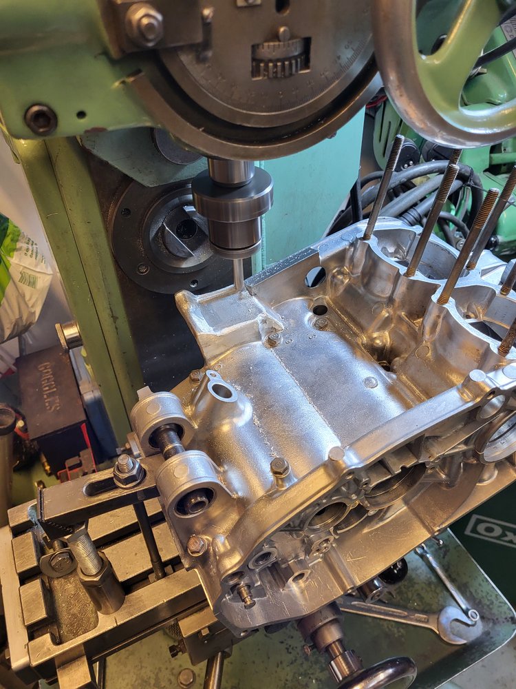

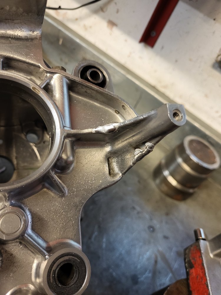

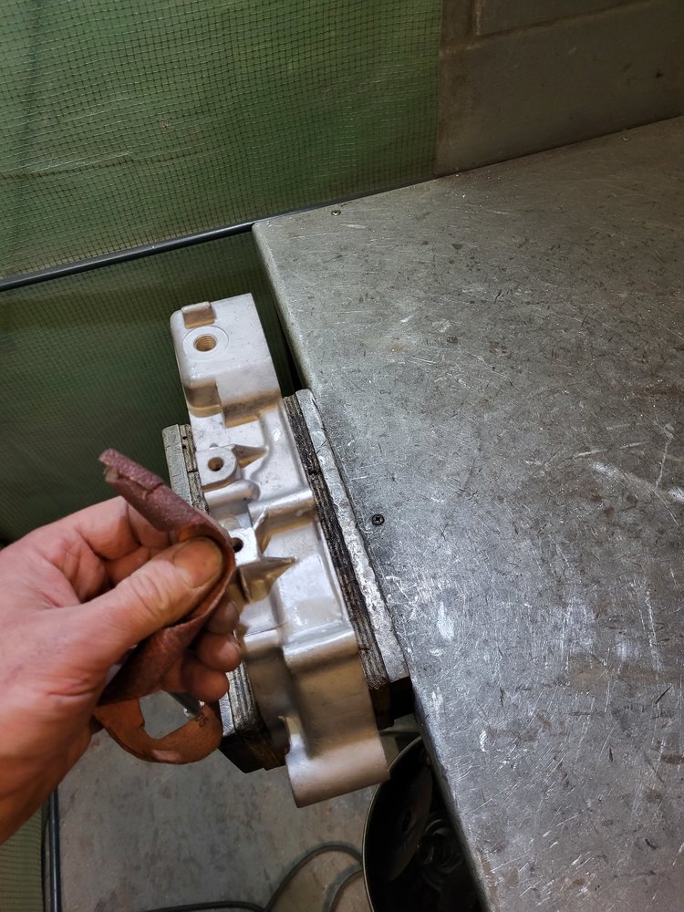

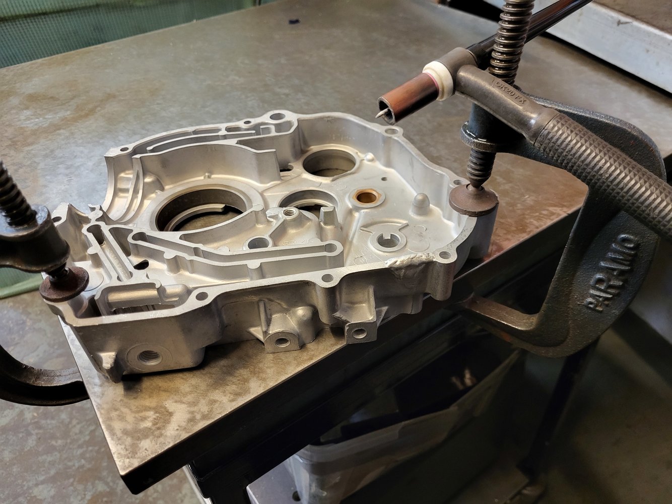

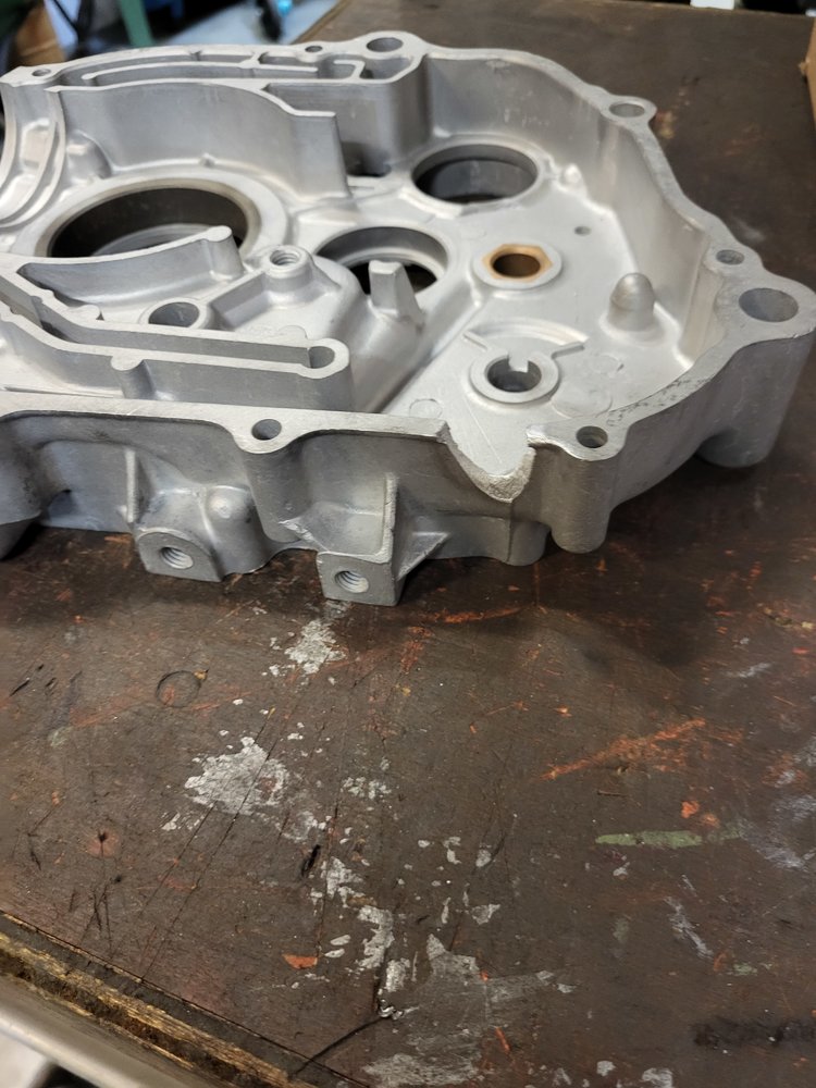

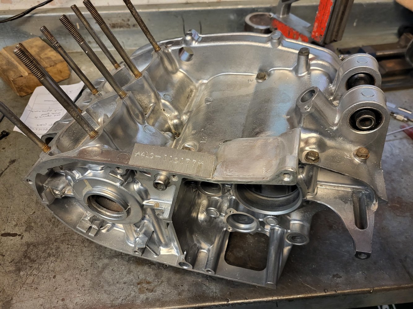

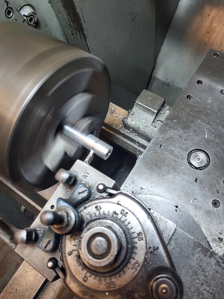

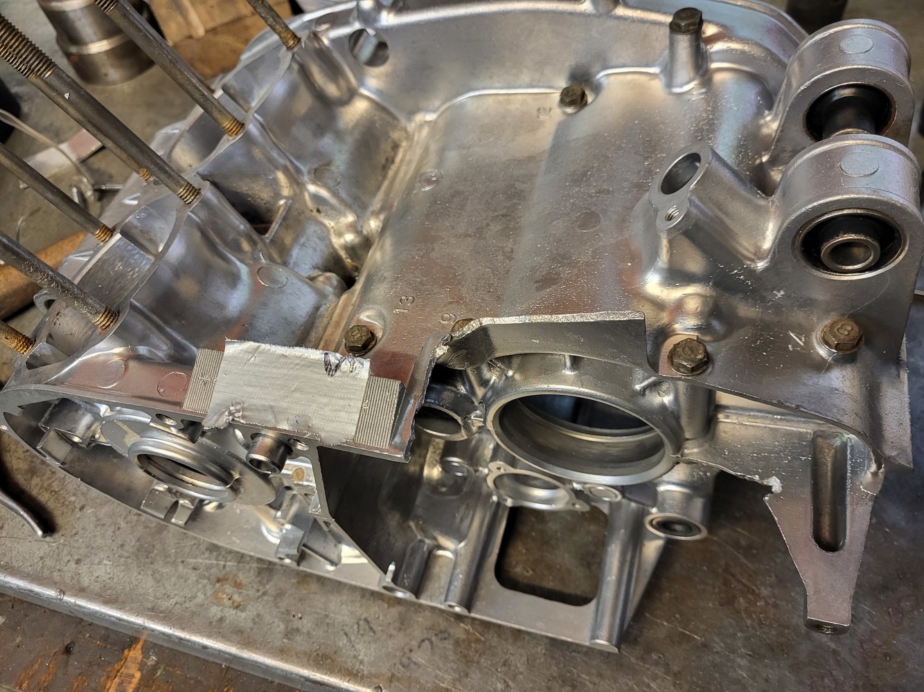

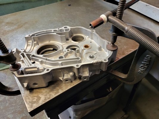

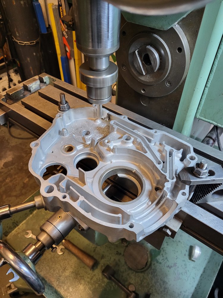

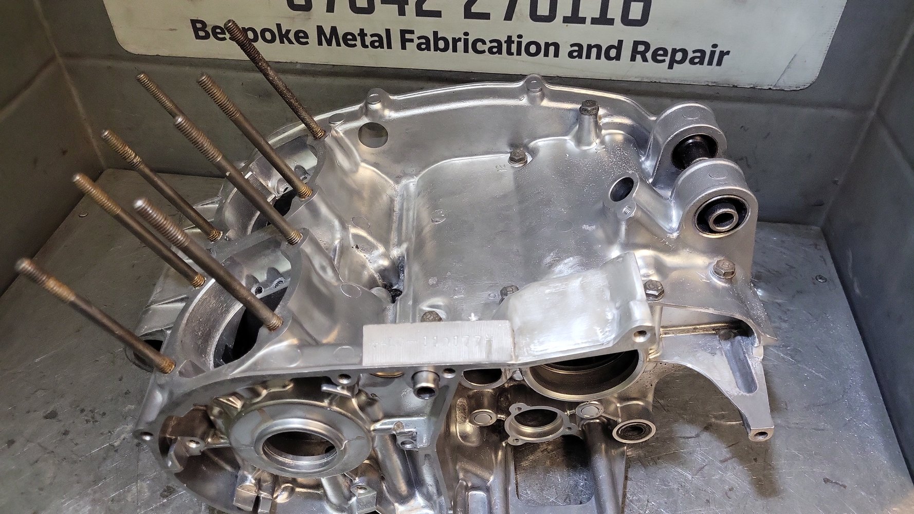

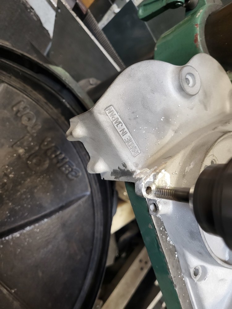

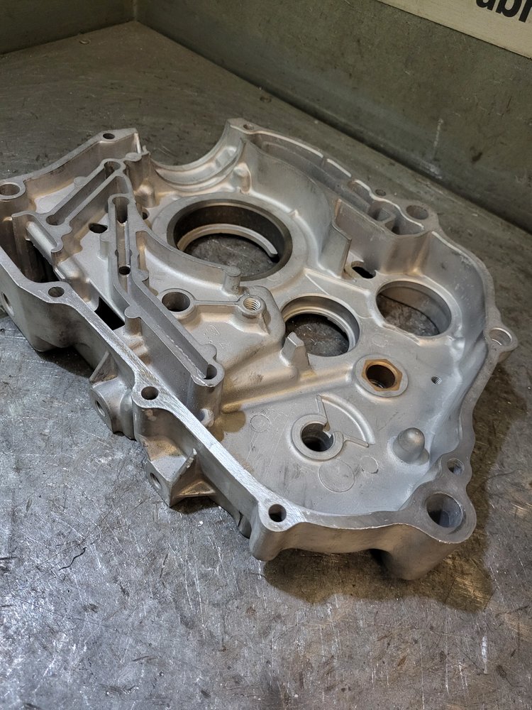

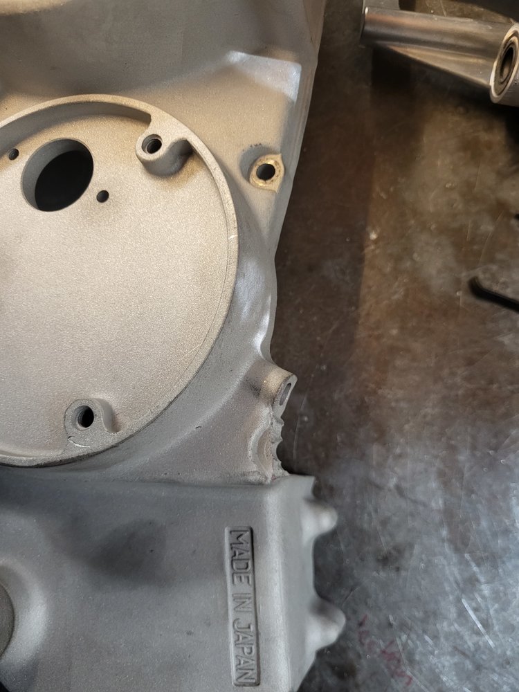

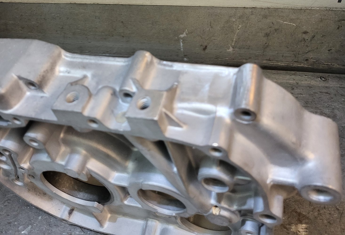

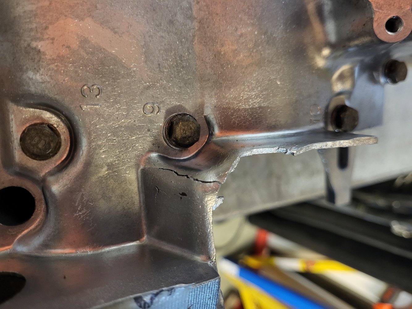

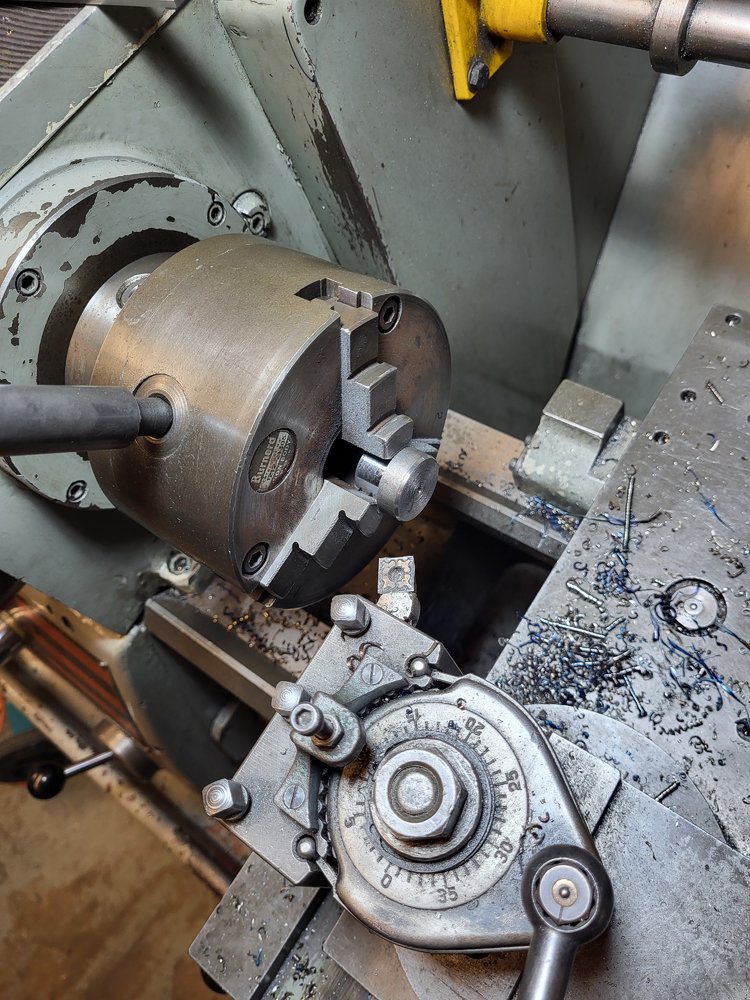

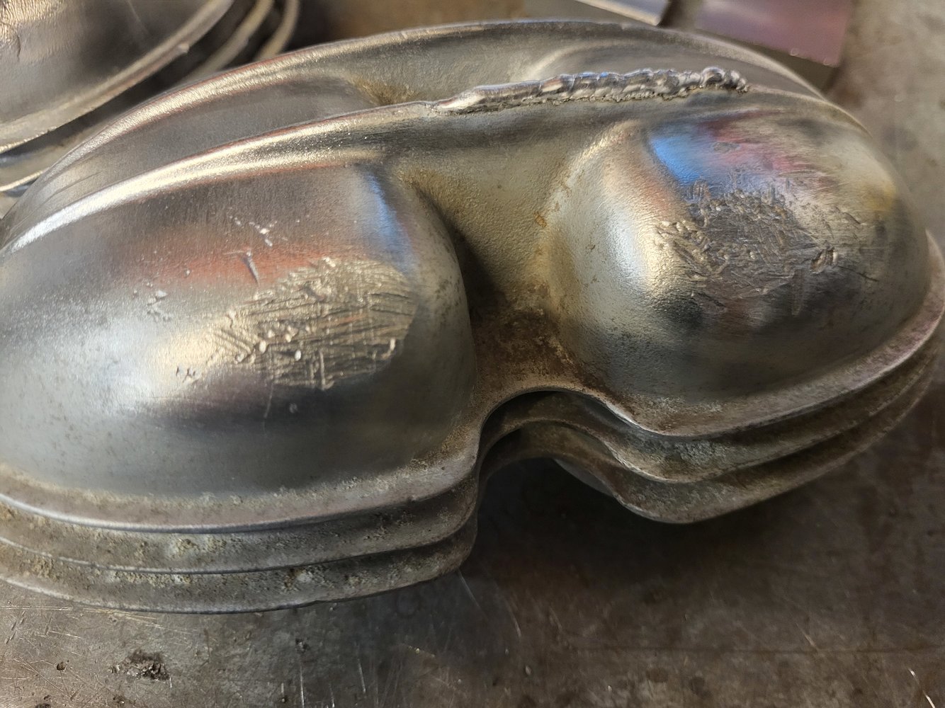

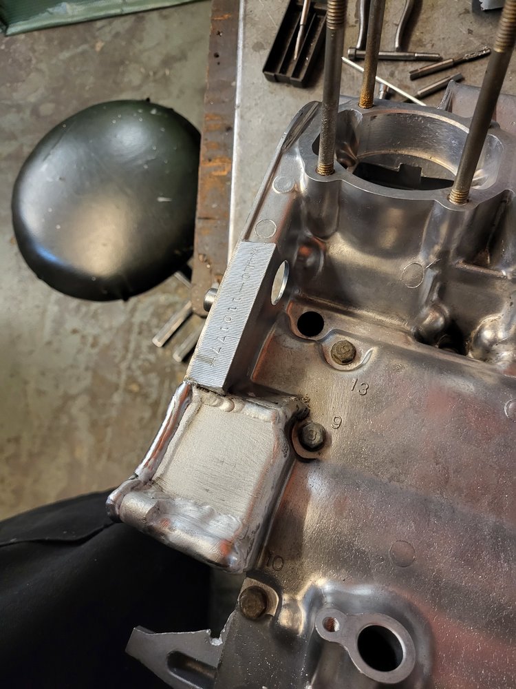

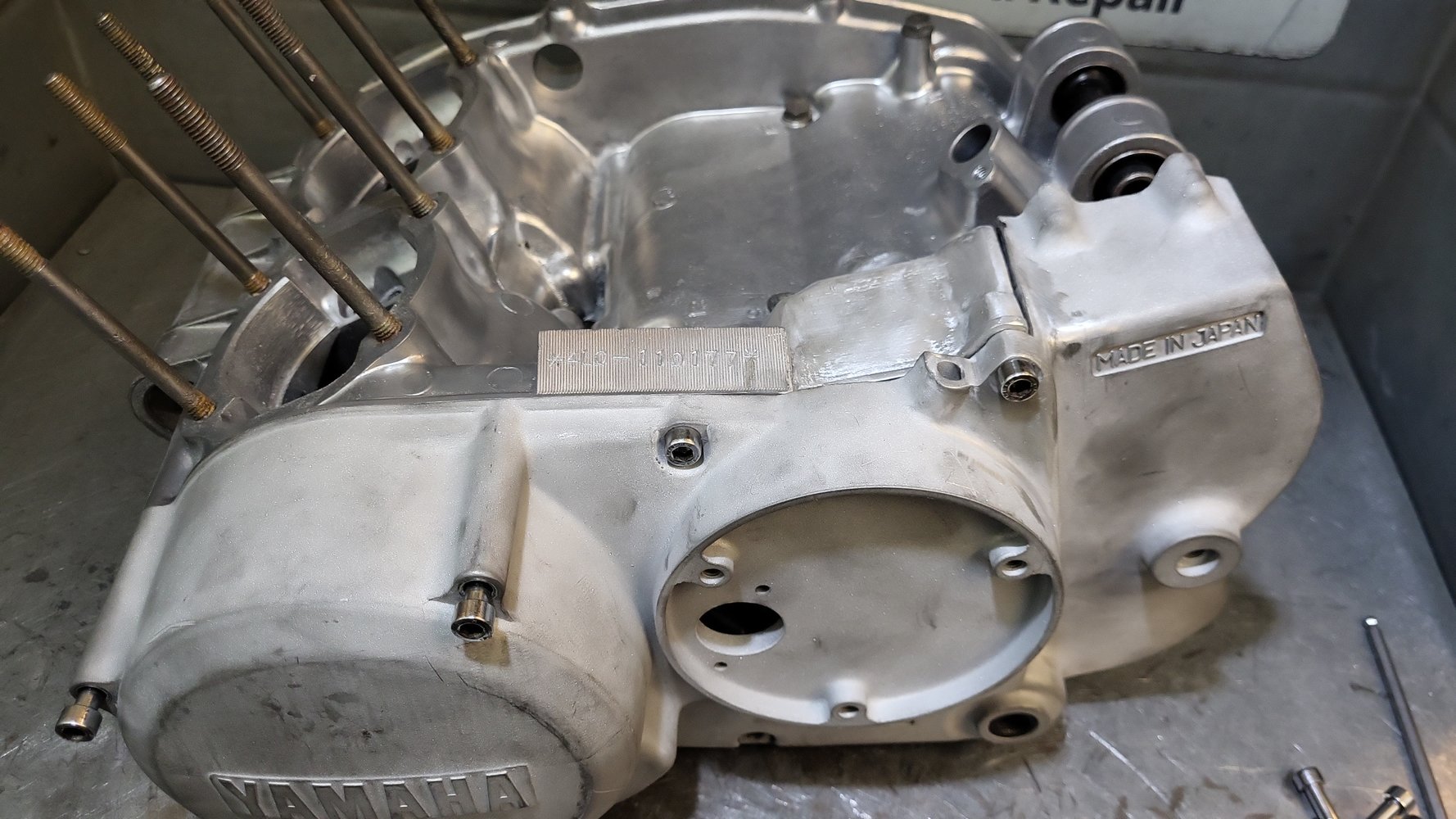

Here's a few repairs I did this week. First one is from an old Honda C90 with a chunk missing from the side. The second one is a common repair I do on the Yamaha RD cases. This particular one is a 4L0 case for a 350cc that had a drive chain fail and it completely destroyed the case around the drive sprocket. The area between the front engine mounts was also smashed off.
As with all the repairs I receive the main objective is to make them look completely original as these are classic bikes and some of them I've done repairs for have won best in show at Stafford.
C90 case first
C90 case first
