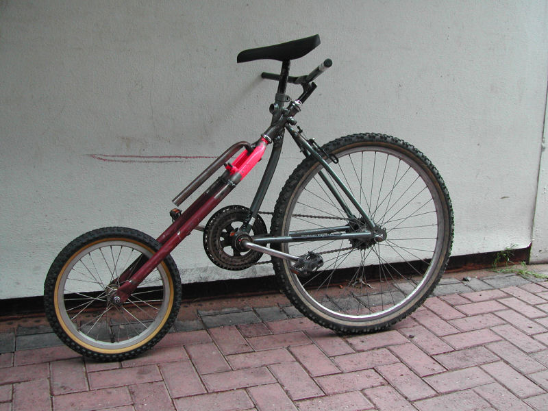

I've worked out it's possible to fit 3.8" tyres between normal mtb cranks and have a reasonably normal chainline without using hideously long chainstays, whilst using a symmetrical 135mm dropout spacing.
I'll need the stays to be no wider than 10mm.
Choices:
Use the front triangle from a cheap frame for the prototype or use 100% fresh metal.
Chromoly or SS (304 or 316, design in an "un-pivot" to avoid mixing at a weld).
Cut and weld rectangular sections or bend oval tubing
My other bike's a Burf special, BTR #7 Bantam but I thought itd be safer to test this idea cheaply first..
