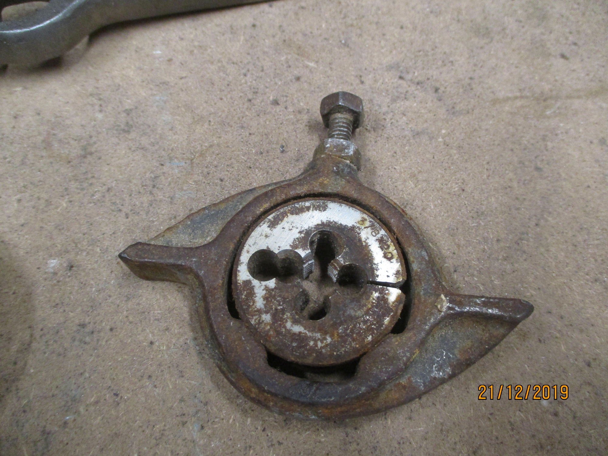

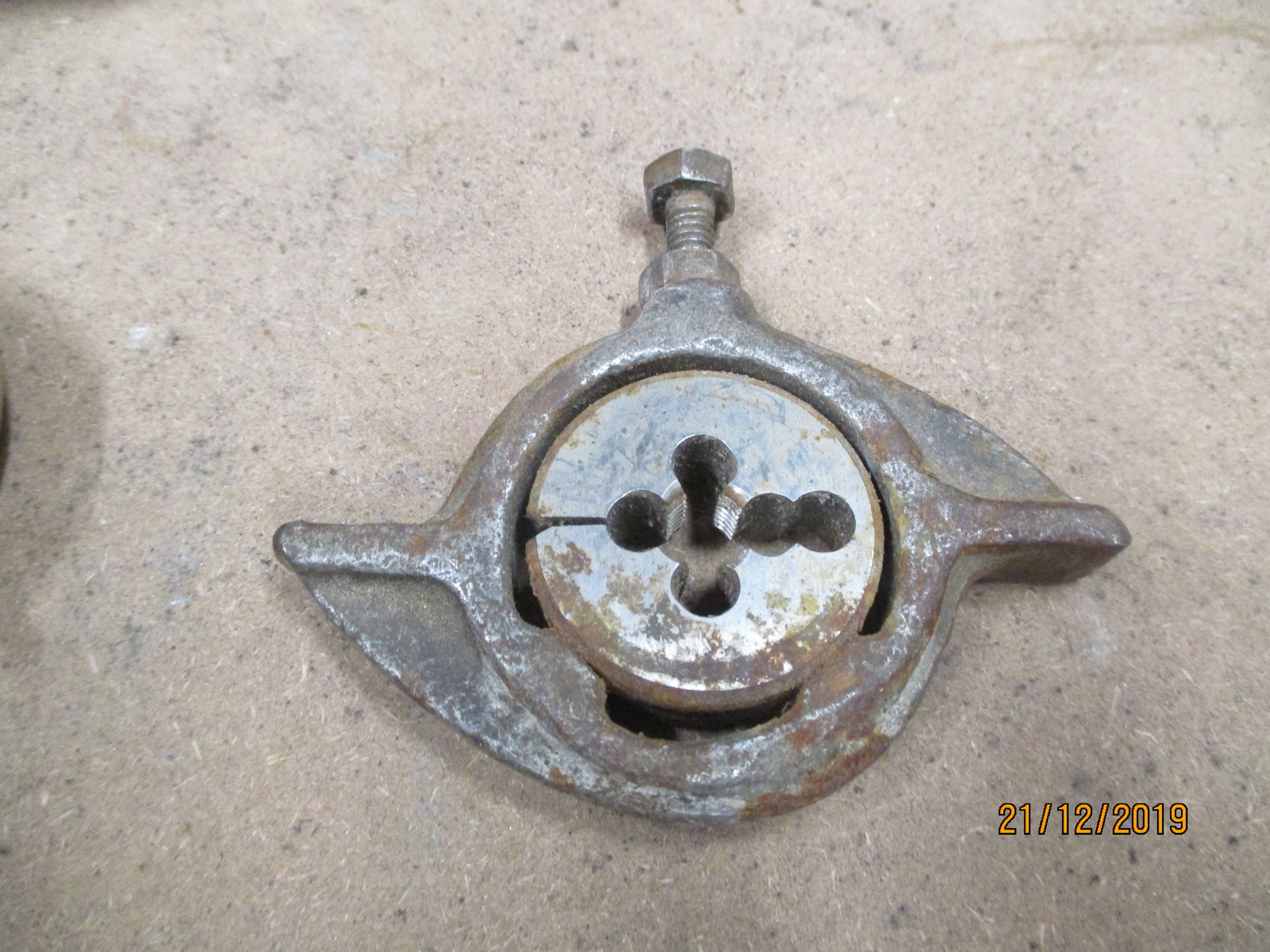

The_Yellow_Ardvark I'm a citizen of Legoland travellin' incommunicado Messages 20,402 Location Going Away. Dec 22, 2019 #1 I was given this the other day. I not seen a Die holder like this. Can any one give me some information on how it is used?

slim_boy_fat Member Messages 29,186 Location Scottish Highlands Dec 22, 2019 #2 Looks like it's for cleaning up threads, rather than cutting new ones. Designed to be turned by hand.

E earthman Member Messages 1,534 Dec 22, 2019 #3 slim_boy_fat said: Looks like it's for cleaning up threads, rather than cutting new ones. Designed to be turned by hand. Click to expand... That would be my guess too, looks like it would come in handy in tight spaces, maybe exhaust studs for example??

brightspark Member Messages 41,676 Location yarm stockton on tees Dec 22, 2019 #4 probably used with a tube with a t bar to turn it and pins on the end to engage the flats. as said probably for cleaning threads out as it wouldn't back off for cutting threads
