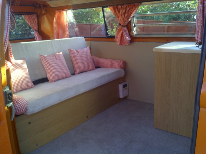

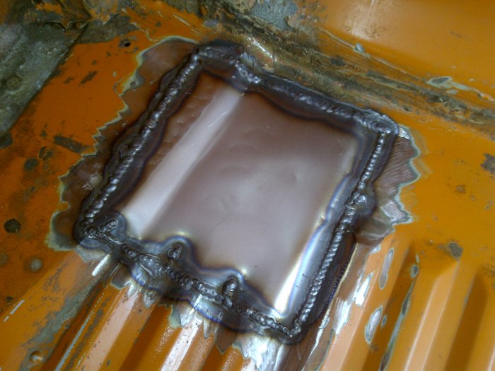

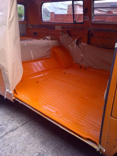

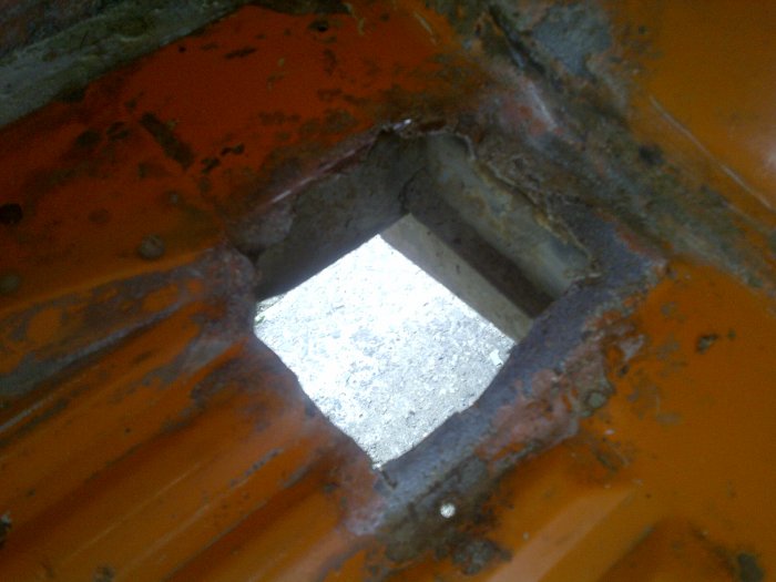

Thought I'd share some work I've been up to
Some clown butchered a hole in my cab floor, so i thought I'd patch it up, treat and repaint the floor
Ended up rebuilding the whole interior
It's 1mm sheet from a motor panel factors, i think it helped i was welding from above, no real secret just the stop start technique
