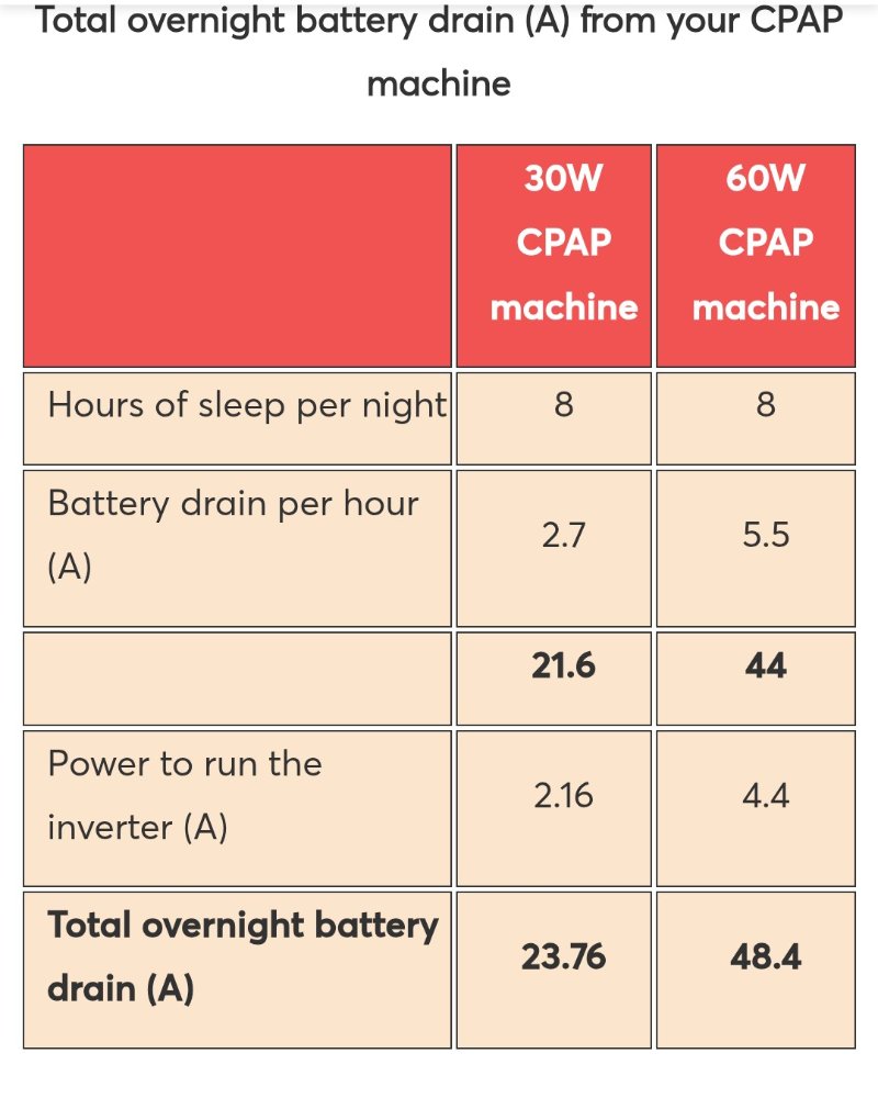

I need to run a medical device (CPAP Machine) in the motor home.
I was going to install a separate 12v leisure battery to power it, this will be charged when the vans on hook up or when I remove the battery at home.
The manufacturer quotes AC power consumption100-240v 50/60Hx, 2.0-1.0A
I have tried to email for the 12v load but as yet no reply.
So any thoughts on what power it would be around 12v and what size battery would be required used for a max of 3 days 12 hours a day when off grid?
