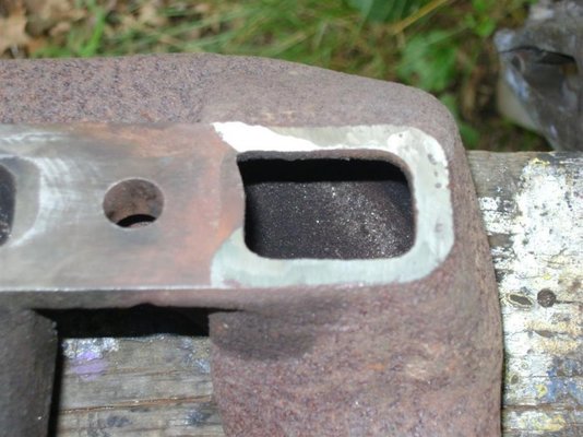

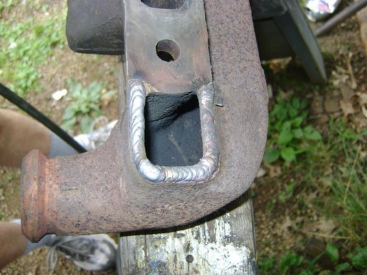

That crown alloys cast iron mig wire sure has a place in my heart for jobs that might be a little tough with a stick. Not saying they can't be done with a stick but the time factor is a big savings. My neighbor has a 9N with a leaky manifold. It was blown out on the end and he wanted it built up. 1 minute job with my mig. No preheat just ground it clean and triggered a bead around the bad area. Tomorrow he is going to hand file it down with the biggest file i have ever seen...Bob
