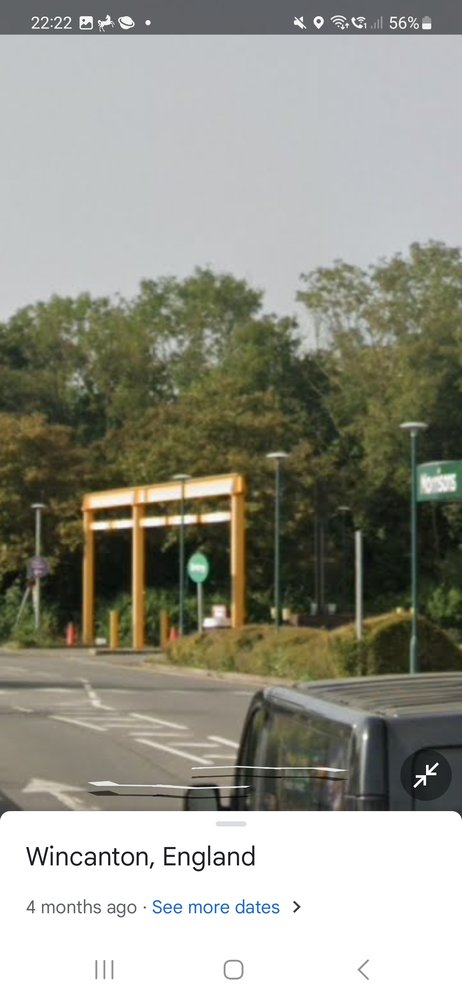

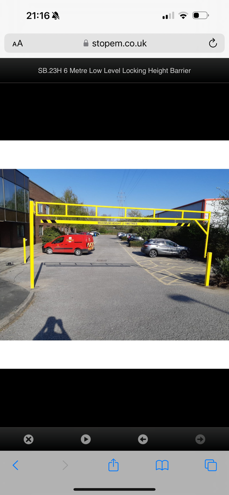

Anyone ever seen one as long?
Longest i can find online is a 6m one made of what looks to be 40 or 50mm box section.
I'm wondering what the engineers among you think. Lightweight section in a truss style something like this. 50x50x4 perhaps
Or one heavier box section with a very shallow angle diagonal support. Maybe something like 80x80x5
.... though equally it could be done from either side with a centre receiving post for both barriers?).
