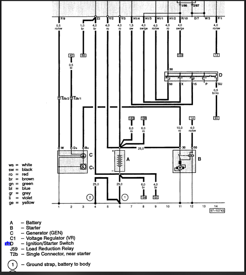

Had the alternator professional rebuilt with top quality components last August. Had to be brought home by the AA at the weekend as it was flashing the oil light, when you turn the ignition on the Batt light doesn't come on as it should? When the engine starts it's not charging, cant see any damaged wires, going to look again tomorrow.
So where does the Blue and red alternator wires go to? Hoping to bypass them and if its the fault replace them.
