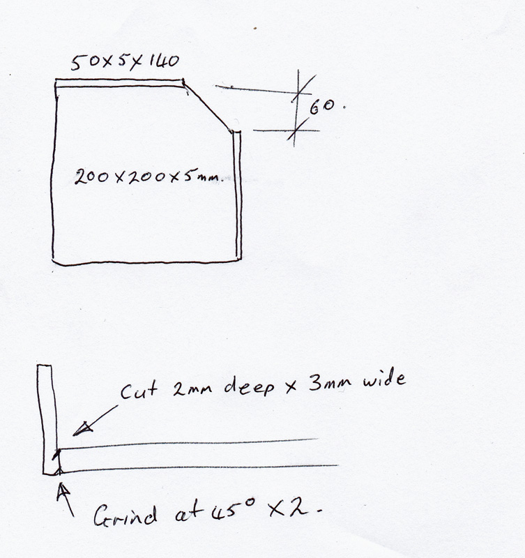

I intend making a jig to help me weld pieces at exactly 90 degrees. I know you can buy such a thing and it is much better that anything I can make, but there's no fun in that plus this will cost me nothing except electricity, gas and wire.
Basically it involves a piece of 200 X 200 X 5 mm flat with 2 pieces of 50 X 5 mm X 140 mm long welded as shown below. When finished you simply place 2 pieces of (say) 35 mm X 35 mm RHS against the sides and clamp in position knowing they will be exactly 90 degrees.
My question is mainly to do with the bottom drawing ............. should I grind the edges off at 45 degrees for added penetration, and to help weld the internal corner I thought I could cut a groove to allow the weld to get in without building up too much. RHS would sit in there no problems because the external corners are radiused, but some material are a sharp 90 degrees, and any weld would prevent it sitting in the jig properly.
