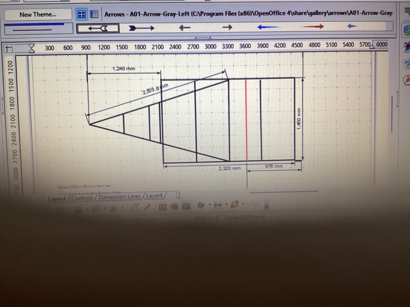

I am just about to start making a trailer. A teardrop but something that looks right behind a landrover. It will need to be IVA tested and hopfully under 750kg although I will be fitting a hand brake.
Im looking for advice on steel for the chassis. I need to kerp the wright down but also want it safe.
Does anybody know the thickness of the steel that Phoenix trailers use. They look quality.
Im thinking of 70mm x 50mm x 3mm box for the tongue and 70mm x 40mm x 2.5 for the chassis rails.
Any advice gratefully accepted.
