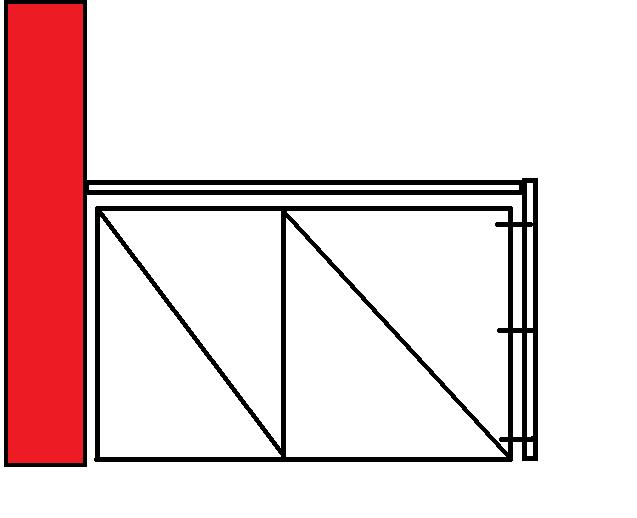

I need some advice on building a 2400 x 1200 single gate,
i know its slightly on the large side but i need it to be in one piece purely because i need the extra 6 inches to squeeze my truck down the side of my house.
I just need some advice as to what materials to use? Angle Iron? box section?
i worried about weight of the gate and have already bought a sprung jockey wheel as it will run over concrete. i was also planning on using a steel post i can fix to my house wall.
So if anyone has any advice or opinions please fire away

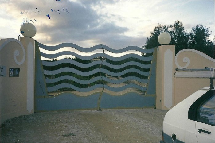

They are 5mtrs wide & 2.5mtrs high. The 'hinges' are taper rollers (ex. Renault 4 rear hubs) at the bottom and sealed ball bearings at the top. You can move them with a finger.
