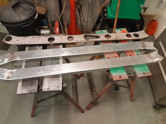

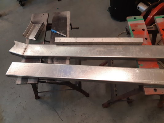

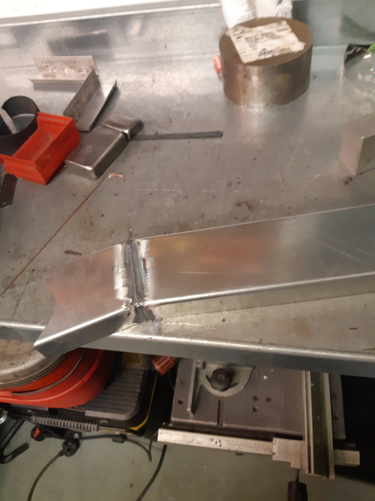

Evening all, today's little job was to make a pair of erm.....

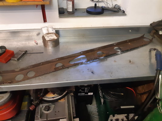

It think it is part of the chassis from ww2 jeep.
So off we go....

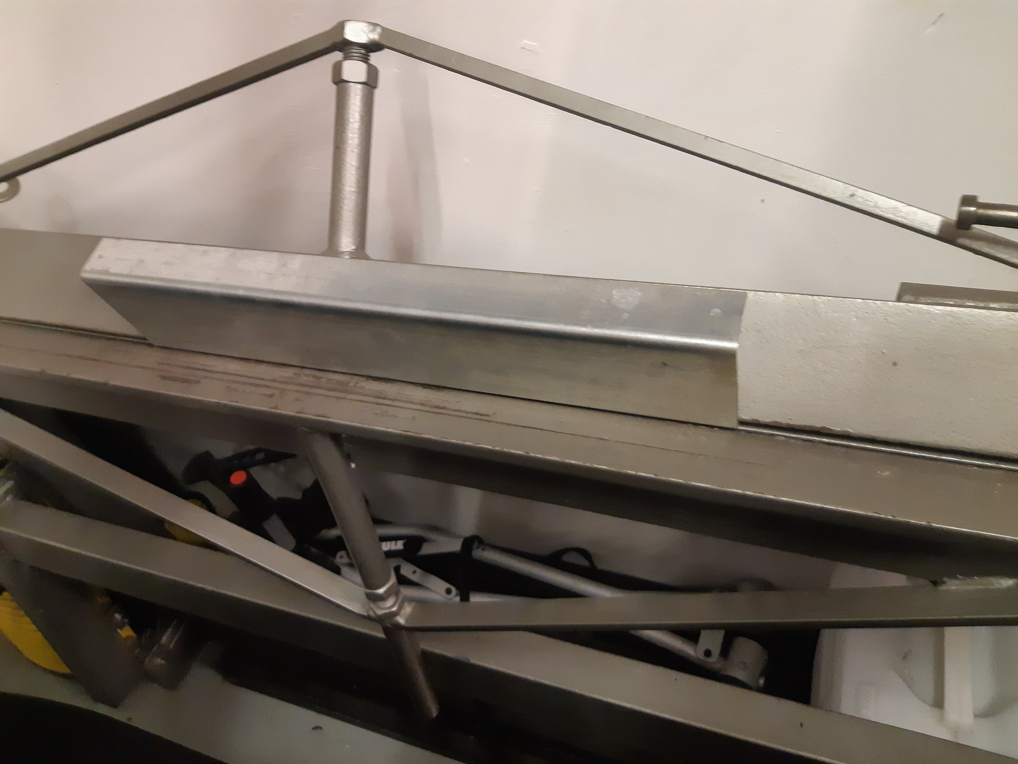

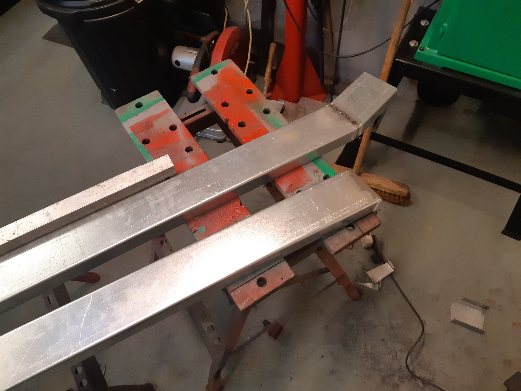

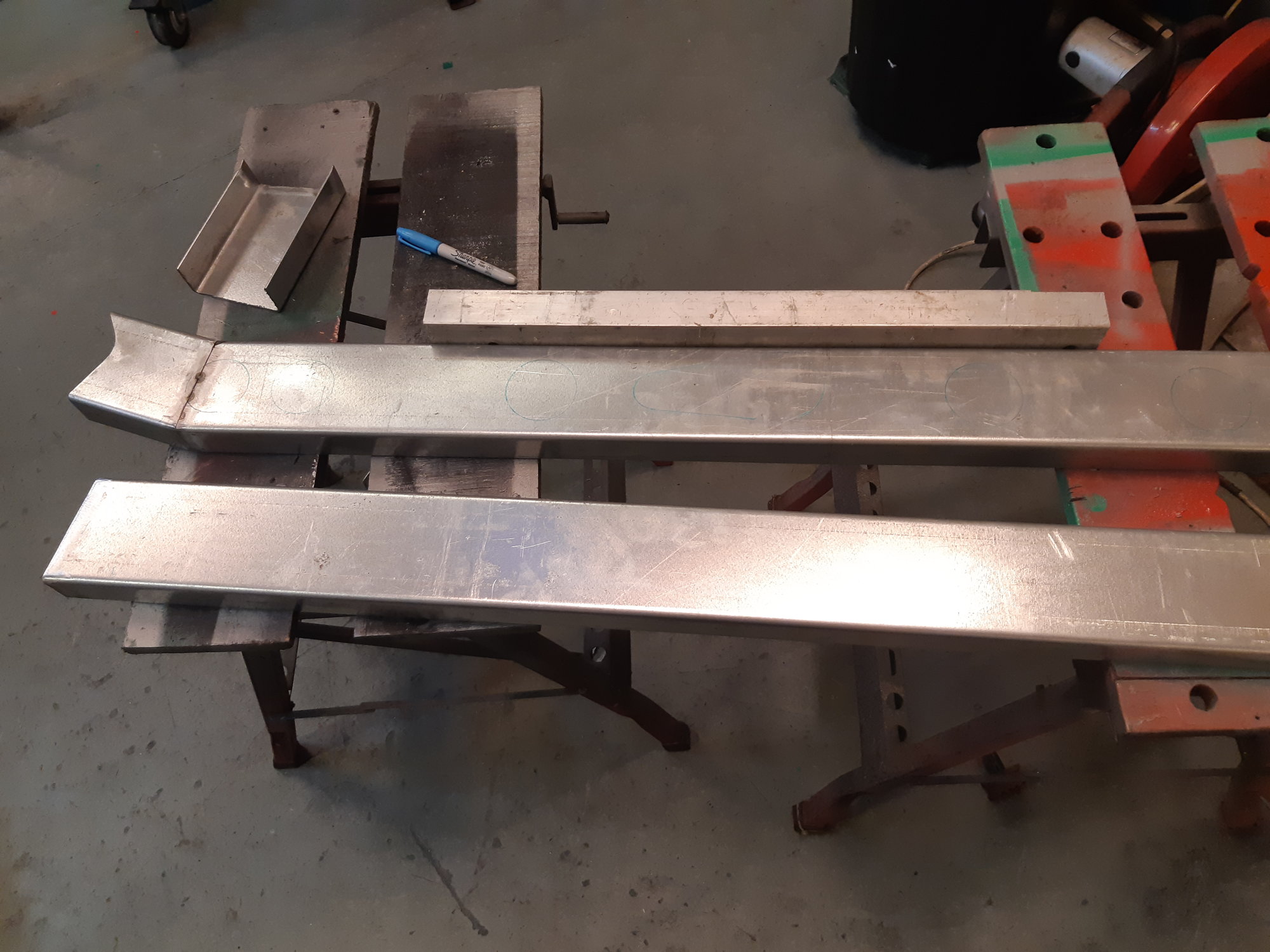

First I cut some sheet and did a test bend to check dimensions.
All was good so I bend the pieces full length.

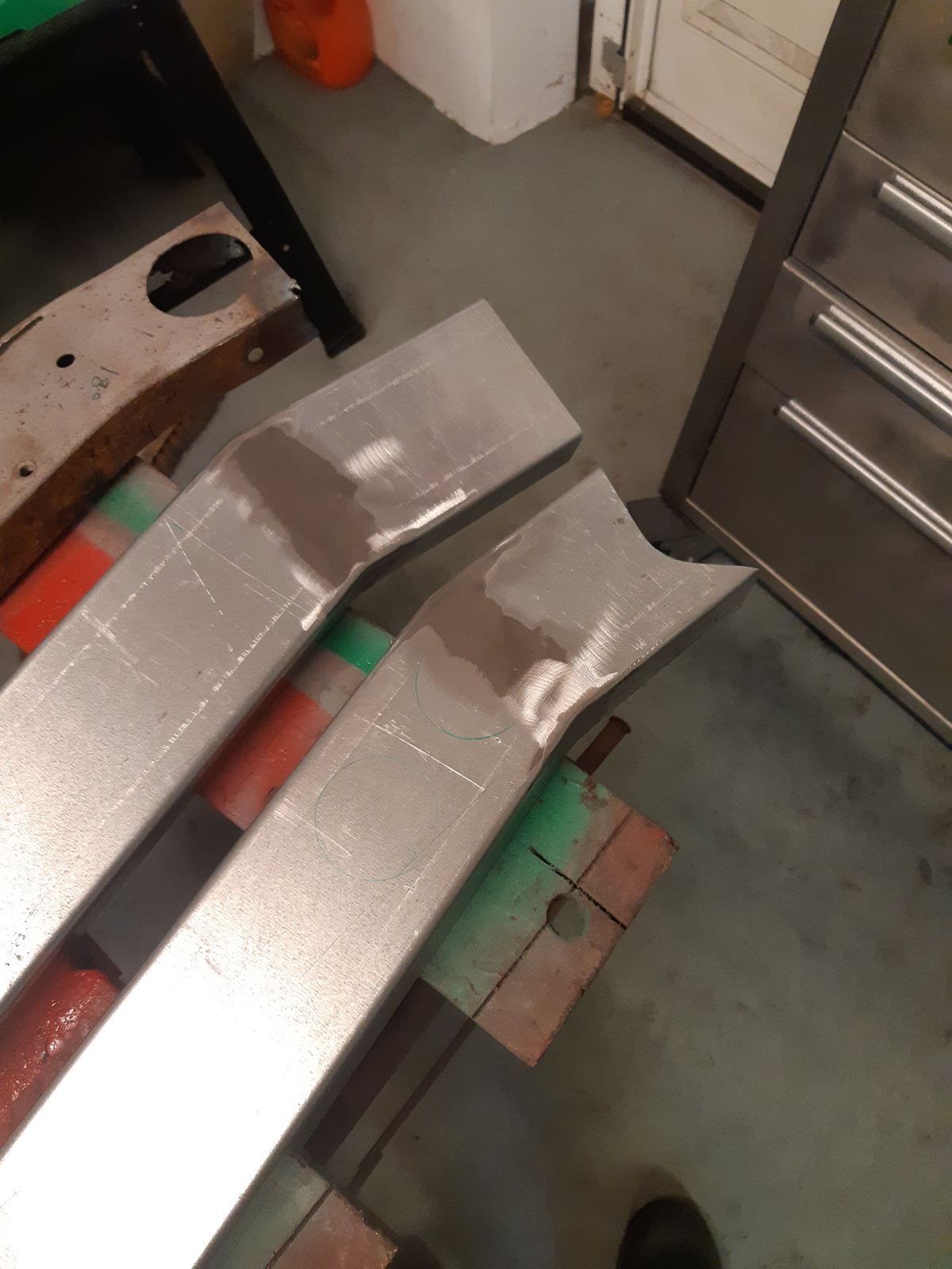

They then needed a bend at each end. One is 18 degrees and other 15.7
So off we go....
