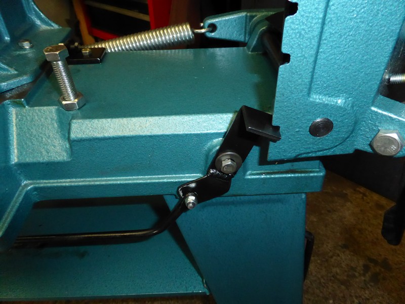

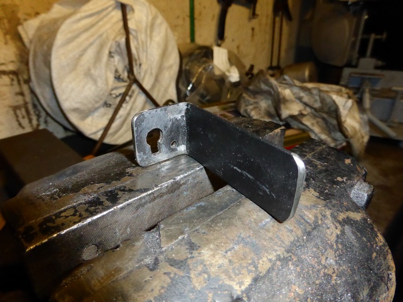

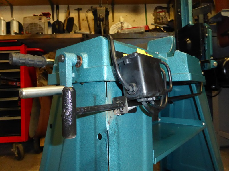

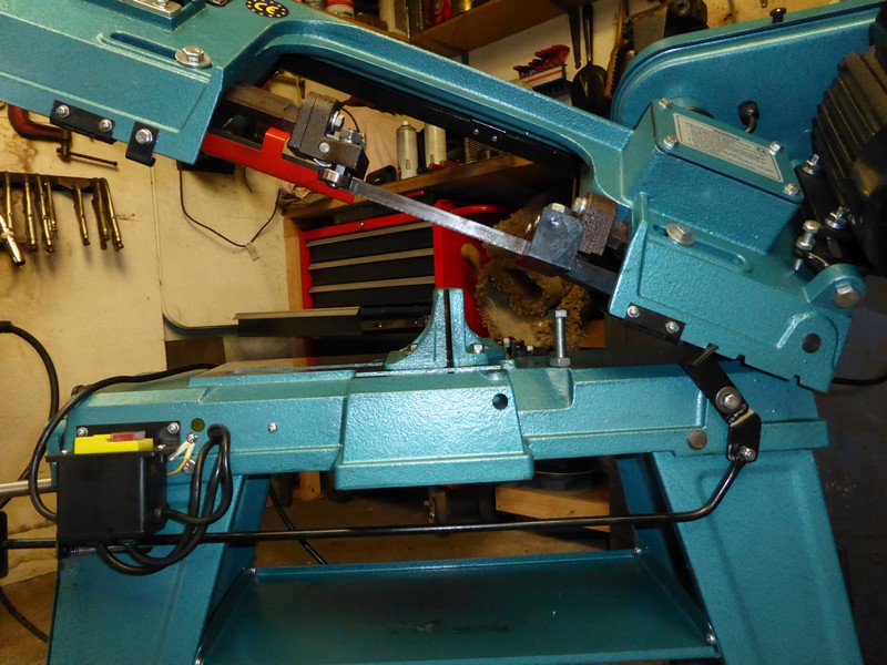

Just got myself a 6X4 Bandsaw so looked how to improve it a little.
I know these bandsaws have been modded before but I've not seen this mod before so hope it helps others who like the mod.

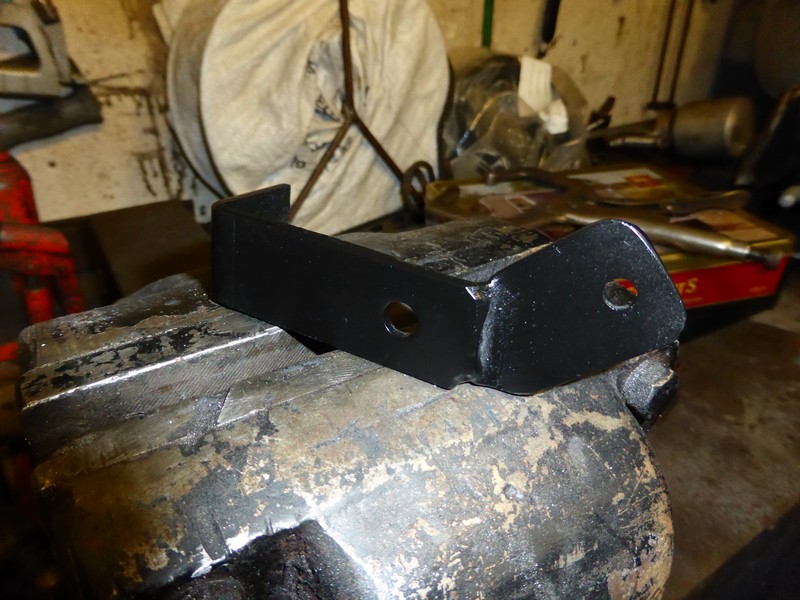

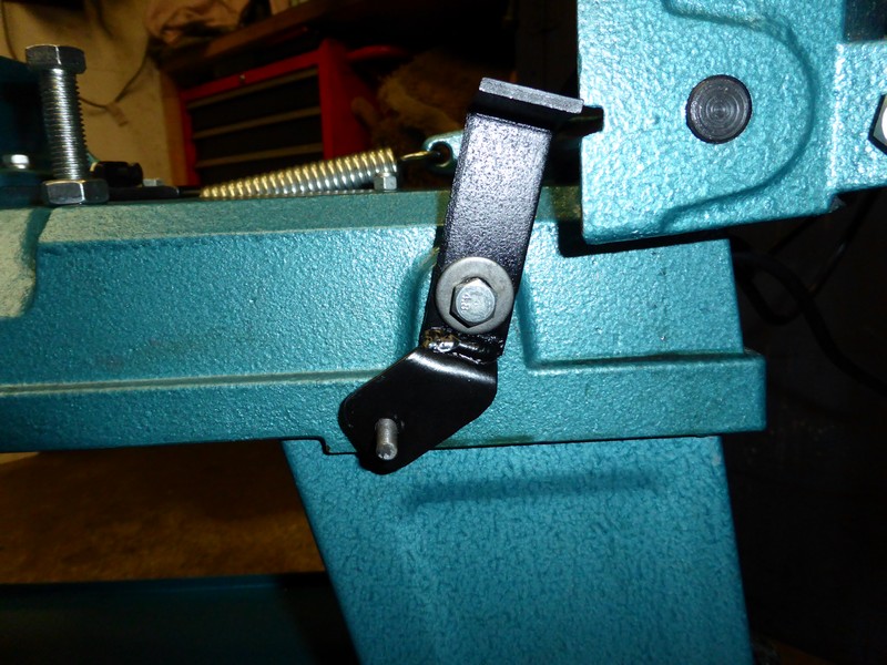

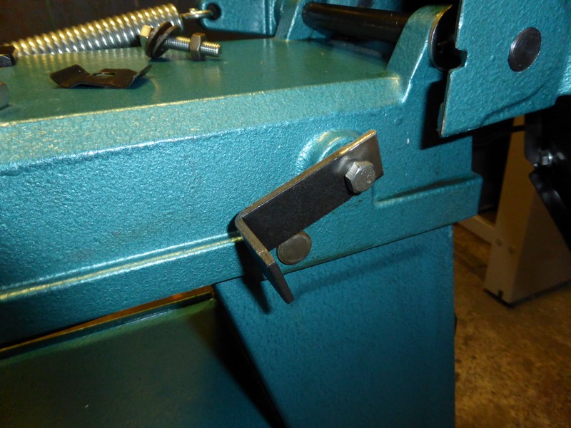

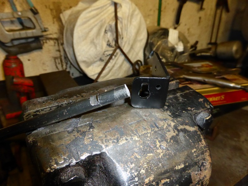

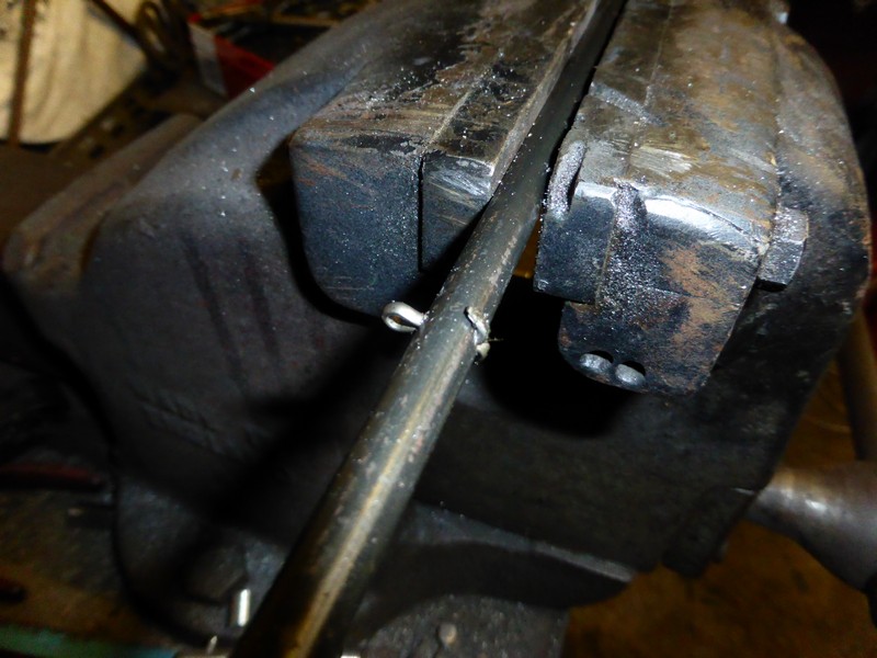

When you need to load stock for cutting you have to hold the blade up and manually make it safe with the rear latch so decided to make this automatic making it much easier and safer, any way here's the pictures
I think it was still a bit hot for spraying
The latch is spring loaded so it automatically engages the latch on lifting the arm up and all you do is push the rod to disengage the latch and if you don't want to use the latch it can be locked in the down position
Hope you liked the mod
