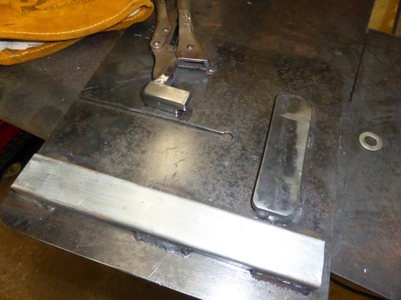

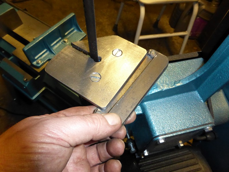

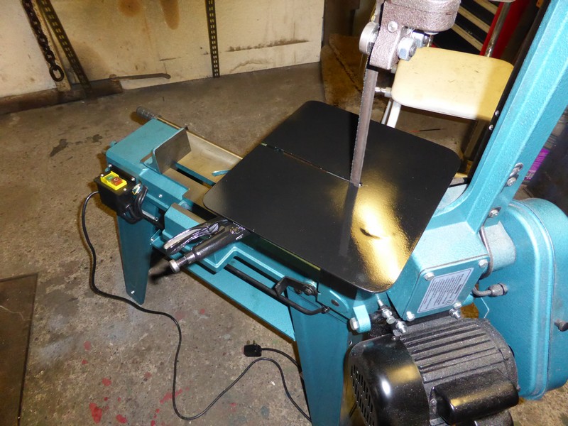

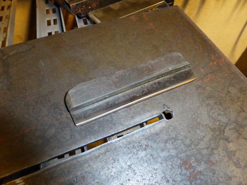

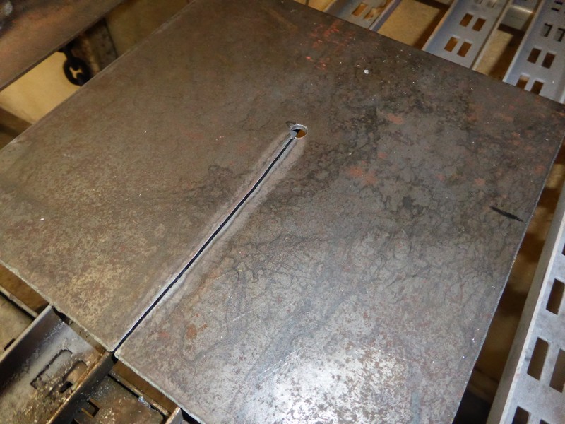

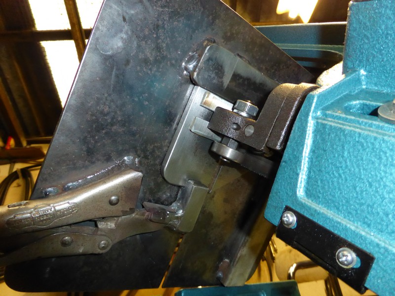

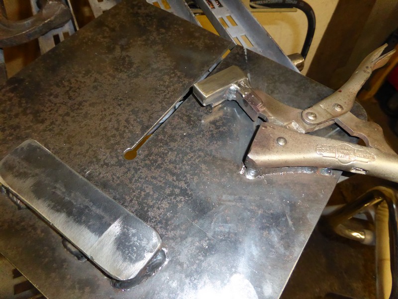

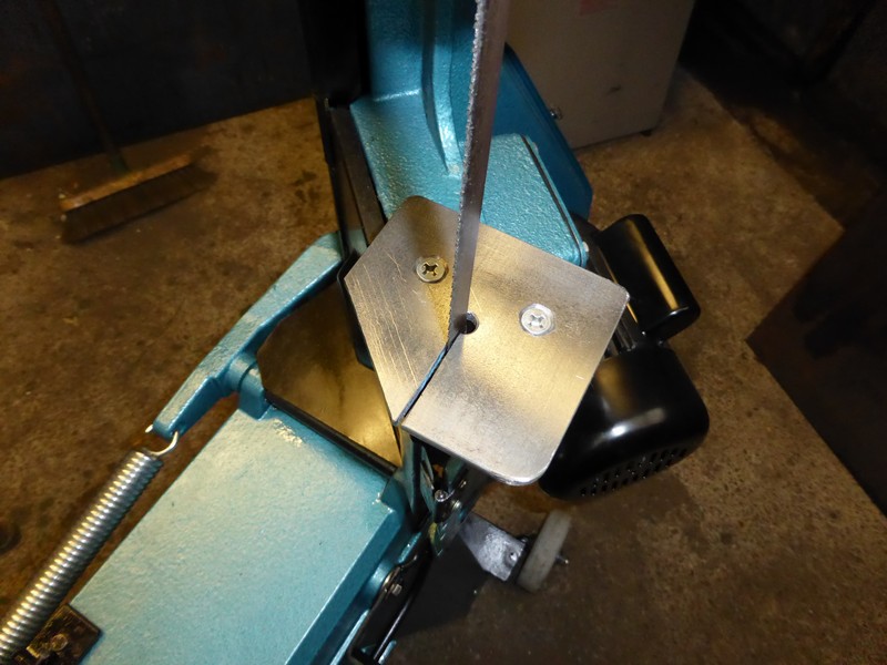

This is the bandsaw vertical table mod it may be a little different from others it’s easy to put on and take off just using one lever
I’ve put a small table on the saw first which can be used as it is but then made a larger table with a quick release mechanism made from a pair of mole grips welded to the underside of the table these push and lock the table into a bracket also welded to the underside of the table they both lock onto the small table I mentioned earlier
Hopefully the pictures with clarify things hope you enjoy the mod and have ago at making one yourself.
reinforcing bar welded to base
