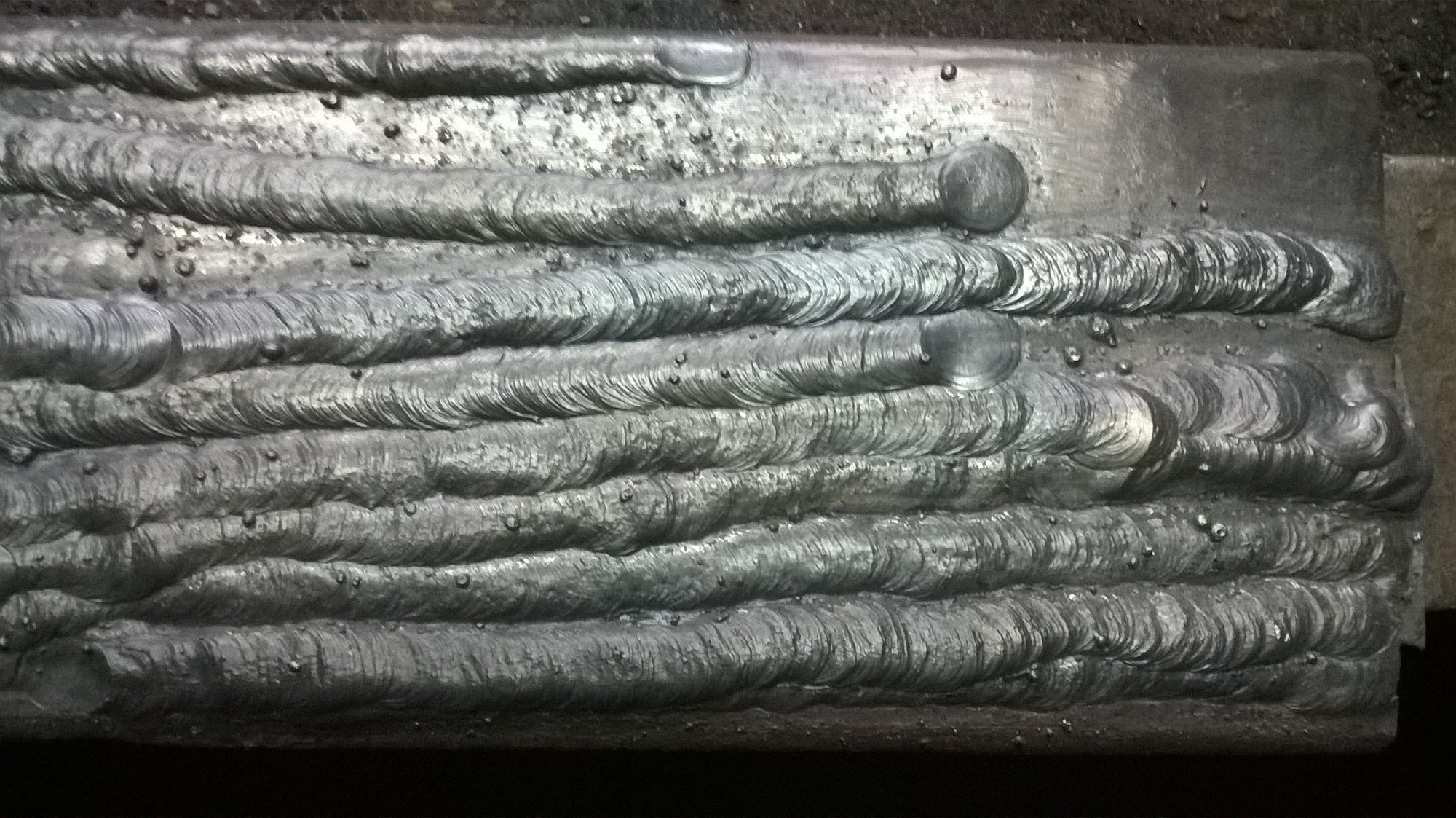

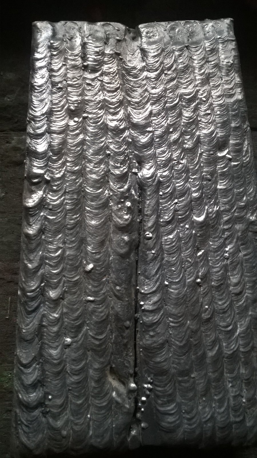

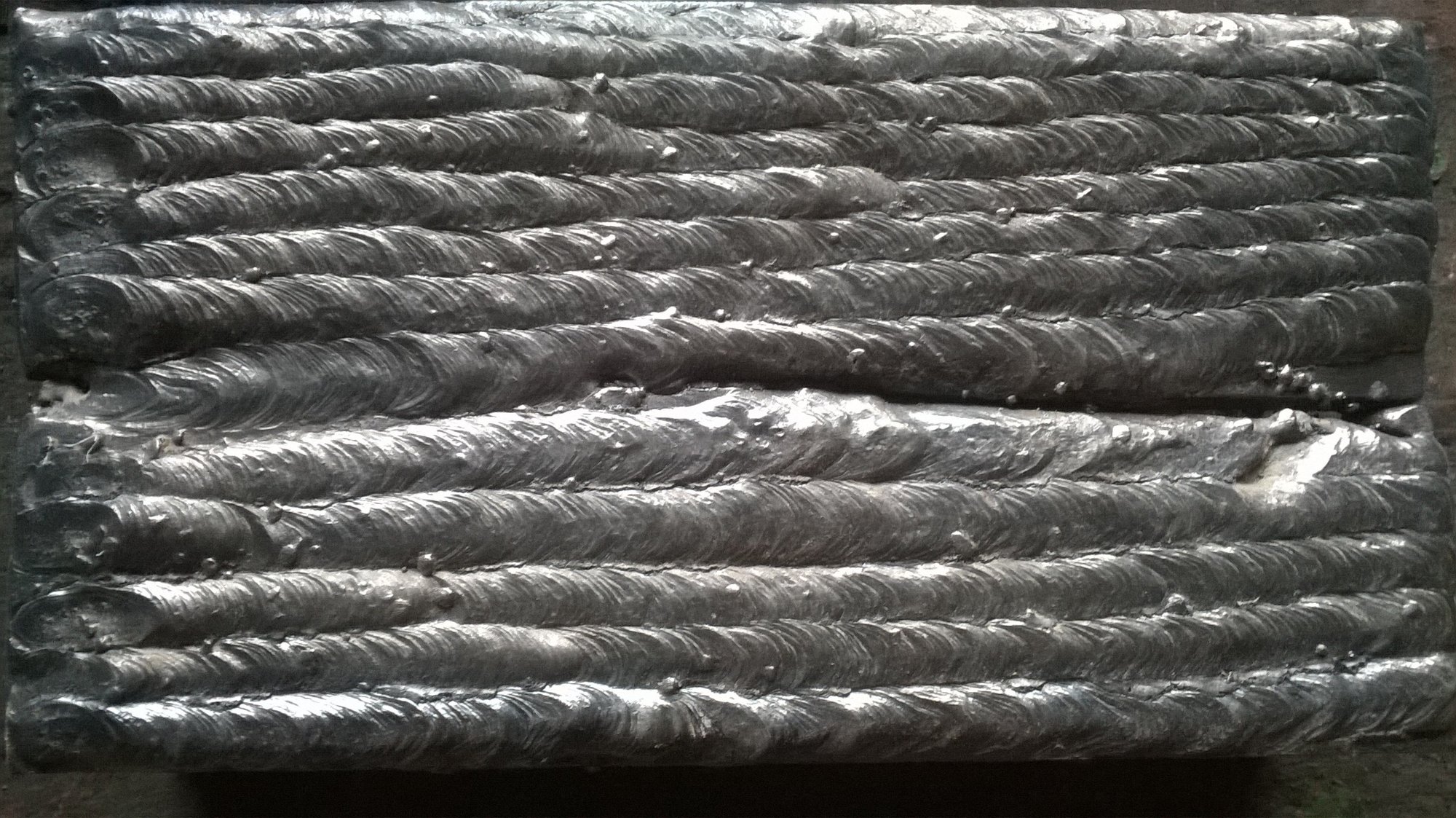

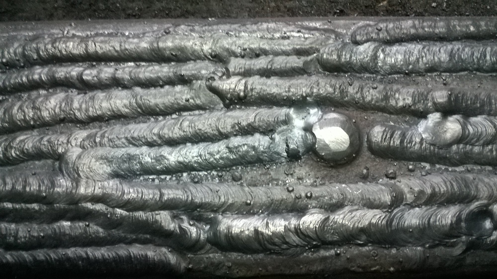

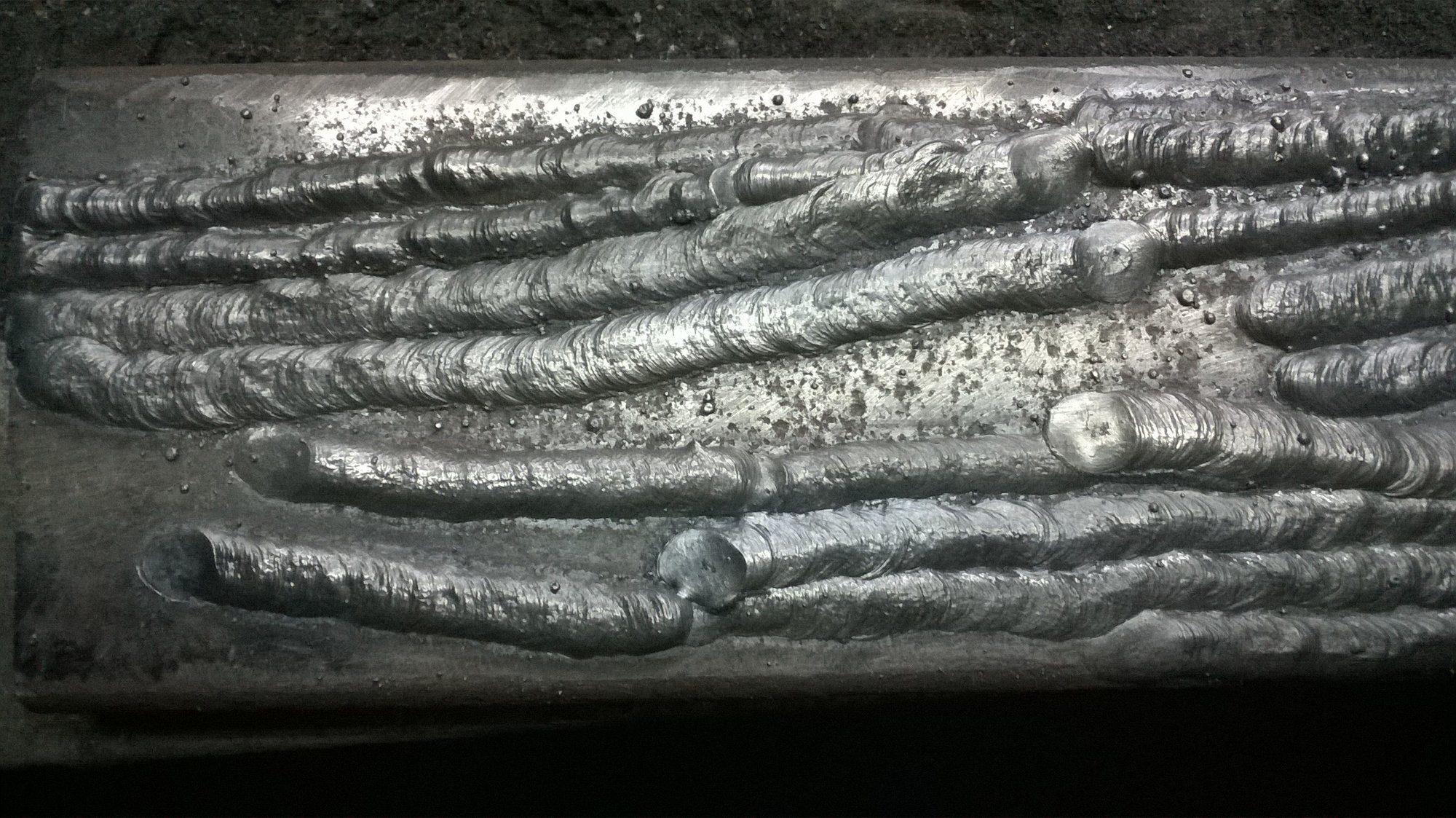

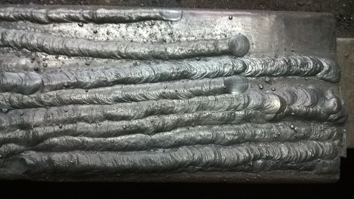

Keep praticing this way
Start welding something together
I have already welded constructions.
I have to learning lead a perfectly straight and uniform beads.
I'm still learning after 7 years of stick weldingI have already welded constructions.
The black glassy slag are a hybrid rutile low hy.....there are a lot of variants between 100% rutile and 100% basic low hydrogen.....the black glassy slag types wont be as low in Hydrogen as the conventional low hys but they will run on lower OCVs etc.
Sometimes just changing the volume of coating on the wire can change the slag and other properties.
