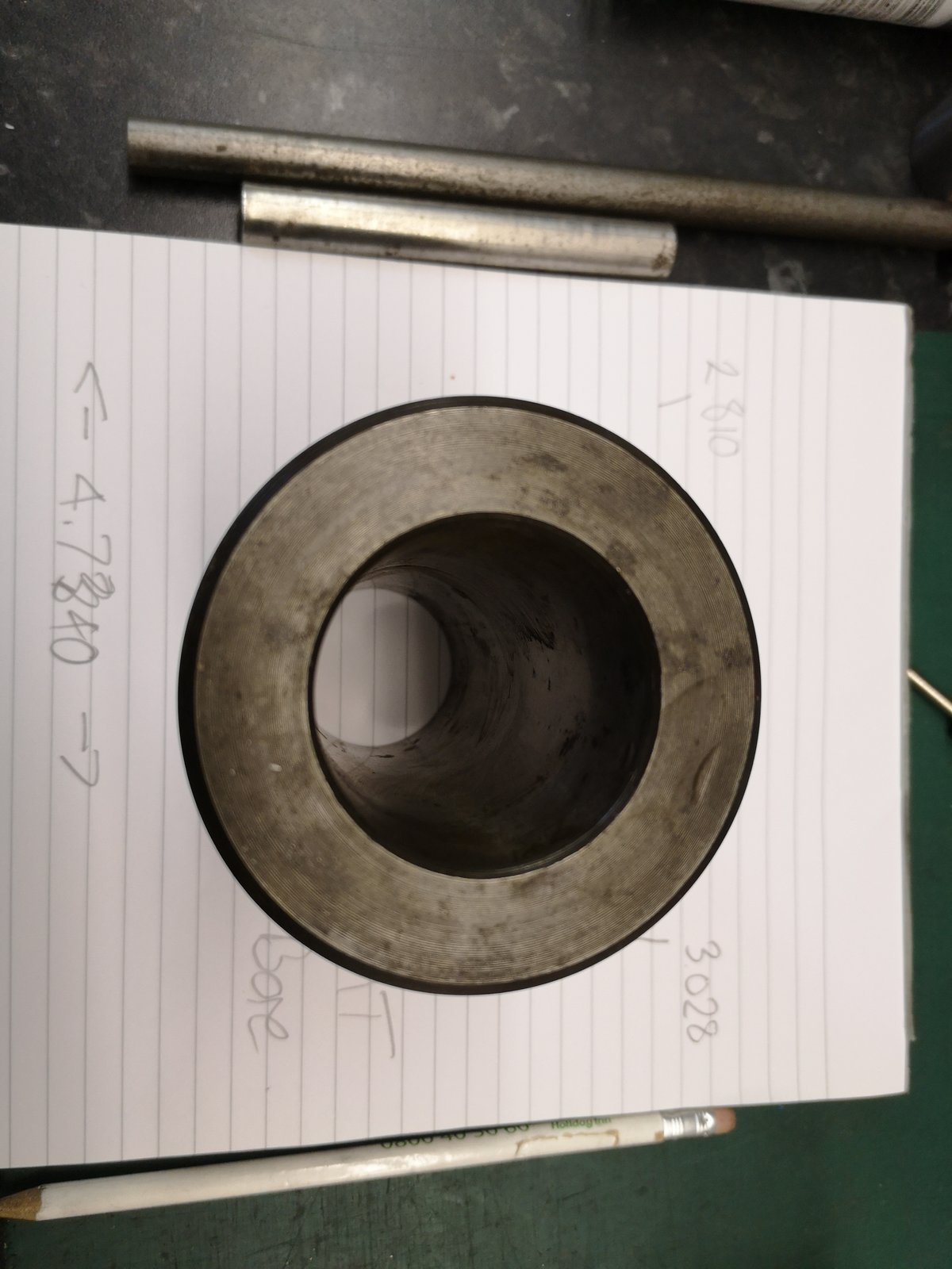

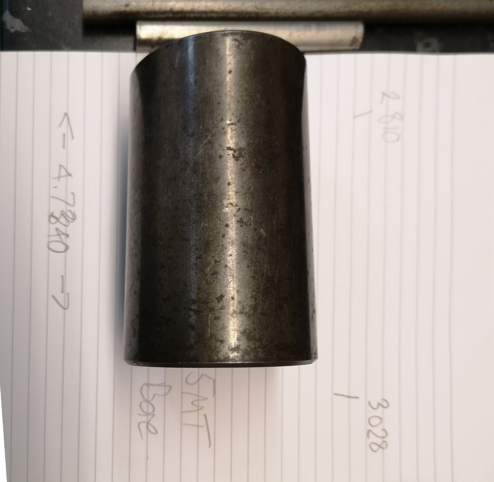

Milkybars Member Messages 1,237 Location Essex Dec 11, 2018 #1 Hello, Fit's nowt I have, looks like a lathe taper adapter and wonder if anyone can identify what machine it's come from or could be used on ?? Internal Bore is 5MT Length is 4.740" Lead Outside Diameter at front 3.028" Outside Diameter at rear 2.810" Philip
rory1 Member Messages 1,167 Location Macclesfield Dec 11, 2018 #2 It’s a spindle bore adaptor for turning between centres
