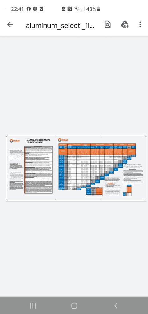

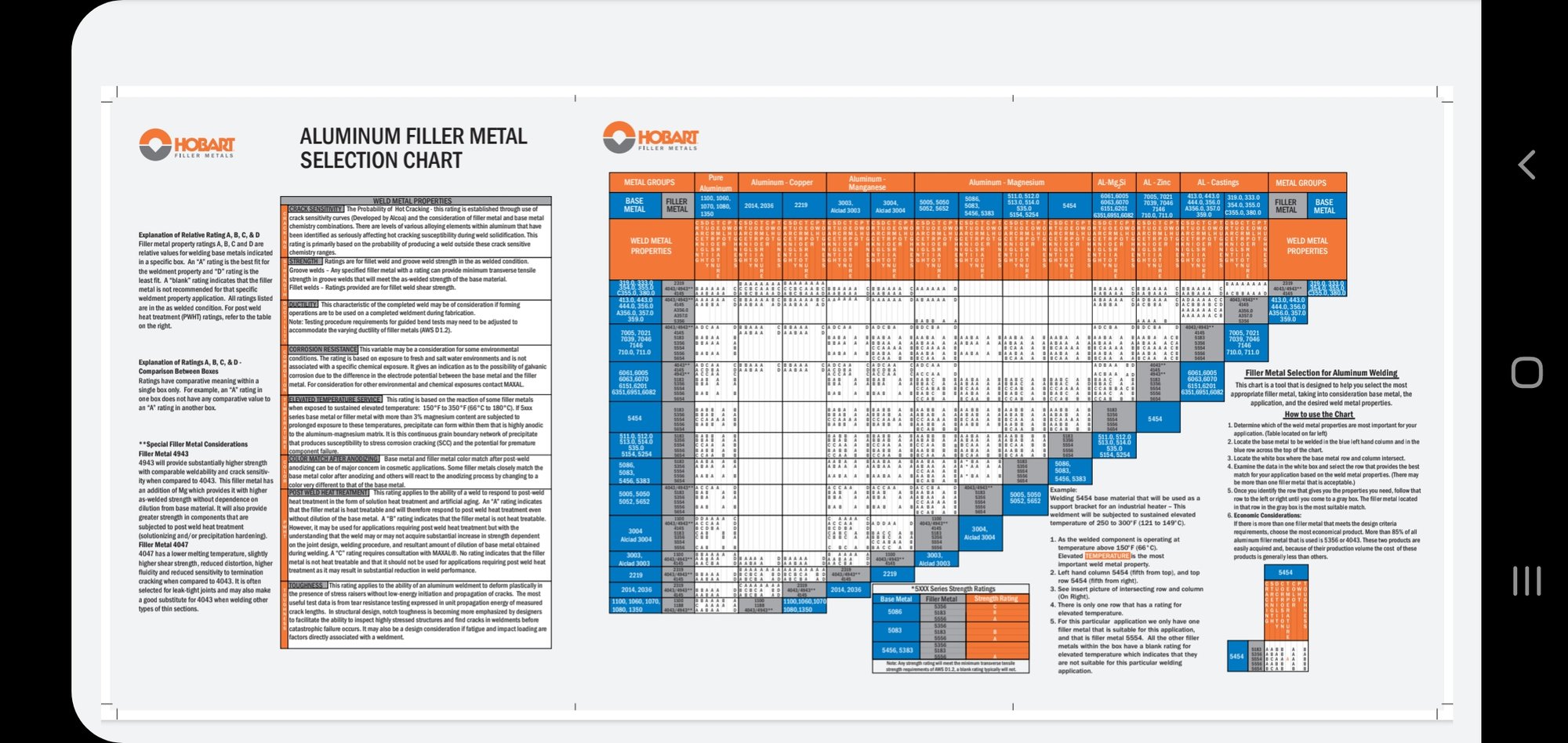

Not knowingly welded 5754 before, I’m in a position of having to choose a filler rod. Materials welded are:
5754 to itself
5754 to 6082
5754 to 6063
6063 to 6082
All on the same part. The part is an engine coolant header tank so will see a sustained elevated temperature.
Going off the charts, the only rod with a temp rating is 5554, but quite sensitive to cracking.
Any thoughts/experience on this?
