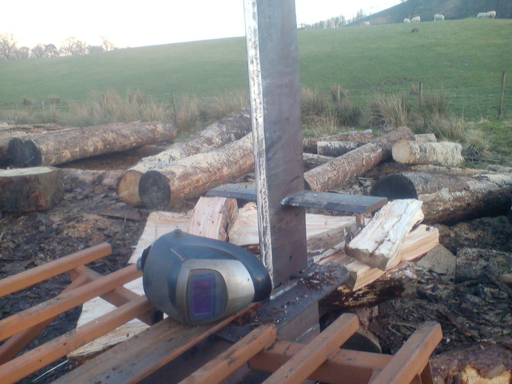

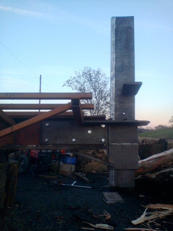

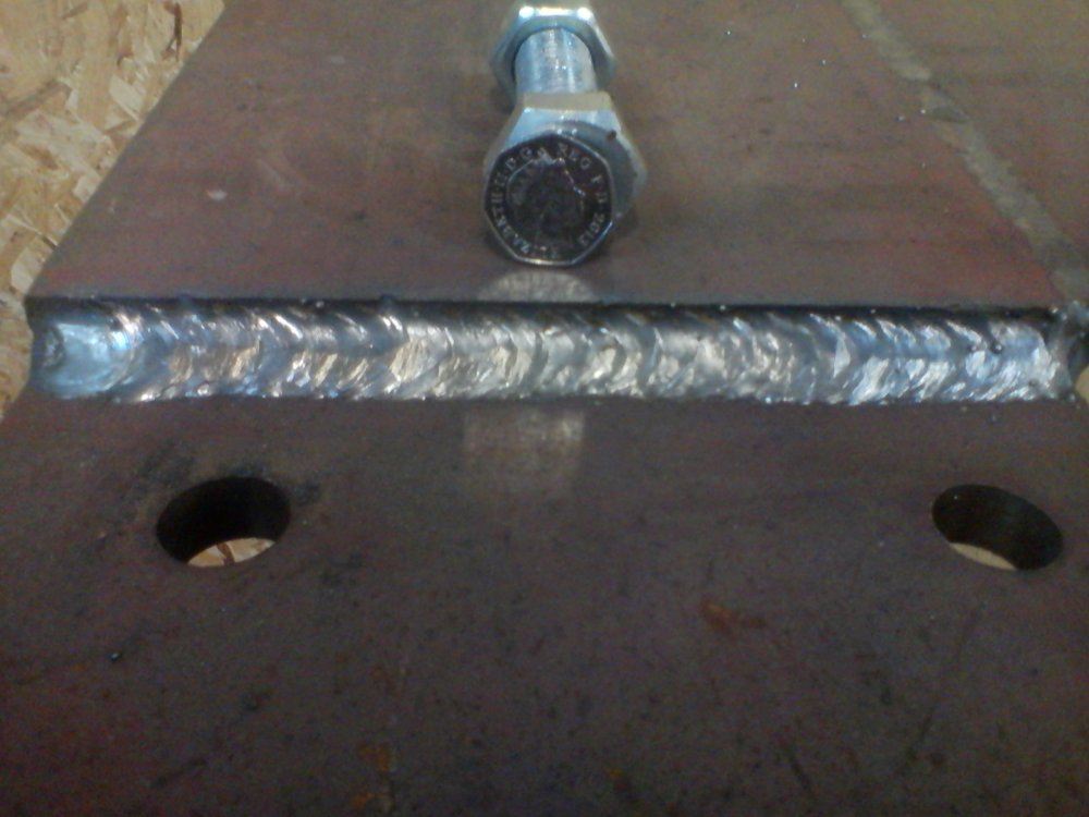

A friend of mine bought a splitter from a certain web-based site. It had all the makings-twin big rams, heavy beam, but the wedge was 25mm thick and welded on by an underpowered machine. Enevitably the 30" wedge snapped off so I made a hollow splitting wedge with adjustable height settings and 2 or 4 way split. Tested it on a really knotty 35" beast(the one that broke the last job.) Passed!
All fabbed in 15mm plate.
